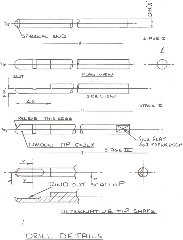

I have access to the wood workshop. So, tapering will not be an issue. Which model will be better:
1. Drilling a fine hole through the wooden tube -> This will result in a small hole and hence the arm wand will be much heavier.
2. Splitting the tube into 2 or more small pieces and creating a cavity (Joining the pieces will give us a round hole)
Also, how can we address the tube resonance ? Do we need to damp the tube using some damping elements like foam or sad or something else ?

What you need is a D-Bit
(from http://www.machineconcepts.co.uk/smallpipes/tools.htm)
![d_drill_drawing.jpg](/community/proxy.php?image=http%3A%2F%2Fwww.machineconcepts.co.uk%2Fsmallpipes%2Fd_drill_drawing.jpg&hash=423bf3486dfeb5d2157c67f0d6379164)
For ease of production: most likely much easier to cut a rebate in 2 halves and then glue together -and the rebate can be sqaure or even just a kerf from a table saw. I have also thought about using a carbon fibre tube up the middle of a wooden tonearm too.
You could drill it out - a long shank drill will probably get you the length required. If you want to go longer distances, the technique is more tricky and really a gun drill is the way to go. That was the only way I could reliably drill a 5mm hole through 360mm of ebony or african black.
The other thing is that I don't think you could go wrong with either ebony or african blackwood. Stable when dry - and you would want to rough turn it first and allow a week or 2 for it to settle. Finishes beautifully too.
Fran

According to the original patent, the tonearm can be made of single piece of wood or a sandwich of several woods. The inner diameter of the cavity is just large enough to take the tonearm wires. It will help in avoiding the tonearm resonance.
I think, we can further address the tube resonance, if any using balsa or chalk powder filling.
