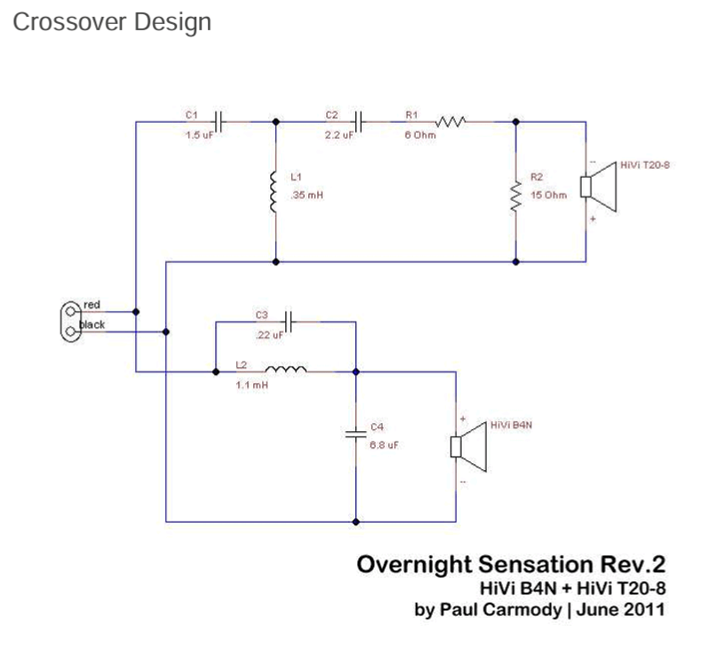

Shall I ask the two main questions again - possibly more succinctly?
1. Does anybody have the circuit diagrams for the Overnight Sensation TM and MTM for the T20 tweeter?
2. What would people suggest as complete and coherent DIY alternatives to an OS / Voxel surround speaker setup?

Here is the MTM schematic... I'll keep looking for the TM...
https://www.diyaudio.com/community/...4-ohm-version-of-hivi-b4n.297411/post-4845262
