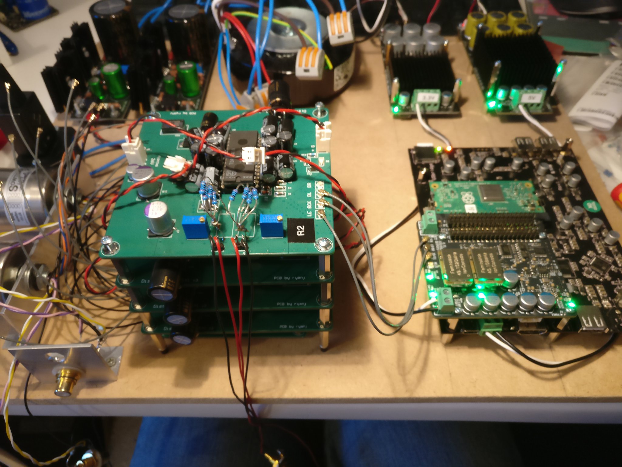

I put together the simultaneous board today and it worked right away! I think DAC has more resolution, but most importantly is sounds more musical. I could not stop listening. Thank you very much again!

Good job.I put together the simultaneous board today and it worked right away! I think DAC has more resolution, but most importantly is sounds more musical. I could not stop listening. Thank you very much again!
Yes I would agree, it contributed to a lower jitter sound from my experience too.

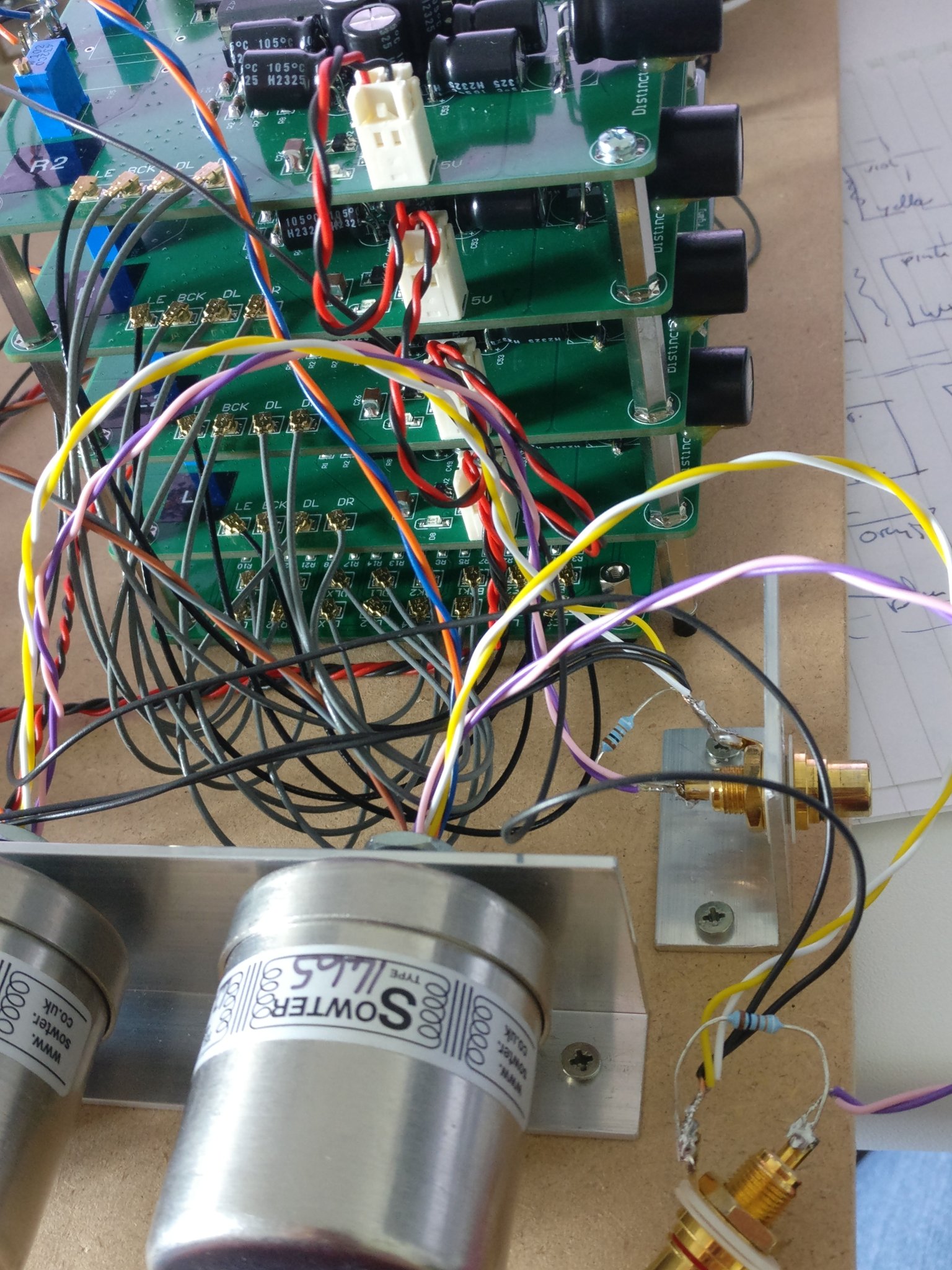

I've been thinking about using 2 x D3 running differential into a 1:1 transformer, which then drives the grid of my tube stage.I am plannig to build a second D3 for differential architecture and looking for suggestions for the IV stage.
The main challenge will be getting a suitable transformer for a good price. Thorsten recommended a microphone transformer for this purpose.
