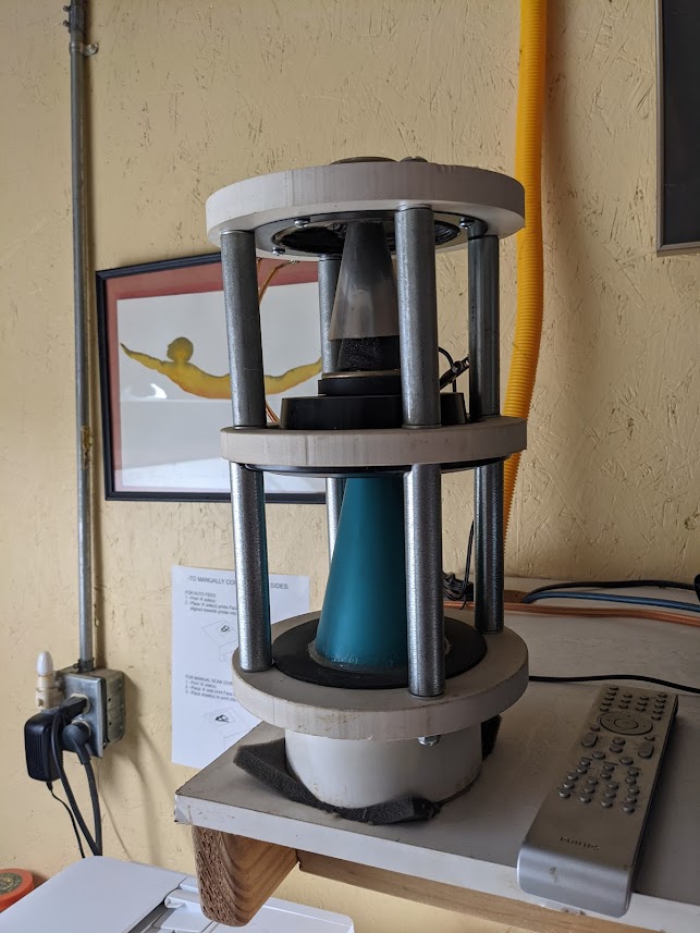

3D model
Hi Thomas,
Thanks, I am about two weeks away from starting the build. I found a local 3D routing service to do my wood work at a reasonable rate and will start at the end of next week to print the Walsh cone. The Walsh cone is a exponential shape 200 mm at the base and 28 mm at the transducer with a 100mm hight. I am printing it with a blend of plastics that gives it a density of human tissue. The reason for this is it gives great impedance matching to the air. Here is a 3D mode.
Steve
Hi Jerry,
I been playing around with some plastics similar to ones that Duke university has developed for their meta-material that the use in their acoustic lab.
I am using PUI Audio ASX0540 HR exciters their diameter is 28mm and a frequency response of ~80Hz-20KHz.
With the PLA fiber with chopped carbon fiber one can print with 0.3mm nozzle that is high wear resistance. I am using a 3D Delta printer with an enclosure.This really helps in warping by having a constant print environment.
I plan to print some wood drivers to along with the carbon fiber The biggest issue is print time Its running close to 16 hrs to print a driver with a 30% infill.
Steve

Interesting choice of cone shape; less the geometric versions i'm doing. More in line with the curves of a 'conventional horn', but rendered as a full radiused version....similar to the 'bell flare' on a brass wind instrument...
It sounds like, from your description, that the drivers are typically for DML applications. First time I've 'heard' of that type used to drive a cone.
Should be interesting to hear when the deed is done. *G*
It also will be educational as to how and what fq. your cones radiate.
And the weight of the cone itself will be of interest....
I received a comment from Dale Harder of HHR that my 5mm cone material was too heavy. Towards that end, now using 2mil Al & Ti.....much more in line with preffered designs vs. weight and mass.
16 hours, huh.? And what seems a lot of infill...but not having all that much experience with 3D printing, it seems somewhat reasonable.
A nearly 8" dia. exponential cone nearly 4" high seems like it might take a while to print. What with a constantly reducing diameter to process and all the infill supports the program tacked on...
We're all ears on your endeavour....👍😃
Good luck with the 'horny cone'...(I know....hideous pun....)

H Jerryrigged,
I was disappointed in the results of the 3D printed cones and of the DML groupies they keep chasing their tails and not paying attention to the physics but enough said about that...
