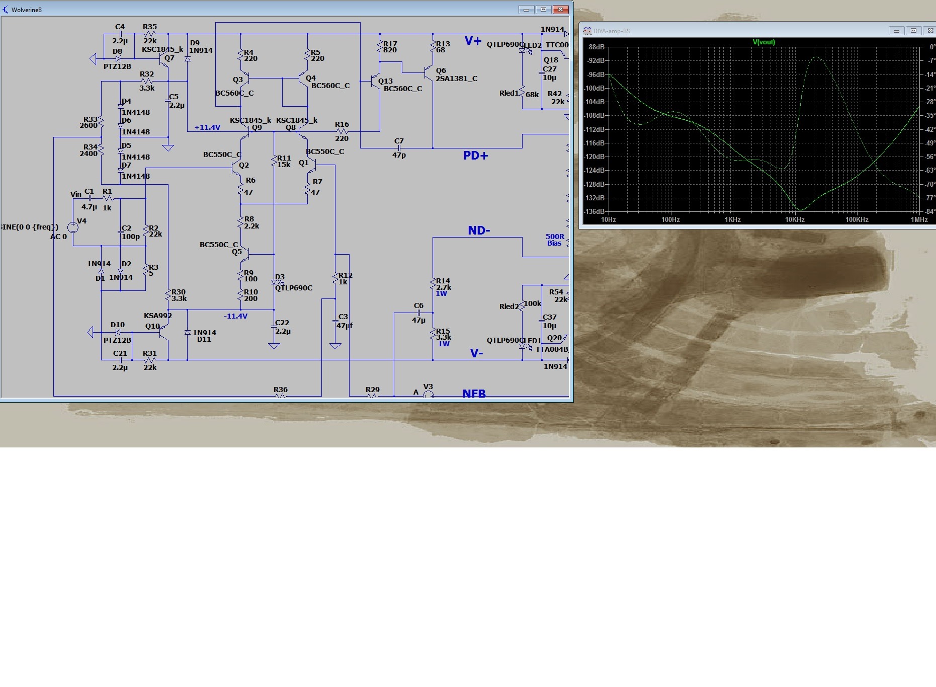

Here is a different approach....
A simpler Wolverine with regulated Cascode , CCS , and Beta device can get Spooky PSRR and wolverine THD WITHOUT
TMC.
Damn , I'm even just using a LED CCS and a Bootstrapped VAS. Still can get 1 PPM with a single 47pF miller.
20hz PSRR drops by almost 30dB , as well.
I also might just figure out how to apply a VCCS (voltage controlled current source) and servo this , as well. he he !!
With the full wolverine TMC NFB and both CCS's , I should be able to beat the wolverine by a large margin.
The caps (multipliers) are not as much of a factor with PSRR , ripple rejection mostly is a feedback mechanism.
OS
