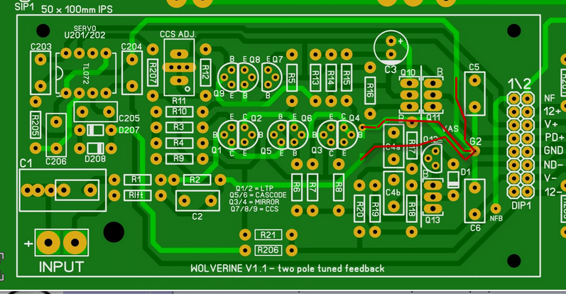

(Below) is the current 4'th final ... haha ! PCB.
I was thinking that one could have the onboard wolverine fully populated ,
have enough clearance to just plug in a Spooky or whatever right on top.
Either a standalone project (wolverine) with modular capability OR just
a OPS/regulator "devious playground" for IPS's.

Hi OS, Is there any chance that you can change the Faston connector macro to this one. It supports both the Faston connector and a single terminal screw.
I personally find the single terminal screw is a more positive and secure connection.
I've included the sprint layout macro in the attached zip file.
What about fuses, I don't see any rail fuses. These may work?
732-11372-ND‎
732-11378-ND‎

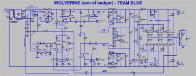

I also made a small trace modification suggestion to try and keep the input ground trace a clean as possible. By making this modification it will keep the return currents from R15 away from the input ground trace.
Is it possible to label the schematic shown in your first post with the corresponding ground points. This will save the confusion that went on in the HB thread.
Eg... G1, G2 etc...
Should the ground that R102 and R103 are connected to be labeled G3?
What about Test points for Bias etc?
I don't see RLift on the schematic

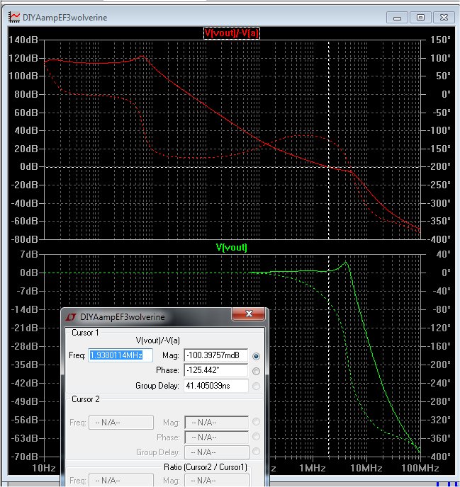

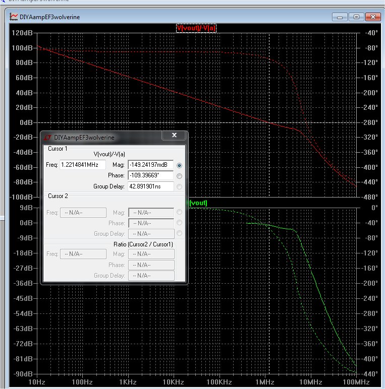

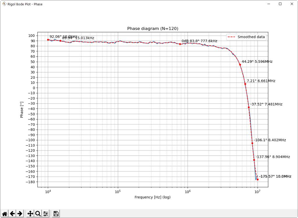

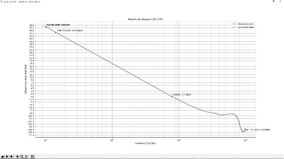

At what fc frequencies do you set your input filters at?
Isn't the FC frequency and the input filter a completely separate thing.
The HB low pass filter is about 720khz
This SOB looks to be about 2Mhz
The stock FC frequency (unity gain crossover frequency) of the HB measured 780Khz without the C2 capacitor in place.
I also added the bode plots showing the frequency response with C2 in place.
View attachment 938434Screenshot_20210403-090634_Electronics%20Calculator%20Pro.jpg2087641555.jpg898241782.jpg
View attachment 938445View attachment 938446
1. What about fuses, I don't see any rail fuses.
2. I also made a small trace modification suggestion to try and keep the input ground trace a clean as possible. By making this modification it will keep the return currents from R15 away from the input ground trace.
3. Is it possible to label the schematic shown in your first post with the corresponding ground points. This will save the confusion that went on in the HB thread.
Eg... G1, G2 etc...
4. Should the ground that R102 and R103 are connected to be labeled G3?
5. What about Test points for Bias etc?
6. I don't see RLift on the schematic
1 . I think these are better left to the chassis or power supply cap board. Some might want MOSFET rail protectors (21st century).
2. Good call - done ! R15/R17 do not really contribute substantial return currents. But , why not.
3/4 . G1 is the main "dirty star". G2 at the regulators is still slightly "dirty",
return currents of C102/3 , C106/7 are there , 20db down from G1.
G2 on the IPS IS correct , it is on the same star as the OPS G2.
5. SIP 1 allows testing of the first P/N pair's Re. Also allows hookup of
overload monitoring. DC could also be detected there.
6. I'm still waiting for Thimios's report on Spooky servo behavior in regards
to what IPS ground references get lifted.
Thanks for those connector pads.
OS

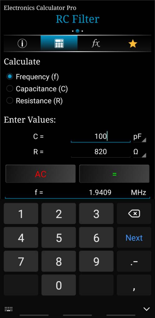

R2=27k C2=100pF so , fc= 1/(2 pi RC) So .....it's a 58.97Khz /-3db 1st order
filter.
The amp itself (you are spot on) WITH two pole is 1.93 Mhz ! (below 1).
If I build mine , I will go with just normal 68pF miller comp. (below 2).
Still , 1.2Mhz ... but I like the phase margin.
The extra 20db gain at LF with TMC halves THD.
Ahh , I know where I got that 150Khz figure 22k/47pf = 153Khz
That is what is on some of my early sims.
OS

I will try to recall this old story. 🙂
filter.
OS
Its R1/C2 not R2/C2, this gives a high fc, so was just wandering if its intentional.
I use fc as a generic term for -3dB cut off frequency of the filter.
Regards

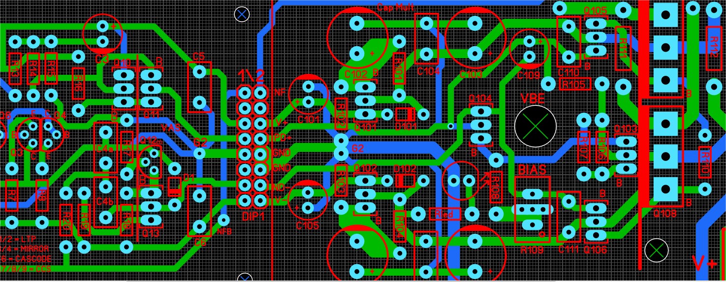

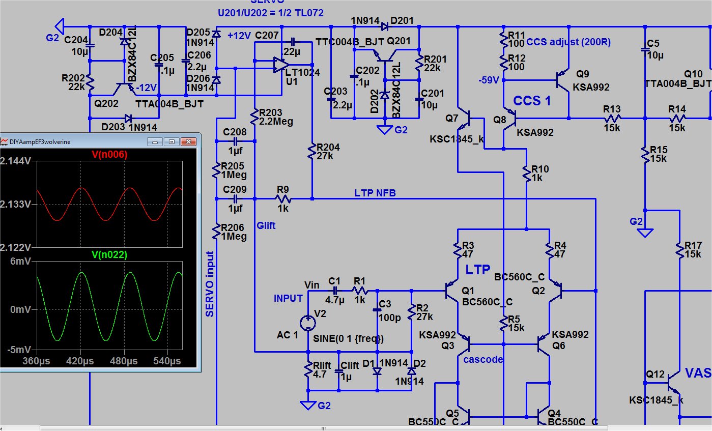

After reviewing Thimios's Spooky tests , a hundred servo diagrams and
Elliot sound on servo articles .....
1. Redesigned the interface.(below).
Still the 2 X 8pin (NFB/blank/V+/PD+/grd/grd/ND-/V-).
Board can be 80 X50mm OR 120 X 50mm .... more "DEVIANT playground".
2. Regulators are near the servo now , where they should be.
3. Input/NFB and servo to common lifted ground.
Safety diodes (D205/206) on servo are rail shorting now , input safety diodes are
ground based. Rlift should be a fusible 2.2 - 4.7R device.
4. Redesigned the Servo (below 2). Just a single op-amp is used for lower
noise. Second order 1.6hZ filter. Just 2-5mV ripple 15hZ to 20KhZ.
2'nd order filter (R205/6 , C207/8) cuts degenerative FB from the servo
X 10+. I just lose 1-2ppm from 15hZ to 20KhZ.
I compared the servo'ed amp with a standard DC blocking cap.
Servo = 2-5 PPM across the range.
A faster op-amp for the servo has less phase shift and will actually increase
performance.
Cap - is funny .... higher 20hZ 30-50ppm ,
then sub ppm .00008% 1-10khZ ,
and the normal 5 PPM at 20K.
I will offer the standard DC cap (+ offset trimmer) as a build option
in the layout.
OS
