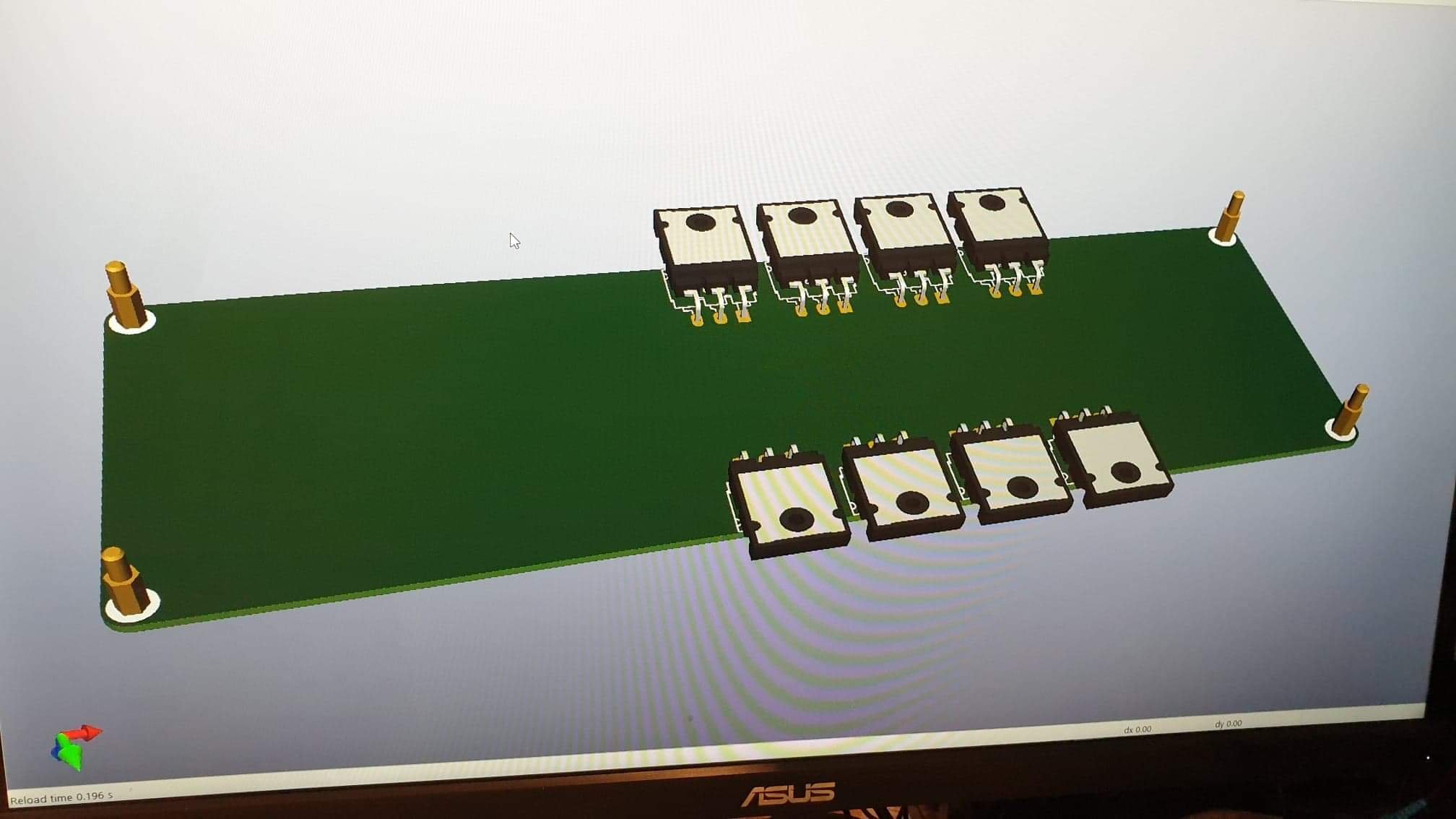

I export to STEP and import into CAD, Im using Autodesk inventor, but Fushion 360 is about the same.
Ive attached a STEP exported from KiCad so you can import into Fusion to see for yourself.

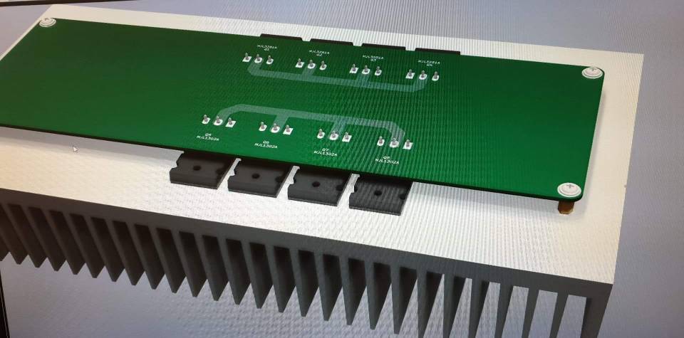

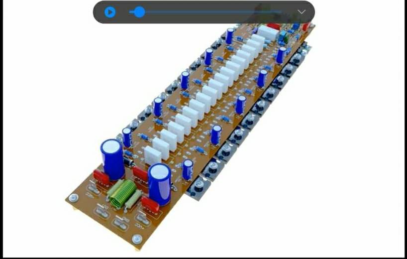

I just through some transistors on a heatsink so you can see how nice it looks. I got the inspiration to use Kicad from the last model.

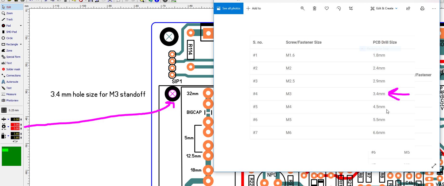

![Screenshot_20210415-054629_Messenger.jpg Screenshot_20210415-054629_Messenger.jpg](https://www.diyaudio.com/community/data/attachments/851/851977-2503b3f623f830d378c9c003d6448f0f.jpg)

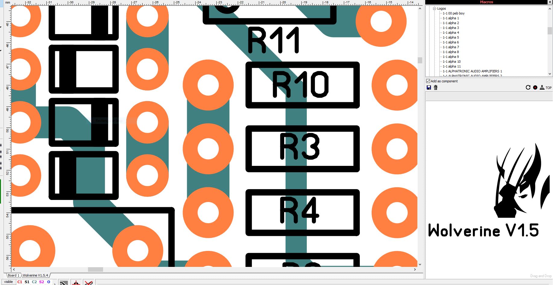

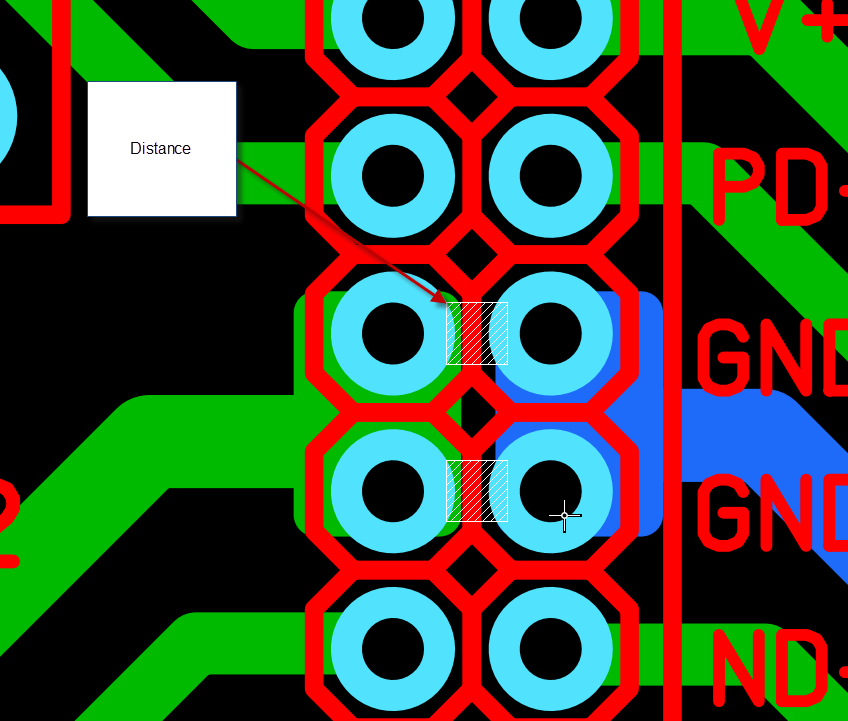

(Below) perfect fit now. Row 2 !! of DIP1 is where it goes. Macro'ed "standard"
holes line up perfect.

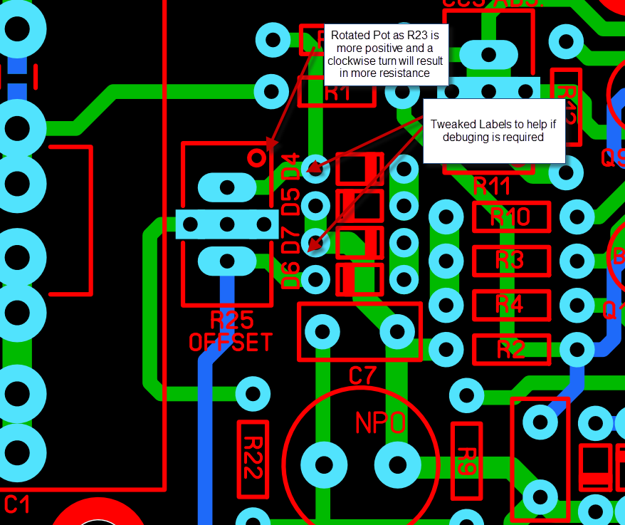

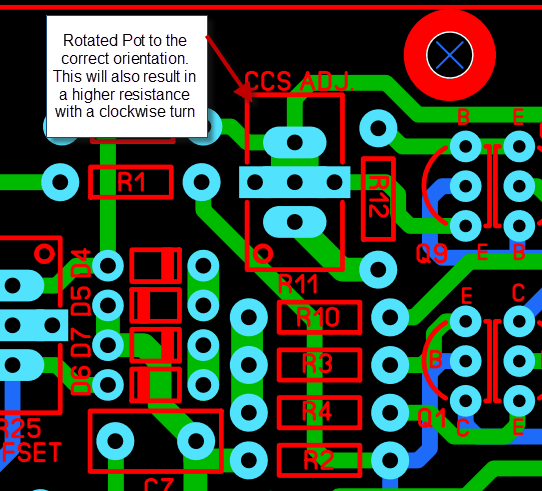

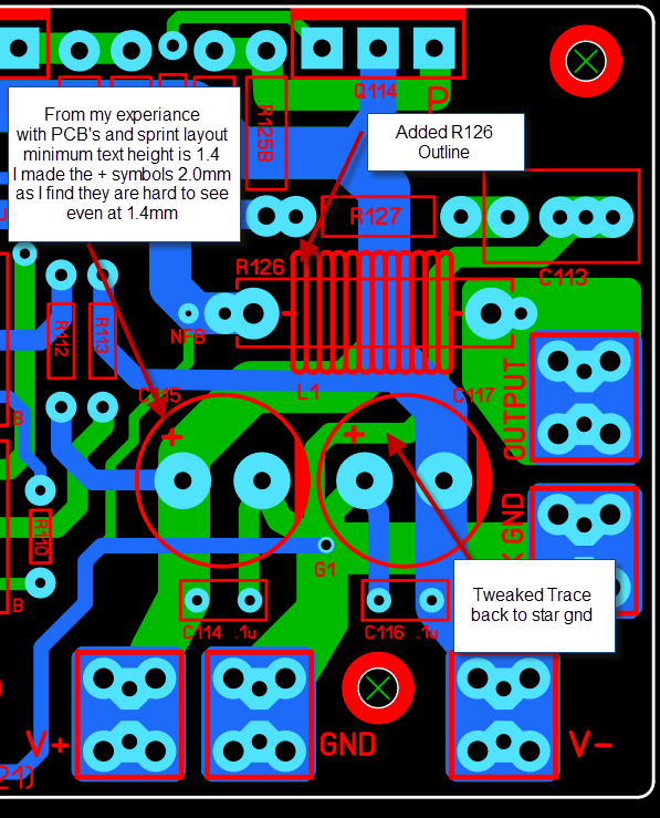

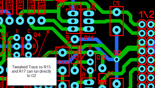

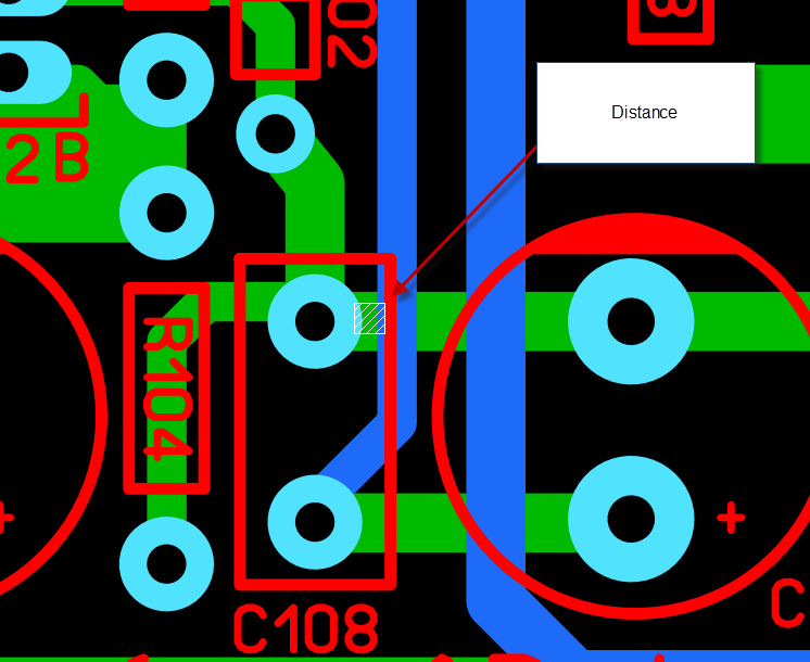

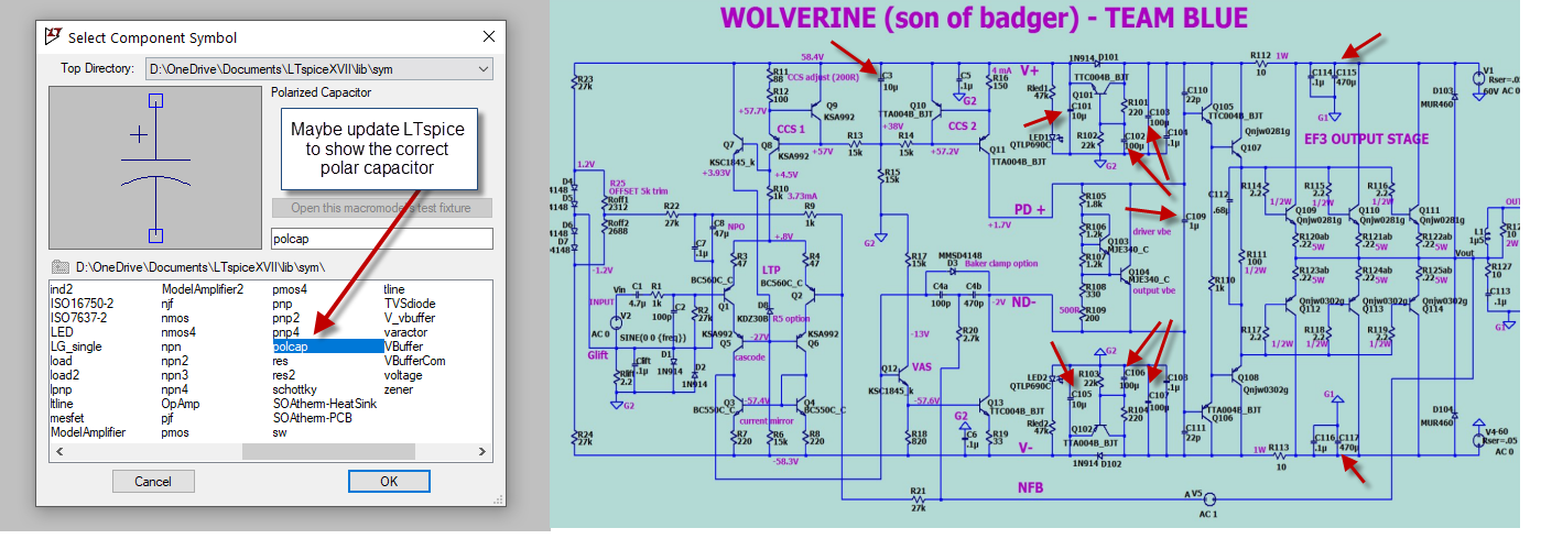

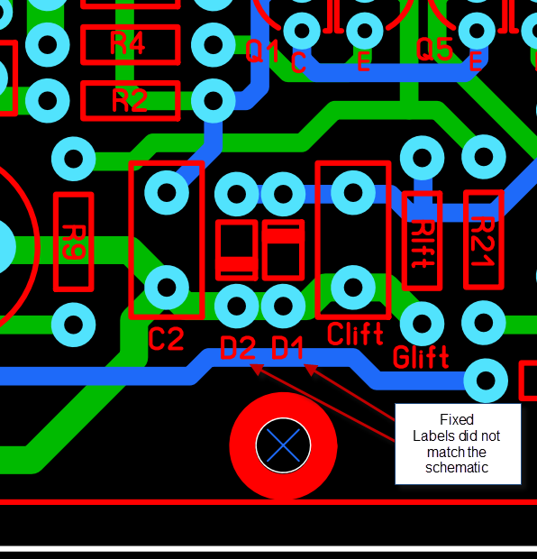

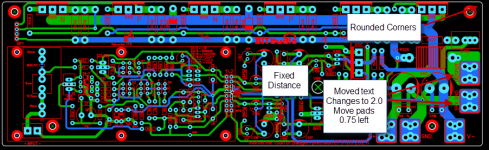

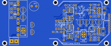

Hi OS,
I have found some time and started giving the board a close check.
I must say that you have done a great job to keep it so compact.
Amazing really impressed.
![cheers :cheers: :cheers:](https://files.diyaudio.com/forums/images/smilies/cheers.gif)
Keeping track of all the different small signal transistor pinout's takes a lot of concentration.
I have found a few small things which I have listed in the image notes.
I will keep going tomorrow night.

Hi OS,
Amazing really impressed.![]()

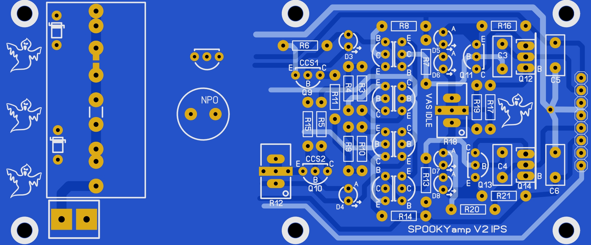

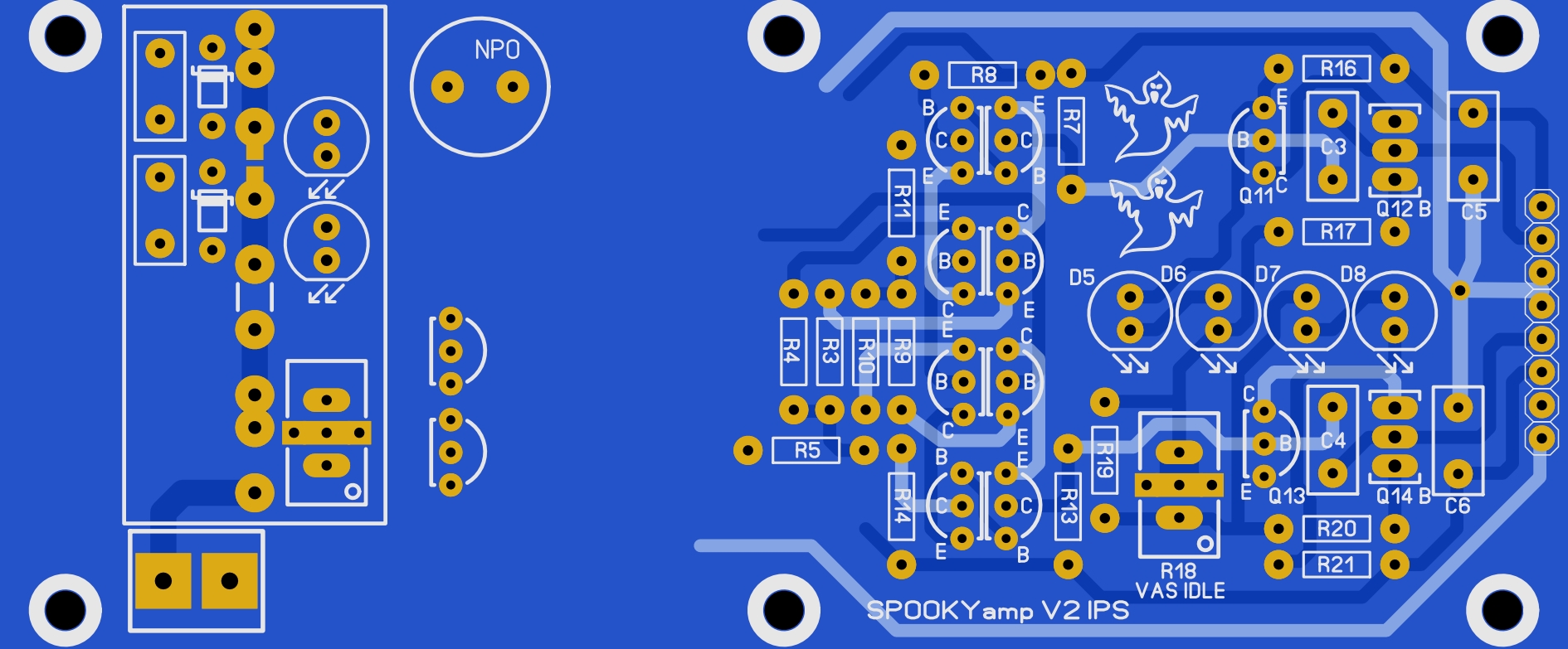

All this present stuff actually has it's roots in Jkuetemann's original layout of
my present "spooky amp".
JK's layout style was DEFINITE inspiration. When I saw that one ,
I stared in wonder !!!
On this one , I ditched the Servo but added the full Zener pass regs. and
the DC blocking cap.
Just as freakin' hair - pulling HARD !! (below).
Wolverine was easier. But , a good intro.

This Spooky has the careful design considerations after reading Thimios's
detailed dissemination of the minor flaws.
Core "Spooky goodness" with LED based Hawksford cascode/LTP CCS's
are preserved. Simulation shows that good balance (H2/3) that decays quickly.
Pass regs. improve PSRR 20db. No hot Zener/resistors ... 15mA (per rail) coolness.
No servo is not a downfall. This exceeds the original simulations in EVERY way.
Builders will have to watch what Vf the CCS leds have - 1.7V is target , a
2.0V LED can be used with R6=430R and a 1K trimmer for R12.
Hawksford cascode LED's don't matter ,just lose a volt at clipping.
OS

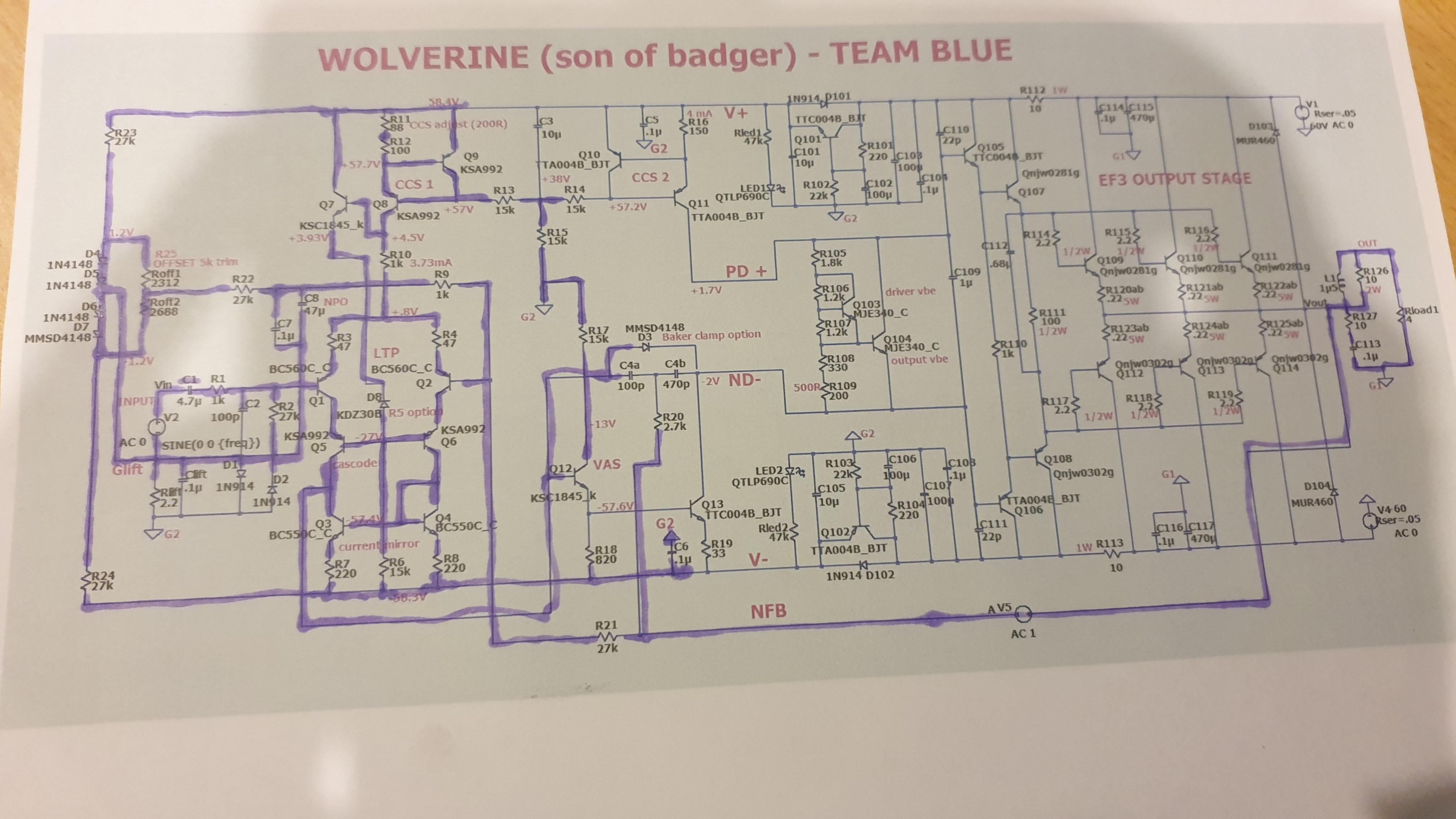

- DIYA store "Wolverine" (Son of Badger) .... suggestions ??
