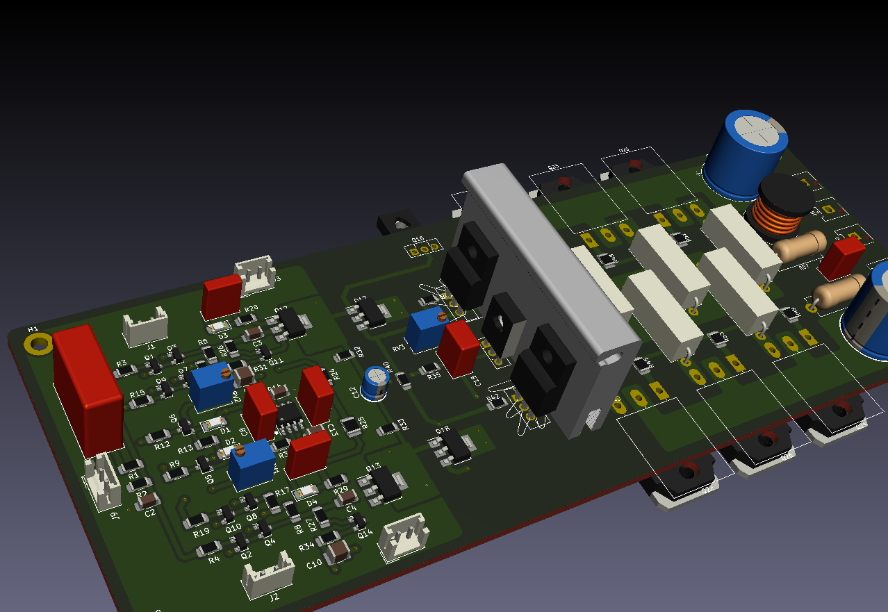

It's not all doom and gloom and most of the transistors in through hole are available in smd. I guess what makes it a little easier is we can design two versions of the same amplifier with a little help from our CAD software and other forum members who can contribute to a smd version. It gives everyone an option and it future-proofs the design to some extent.
As an example I took your spooky amp and mashed it together with slewmaster and turned it into a mostly smd design (its still a work in progress).

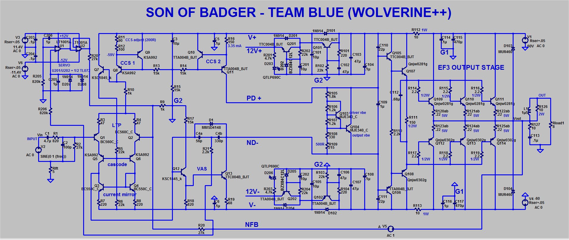

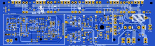

And JW , I found many errors too.
New ones. (below).
Full EBC for Q1/2 /3/4. .lay and pictures. Re-did a lot of it.
PS - the schema is redrawn. Vregs/OPS are unified now. Servo and vregs
still have 2xx numbering.
OS

Q8 emitter is connected to the base of Q7, should be collector.
This manual checking is hard on the brain!
Great exercise ... aye.
