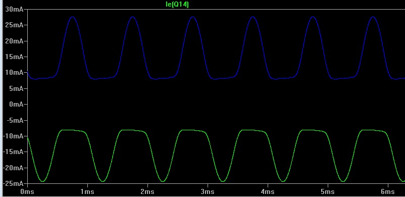

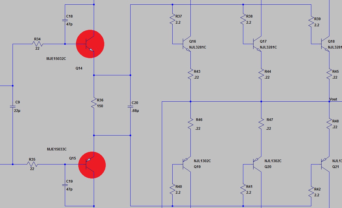

I was playing around in LTspice earlier and was wondering if somebody could explain why Ie - Q14 and Ie -Q15 are set up to have a "gap" going into the OPS. I would have guessed that they would cross over each other if I hadn't used spice to see this.
Thanks for any clarification.
Tim

The drivers are running class A. The "gap" is the driver not turning off.
