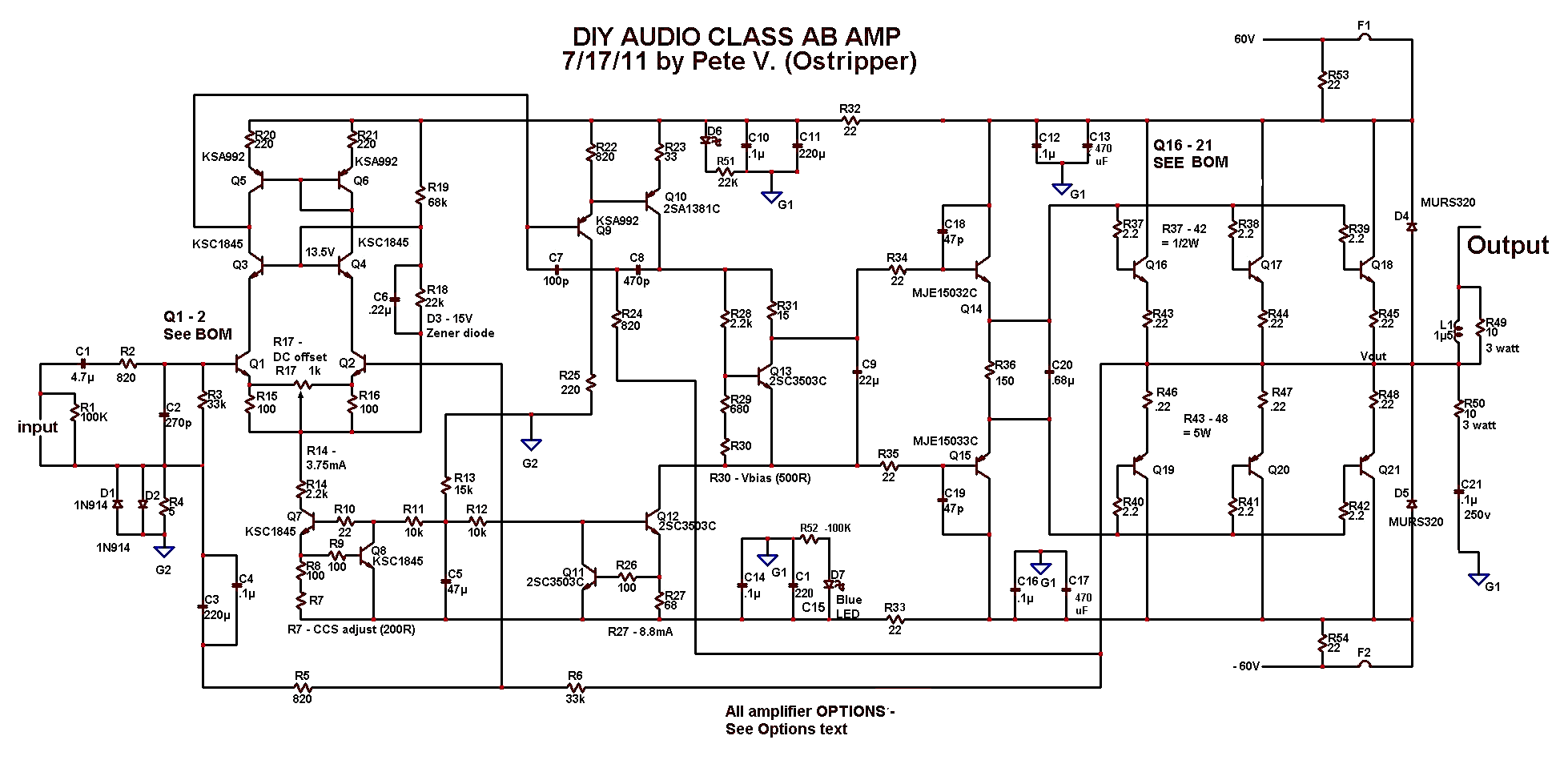

I did that last week.If I remember correctly, Os had shown a way to power up the board without output transistors. Dont remember the details or post exactly.
would that be a safe way to power up without blowing o/p transistors or to find errors?
I installed everything up to the drivers including the driver emitter resistor.
I added in two 1k0 resistor from the respective driver emitters to the output line. These two resistors feed a split signal back through the NFB route to the -IN node.
I expected that to allow the amp to settle.
It did not work as I expected.
In the end I had to bite the bullet and install one pair of outputs, turn down the Vbe multiplier (set VR to maxium resistance) and power up via a current limited lab supply.
That worked, even though I had forgotten to remove the two temporary 1k0 resistors.
Removed them and re-checked voltages.
Today I finally powered up the whole amplifier to +-58Vdc with the Bulb Tester as my only protection. Blew the 5A fuse when I bypassed the Bulb Tester. It's currently running on a 10A mains fuse until I add in a soft starter. It will run on a T4A with the soft start installed.
The offset VR corrupts the balance of the LTP. Remove it.I already had it powered with output stage and working OK only at lower voltage (25vdc). So no errors in assembly to look for. It was higher voltage that blew outputs.
I am ordering a new pair of (hopefully now original) MJE15032/MJE15033 to verify that the fake drives were the culprit.
I also noticed that the variable offset resistor can give spikes of offset current when used with amp running. From now on I will be making offset changes only in powered off state.
Rely on balance of the LTP, resistors and CCS to give good/excellent balance of LTP currents (I have 201mV and 202mV across the two 100ohm LTP degeneration resistors at present - 0.2mV difference across the LTP emitters).

Hi HI-FI PRO,
For adjustments, you should be using a single turn control. If you must restrict the range of authority, use fixed resistors to restrict the range. Multi-turn controls are not designed to pass current through the wiper! They are for potentiometer use only. So called "cheap" single turn controls are anything but, and most have enough wiper contact to pass modest amounts of current.
As for DC offset, Andrew is quite correct. The match on your diff pair and degeneration resistors (general case here) should be sufficient to keep DC offset voltages low enough to be of no concern. Throwing the diff pair balance off to correct DC offset is not the right way to do things. That's assuming that the design of the amplifier wants to sit midpoint (near audio common) rather than one supply rail or the other.

Show me a precision adjustment in an amplifier!
Sorry but I cannot go into detail about that, becasue that would mean going into my amplifier design principles and introduce competetors if I decide to sell amps.
Then you have designed the circuit incorrectly. Normally when a bias control goes open, current falls to a minimum, or zero depending on the circuit. It is possible to design a bias circuit that failure of the control causes maximum current flow. Several designers have made this basic error.
I don't use vbe multipliers in my amp designs to bias, sometimes in other applications theres no way you can make it so it can open circuit and still be fine.
Potentiometers conduct uA or nA in operation. Never even 1 mA.
With refrence to amp schematic, you see it says 3.75mA accross r14. Collector current of q7 is also approx equal to emitter current of q7. And current law, sum of currents entering equal to leaving. That means 3.75mA is passed through r7 ccs adjust 200r.

With refrence to amp schematic, you see it says 3.75mA accross r14. Collector current of q7 is also approx equal to emitter current of q7. And current law, sum of currents entering equal to leaving. That means 3.75mA is passed through r7 ccs adjust 200r.Potentiometers conduct uA or nA in operation. Never even 1 mA.

The current through r17 dc off set trimmer is not 3.75mA. To annalyse this we would assume pot is centered and 500ohms both side.
Effectivly there are two 100ohms parallel with the 500ohms going to each side of transistor.
we also assume transitor of diffrential pair share load equaly, meaning q1 has 1.875mA accross it (3.75/2)
This also means 1.875mA is accross r15(100ohm)parallel with r17(500ohm).
You can calculate current divider or method you know.
(100/600)(1.875) = 0.31125mA accross r17 when it is centered (500ohm both side pot).

Replacing the driver pair MJE15032/MJE15033 with original parts didn't make much difference. Q20 overheated and blew F2. I noticed that unlike other power stage transistors Q20 started heating up quite early, even at idle. It blew shortly after I added 6Ohm load. Other power transistors were cool, with maybe exception of Q21 which was luke-worm.
Not sure what the next step should be. Replace just Q20 with a new part and see if it acts the same, or if a difference transistor overheats now? Replace all power transistors (I currently use NJW0281 / NJW0302) with something different to see if that makes a difference?
Possibly q20 was leaky and damaged from previous tests. Power up the amp with just one pair of outputs and test(you can use any cheap transistors to test, just make sure voltage rating is at least 120v). Put some music on mid low level of volumes too, if it works then should be good, go to 3 pairs of outputs
