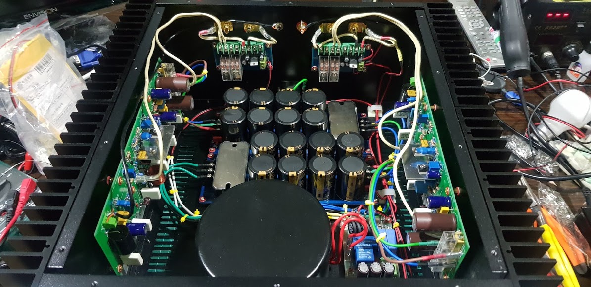

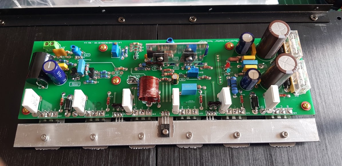

I'm testing 1 channel of the HB amp. Here are the settings of the trimmers.
All transistors have been installed. I am using the lightbulb approach to limit the current. I've adjusted the R30 until i got around 20mV on TP1 and TP2.
Can I connect a speaker directly to test it out? I have a pre-amplifier which can be attached to the input, connected to a DAC and Chromecast Audio as source.

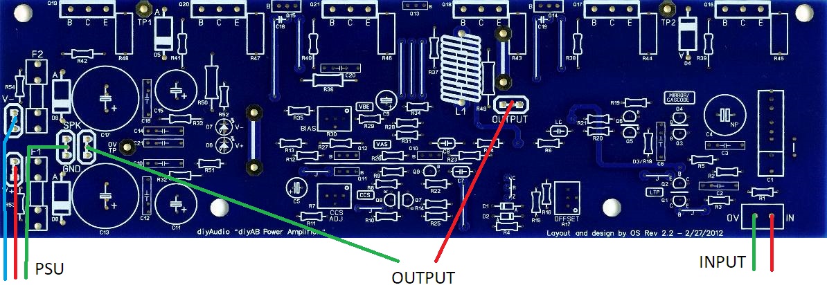

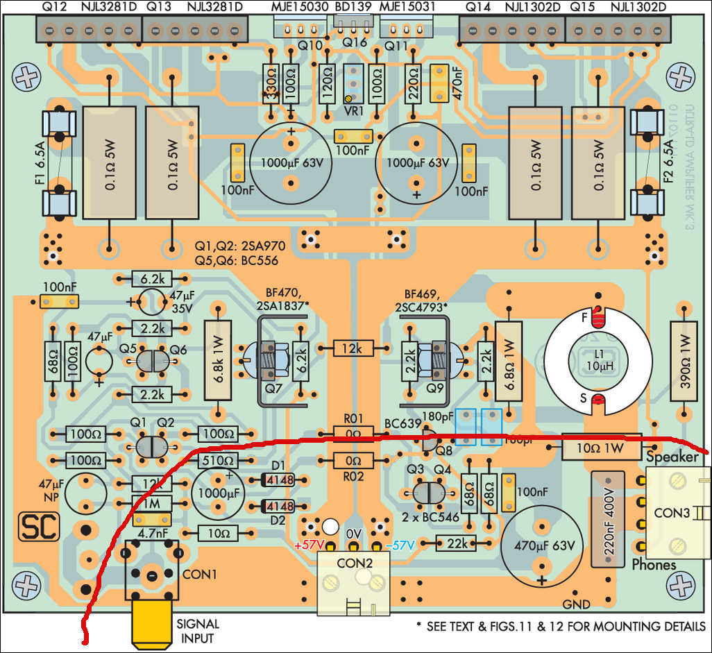

The signal ground should be returned to the load ground and then to the local PCB star ground. Please observe the attachment which shows a PCB of a measured (THD <0.004%) low distortion amplifier. Note that the signal ground on the left meets the speaker (load) ground in the very center of the board and then only returned to the local star ground on the bottom of the board.
Professional PCB designers never return the signal and load grounds to different locations as this will easily lead to more distortion and noise due to error voltages developing.
On a side note the V+ and V- traces are right next to each other to reduce loop area mediated distortion. The loop area vectors mediated by the Upper (V+ related) and lower (V- related) portions of the LTP and VAS too cancel each other out too. This is a good PCB design.

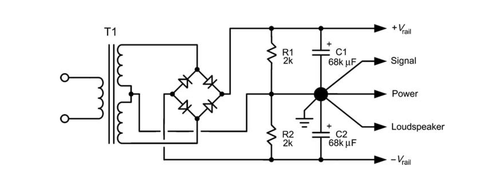

Hi guys,

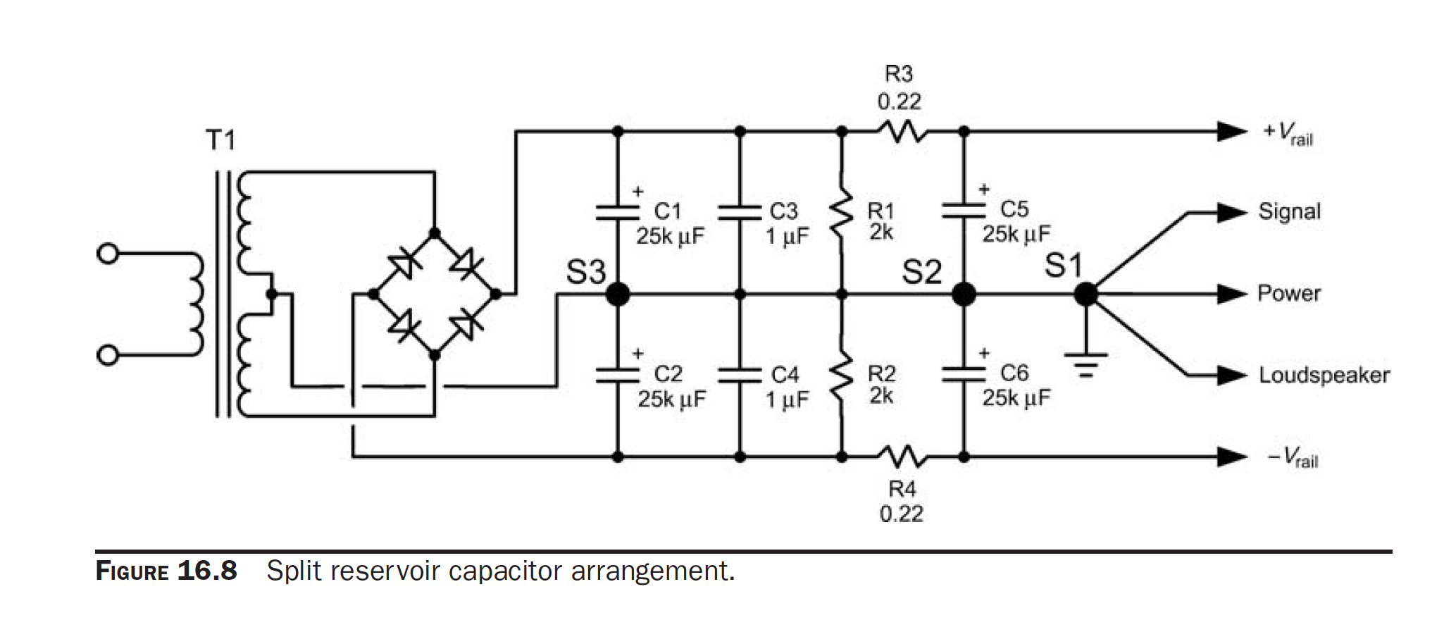

I'm also confused about the correct grounding layout for the HB.
Having a look at Bob Cordells Star on Star diagram 16.8
Would it be correct to do the following:
Speaker return to amp board
Signal return to amp board
Capacitor midpoint on power supply to amp board ground point
Then connect TP0 on amp board to safety earth.
This configuration would follow Bobs 16.8 diagram the best and be a star on star ground.
It seems most advice so far to approximates Bobs 16.1 diagram
i.e.
Make power supply capacitor junction the star ground point and connect everything to it including safety ground. No one seems to connect signal return directly to power supply star ground. Instead signal return goes back to the amp board and then would eventually connect via the power supply ground and about 5 ohms of resistance through the pcb.
Firstly am I on the right track, does my interpretation of 16.8 make sense?
Why doesn't anyone recommend returning signal return to all the way to the power supply? This would match the 16.1 diagram best.
Which is better out of the two options described?
Is there a good image of the chassis ground wiring that I can just follow so i can finish the amp.....

i.e.

Bob Cordell talks about this a lot in his book designing audio power amplifiers. I have copied the image below from his book, i hope he does not mind it as it is to show the method.

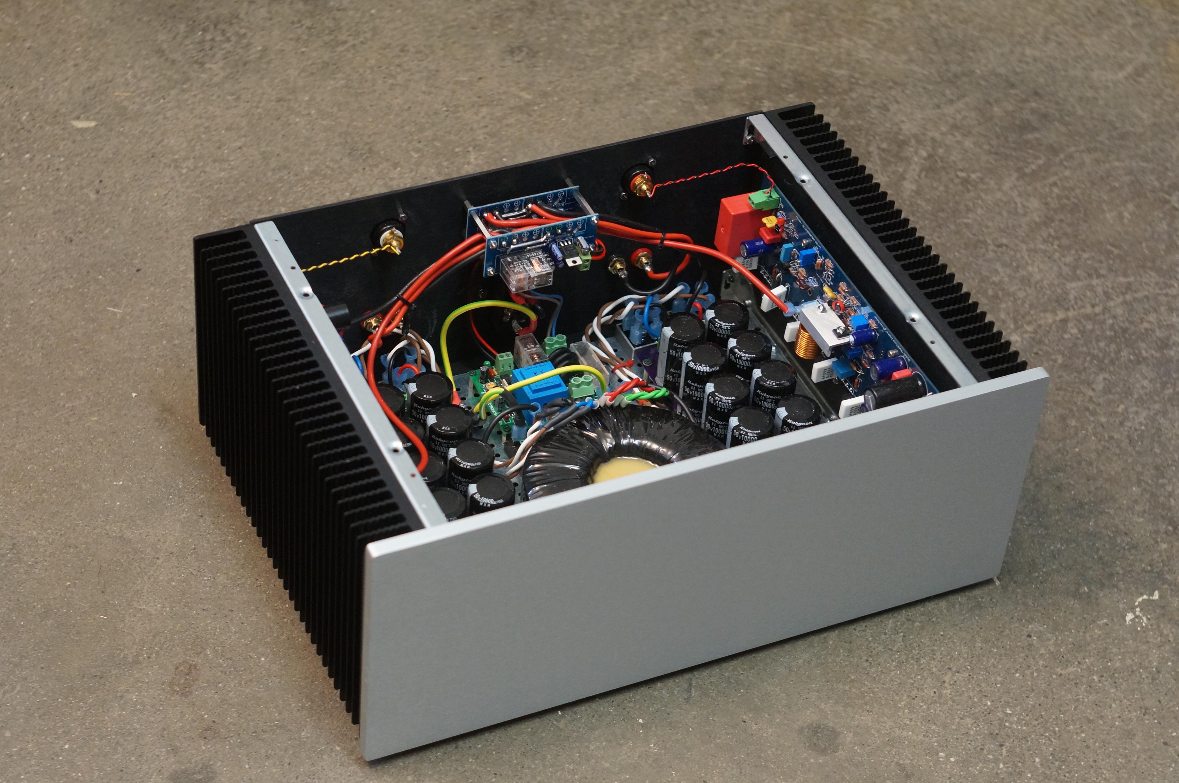

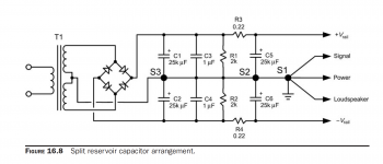

I believe this is what was intended by the designer.
I cover this issue in my ground loops write-up (see link below).
If you run the speaker return wire back to the amplifier module PCB, the important thing is to have good bulk decoupling on the amp module PCB, and it needs to be wide band. That way, you end up with only LF speaker currents in the 0V wire from the amplifier to the PSU star ground - the HF currents are trapped on the module through the bulk decoupling.
If you decide you want to run the speaker return back to the central start ground, just twist it with the speaker hot and then run it (twist if you can) with the 0V supply connection. There will be a short section that will not be coupled to either the speaker hot or the 0V to the PSU, but it should still be ok.
From my experimentation, it seems practically there is not much between the two - if and only if - your amplifier module board decoupling is good, which is pretty easy to do.
Happy building

in my amps, safety ground is connected to the nearest netalwork, i.e. in one of the screws holding the IEC socket screws...
i do not connect the main star grounding of the psu direct to chassis, but where the signal is lowest, via the input jacks and thru a low ohm resistor....
i have done amps using plastic casings, and grounding was never an issue...

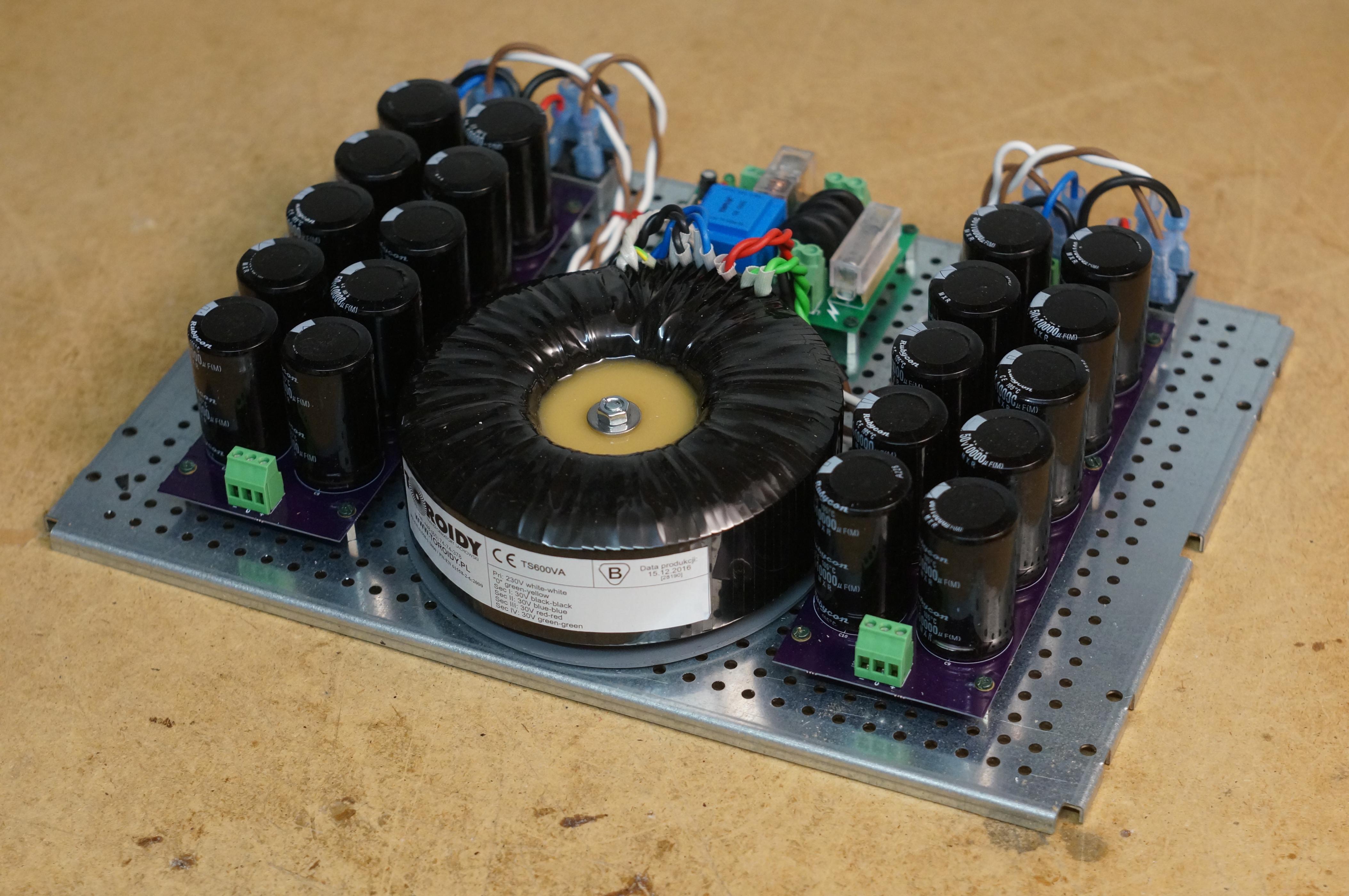

Wow. Thanks John. Such a great idea I'm really impressed with this pcb.Hi Stu, they are the transistor mounting screw heads seen through holes in the PCB. All the transistors mount underneath the PCB to save heatsink realestate.

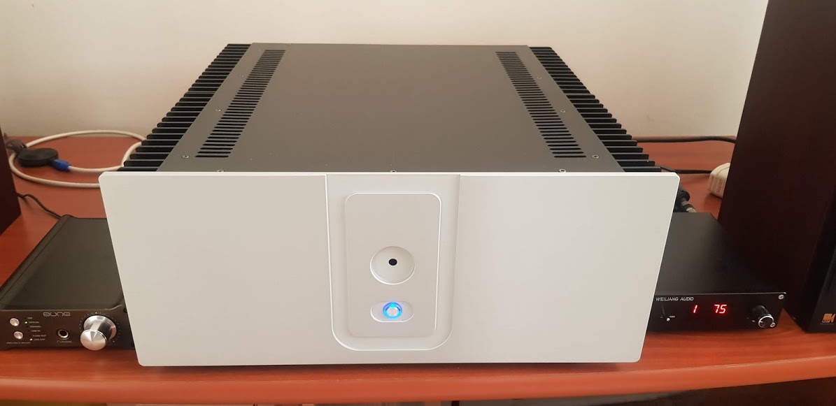

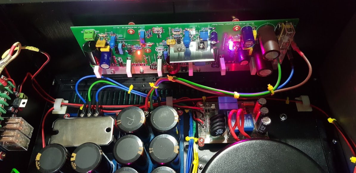

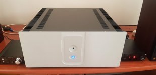

Honey Badger amplifier completed
Thanks to everyone who have contributed to this forum, I managed to build this amp without burning any components. I've set the bias to around 30mV for R30 and with the large heat sinks, I am able to keep the heatsinks hot but not too hot that I cannot touch them.
The sound of the amp is amazing. I compared it to my old Marantz PM7200 and Arcam alpha 6 plus amplifies, all 5 star amps on WHat Hifi, this amp makes the music soundstage so much more appealing. I played my music through Elac Unifi F5 slim floorstanders which were 4 ohm speakers.. and the amp didnt have any issues controlling the Elacs.
Here are some photos of my amp.
Best Badger yet. Very nice output stage implementation.
VERY ample PS , too!!
Mine has even more caps in the PSU!
Rail voltage is abot +/- 40 VDC only in mine. Works great, though!
