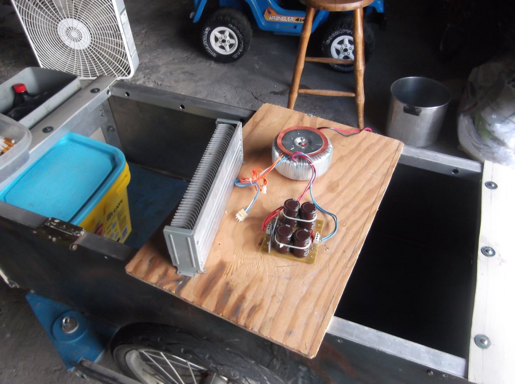

1. Subwoofer amp - I found a 40-0-40VDC PS (below - free!!) This amp will be maxed out , all 3 pair , lower voltage (SOA 4amp per device). This amp will be "down and dirty" MJE340/350 VAS running at 12ma , have to run a 3.2R load in a sealed enclosure.
2. A new 2 channel full range amp. If I cannibalize my present amp , I'll have a nice shielded trafo , 40Kuf , and 60-0-60VDC to work with. These amps will use just 2 pair el cheapo MJW1302/3281. I just have to power the missions ,and my present power stage does so admirably.
Ok, OS, I'll bite. Why amp bits on a cart with a box of kitty litter, cigarettes and a quart or two of oil? 😉
Just testing out my free camera
The pix tells a lot. I'm CHEAP (and green) !! 😀 "green DIY , anyone!"
I use no fuel , not burning a forest's worth of carbon to fly or drive around the world. (the cart crossed N. America on burgers and beef jerky)
The cart = more amps and speakers , the litter box has the tools to cannibalize what I find.
Not to get too in depth , but I intend to get what I want for free (or close to it).

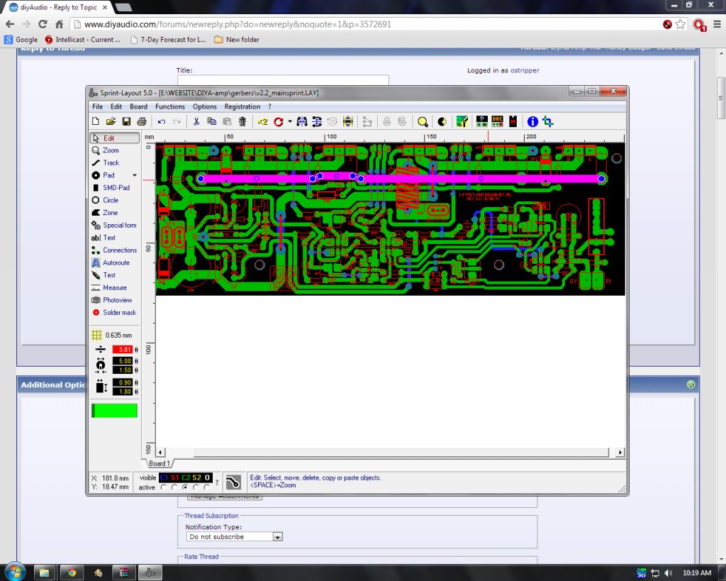

Well, the initial small run of boards is almost out. Since we had lost touch with you OS we had to move some misplaced mounting holes in the Gerber's for the first batch by editing the Gerbers. Since the changes aren't in your original layout files, and we don't have the original layout files we can't revise the board to incorporate some component hole diameters and pitch issues people have mentioned on the thread, not to mention the relocated mounting holes.
So I think the ideal thing would be:
-See if you have the original files you sent us the Gerbers from.
-We coordinate with you getting the mounting holes in the right places
-You incorporate the requested changes by builders to make building "Fun and Easy"
-you add any options or changes. Seems a good idea to keep the circuit very similar what with all the positive comments from people. Would be sad to not have it continue.

Variac ,I have all the original DIYA amp files , luckily all my hard drives survived my PC failure.
I won't just post them without your approval , perhaps I could privately give them to you (asian ripoffs😀).
Perhaps , if I knew the shortcomings, I could realign/tweak the layout "live"
as I have it all set up already (below). Any suggestions from current owners/builders or DIYA staff would be welcome.

OK, great news OS. I'll send you my e-mail via a PM. Then I can explain the "hole story"
Also let's look over the thread and see what people have mentioned that would help them build more easily.

Mouser improved (updated?) their website. Since I have both the Badgers sprint
and mousers datasheets, I can really be a perfectionist now.

I'm a novice and am in the middle of this build, if you want my two cents. The biggest hurdle for me was parts selection, but there are some BOMs circulating here that helped- high-end and budget versions would be fantastic.
Here are some other thoughts:
Revise the build guide to state that the jumpers are already in place on the boards.
C18 and C19 do not have the solder pads exposed. I read through the comments here but am still confused as to what to do.
A BOM for the power supplies in the store would be good too, perhaps even for the speaker protection and soft start boards.
A couple of the mounting holes don't have metal inserts, not a big deal though.
OS (and everyone else), thank you so much for all your hard work on this. I've done several projects and your build guide and the board layouts are at least equal to other "commercial" kits and better than most. I think a Mouser BOM is all you guys need to really get this kit moving.
C18-19 ....
These are actually optional. The reason for them is to compensate a driver with a very high bandwidth. The MJE15032/33 are low(er) Ft (30mhz) and do not really need them. A high Ft 2SC4793 - 2SA1837 (70-100mhz) used in many japanese output stages might benefit from these caps (most of these amps have them - luxman,nikko, and others). I included them on the board as these faster toshiba devices are a valid substitute for the ON semi drivers.
I highly doubt any stability issues . I've used many a junkbox toshiba with no issue. Adding them with not affect sonics.
Just scratch the solder mask off those pads.
I also noticed the minor issue of the solder mask on the "C/R/Z" jumper, as well.
