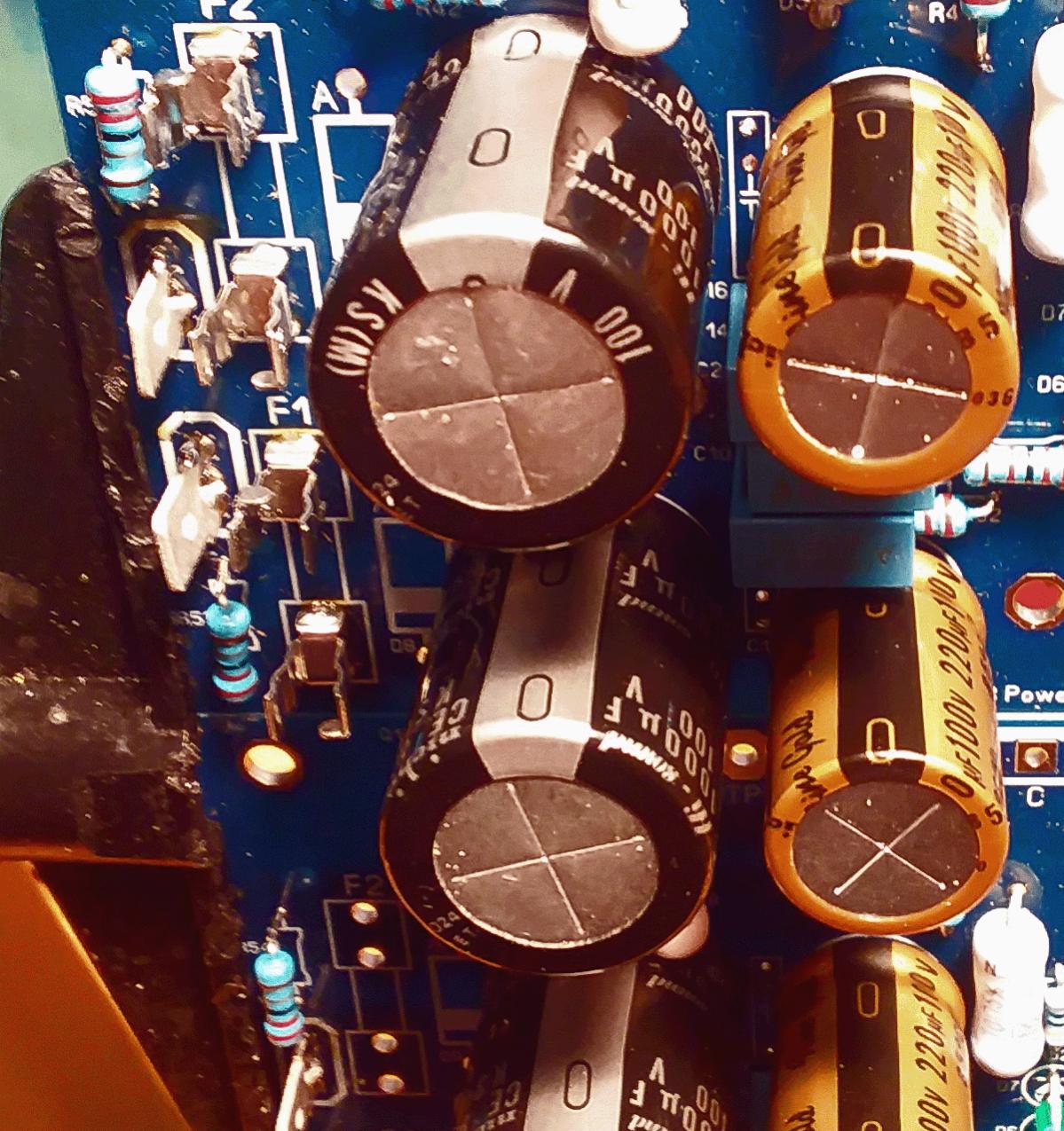

Copy that... you need to put some good tension on the wire for it to hold its shape without some form of containment. I still haven't decided whether or not to put an air-gap between the coils... there are reasons for doing, or not.
I have enough wire to do a lot of trial and error, so I may give it a go.
I'll get some pics of the boards when I mount them... My caps are a little large and space was limited. I had to get creative to get everything mounted.![whazzat :whazzat: :whazzat:](https://files.diyaudio.com/forums/images/smilies/whazzat.gif)
And a little cap porn... below.

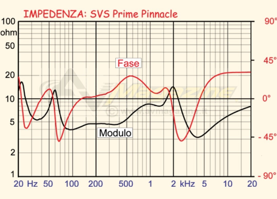

45-0-45V transformer works for 8ohm load. for 4ohm load you need to lower the voltage a bit.
How must "a bit" be big? Between 35 and 40V? Or 40 and 45?
This graph shows the impedance of my louspeakers. Their nominal impedance is 8ohm, but as the graph shows, the impedance sometimes goes below 5ohms.
![Prime Pinnacle impedance.jpg Prime Pinnacle impedance.jpg](https://www.diyaudio.com/community/data/attachments/826/826764-fadd5d76b56e62cd731421a8a9d644dd.jpg)
Then, what should I do in your opinion? Have to consider 8ohms, like the manufacturer says, or consider the graph?
