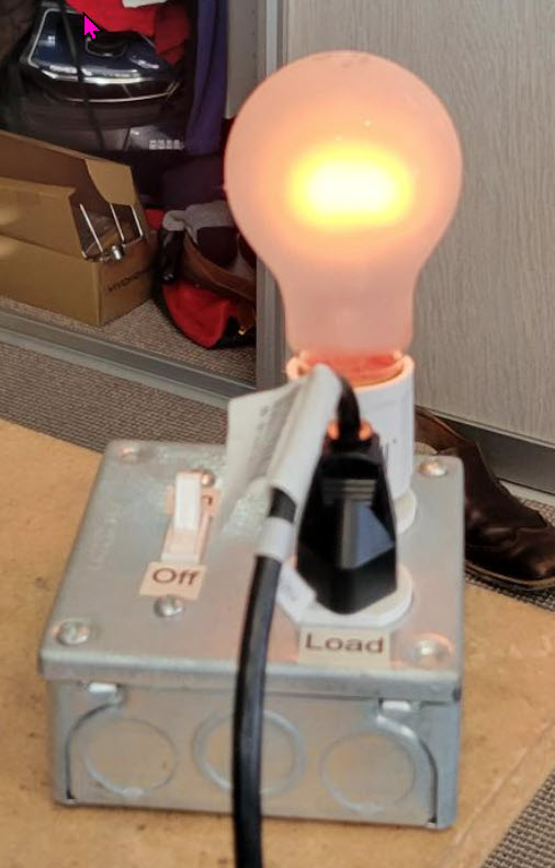

If you're measuring across R14 to set R7, you should be at 8.25 Volts, not mV. You don't have enough current flowing through the input stage. This will likely affect the output stage bias current (R30) so turn it down before setting the input stage current.
Output stage current will act strange with the light bulb hooked up. You can usually make the bulb start to glow by turning up the bias.

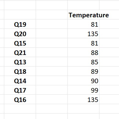

Finally got back to business.Is your softstart cycling? It sounds like you power supply is drifting around because of the light bulb. Can you get it to run steadily at 20mV now?
I was running the right channel and achieved after 10+ minutes:
R14 8.19 DCV
R30 20.mV [it was still fluctuating, but not as widely as my previous attempt to bias]
R17 3.4 mV
The amp was on for about 15 minutes and the bulb started to burn bright as I was adjusting the bias.
Then here was a click and the soft start started cycling, so I shut everything down.
Below are the temperatures of the transistors just before I shut it down.
Is this progress?
