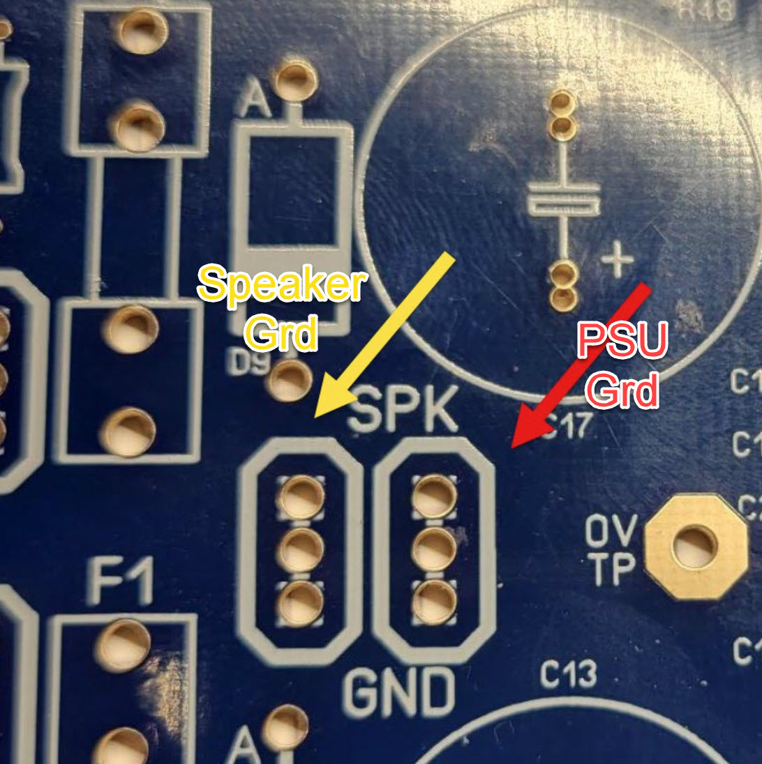

Ok. First things first. Regarding the correct PSU wiring to amp board.
Have I sorted this correctly?
Before I start turning the lights on, do I have the grounding scheme correct? I seemed to be confused about this.
From where the "spk" is marked I'd think that's where the speaker ground should be connected?

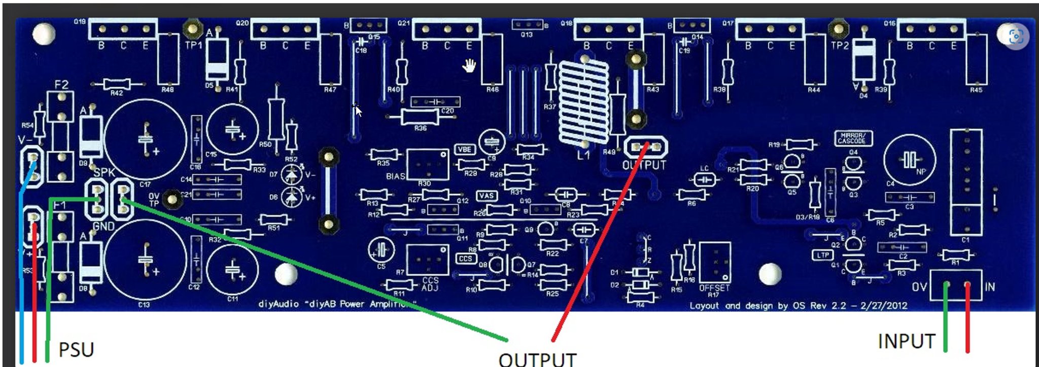

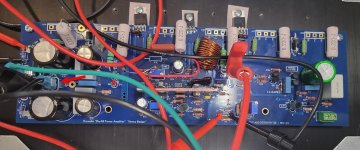

Well, things didn't go as planned. I built my 2nd board and set things up for initial test. But I had messed up and ran the PSU ground to the speaker ground. On turn on, with DBT, I saw smoke immediately. I turned the amp off. I tested all the resistors and could not detect what had smoked.
So I set up for initial test again with the PSU ground to ground {as shown above} and turned it on. Again smoke. Turned it off. Cannot see any visible source of smoke. Not sure what is going on. Did I fry something in the first round that doomed the 2nd turn on? Or is some part in the wrong place.
I'm inclined to build another board and hope that third time is the charm.
I see a red connector attached to the -ve terminal.
Smoke is likely the limiting resistors across the fuse.
(edit) I think the red connector is for measuring.
The 3A power diodes saved my amp when I got mixed-up with the colours of the power supply wires, thinking you may have made the same mistake I did.
Chiptech,

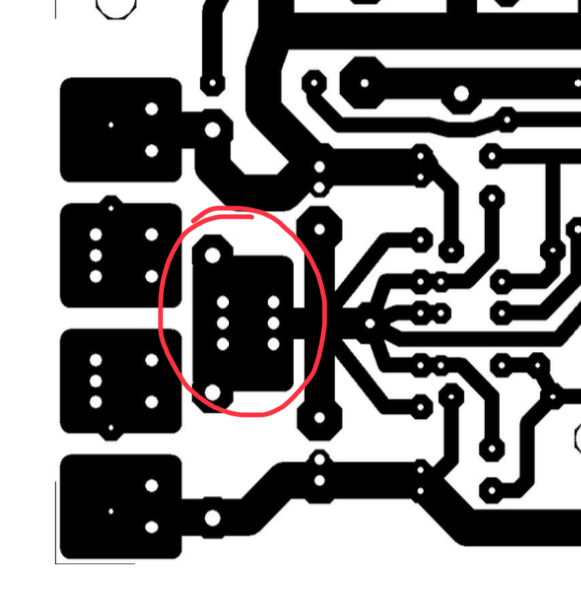

To convince yourself of this, note the circuit trace drawing/foil trace in the design doc which I am assuming you have and probably have memorized by now:
Note how speaker ground and power ground are exactly in the same place. Electrically they are the same.
I am very curious as to what was connected to the RED alligator clip which is attached to your speaker output section. That should be connected to a DMM. The COM section of your DMM should be connected to one of the GND terminals.
Your V+/V- should be connected to your power supply, it’s hard to see that in your pic. And obviously there needs to be a ground reference, so your PS ground should be connected to GND as well.
Do you have a variac? Or a bench supply? Or do you only have a dim bulb tester (DBT)?
Best,
Anand.

Double check the drivers (MJEs on h/s) are in the correct position, not swapped? Can't tell from your picture. Also, are your VAS on the small aluminum h/s properly isolated, again can't tell exactly which transistors you are using, but I don't see insulators on h/s or bolts.
Thanks for all the input.
1. Ground doesn't matter which the PSU ground goes to. Got it.
2. It's entirely possible that I switched the + / - leads from the PSU to the amp board. I thought I checked that, but now I can't be sure.
3. I forgot to use the insulators and did not use thermal cote on the heat sink transistors or on the two sets of transistors. So that has to be sorted.
4. I did use a DBT and did not see the bulb dimmed quickly and then I smelled smoke. I have a variac. I don't have a bench supply but could likely borrow one for the next round.
More to come.
Reactions: UncleMud

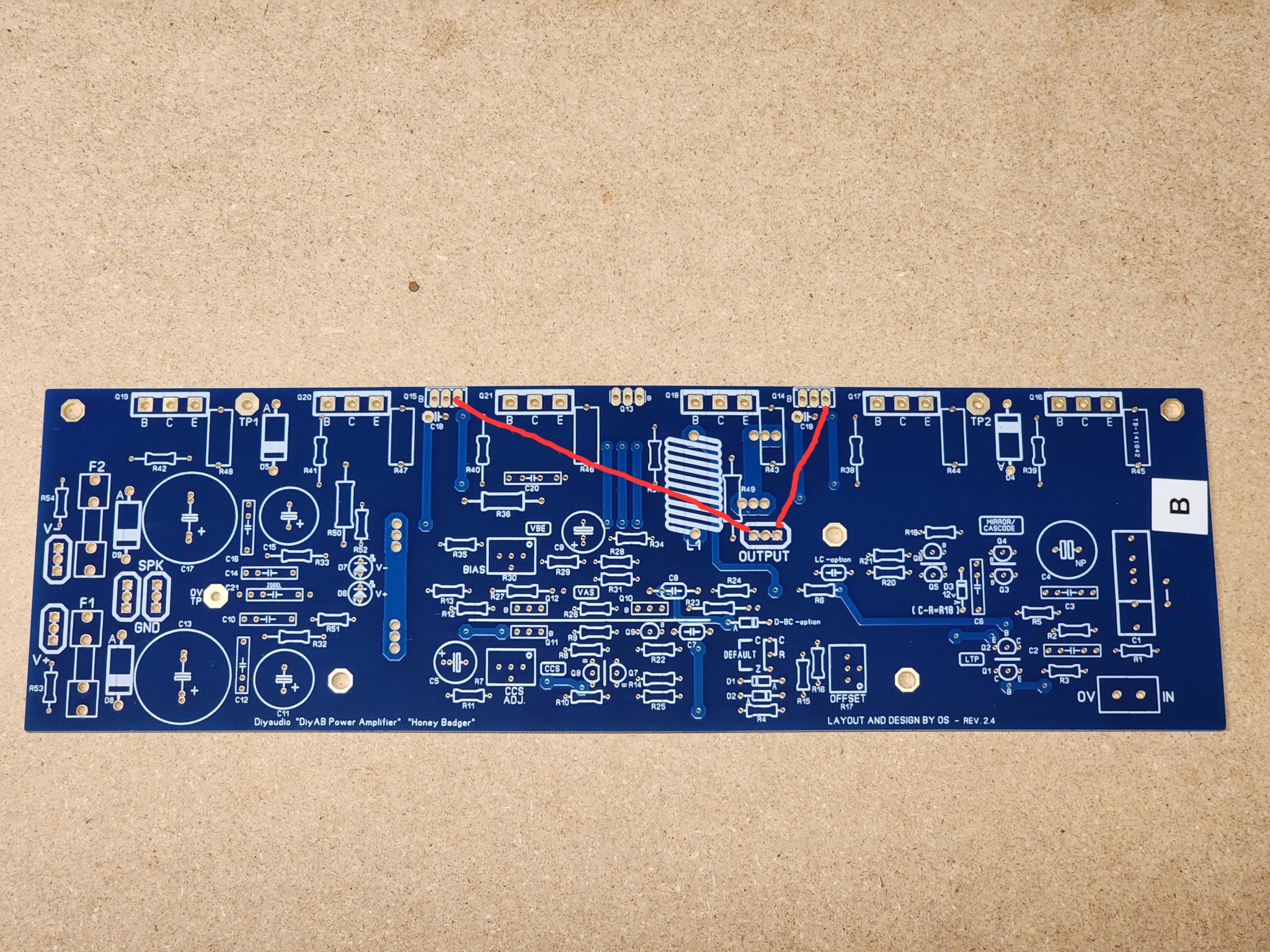

So you don't waste any more outputs , I omit R36 .... run 2 -68R resistors from Q14/15 driver emitters to the output. driver emitters should read 1.1-1.2V -(between them) adjust Vbias .... Then populate the "big boys" NJW's ...
What you are doing here is creating a little 5W amp with the drivers BEFORE you put the high current parts in. You don't even have to heatsink Q14/15 to
pretest for high power. 1.1V will equate to very low (bias) current with the installed outputs.
OS
You need to instal all parts except the output power transistors .
Omit R36 ,connect the output to each driver emitter using resistors 68 Ohm .
This way you ended up with a small 5 W amplifier
If it is a sassesfull atempt,as Pete recommended you have to remove the resistors from the output,install the R36 and the output trsnsistors.
This way (low current consumption)you haven't to worry for a catastrophic and expensive failure .
Hello Forum Members,
I have been following Chip's start-up efforts as I am about two weeks from testing my boards.
Please forgive my confusion. The recommendation from Pete and thimios to omit R36, and connect the emitters of Q14/15 to the output using 68ohm resisters sounds like a great strategy. I would like to try this myself. Could someone review the picture I have attached to see if I am understanding correctly? I have drawn a red line where I think the connections  should be. Thank you for your patience.
Respectfully,
Dave M.
Yes , perfect... drivers don't even have to be heatsinked. Little 5W amp dissipates <20mA. I've even hooked headphones to a pair
of amps like this through a 33R resistor.
Edit - while I've checked/adjusted the current sources . Offset needs the outputs for a final adjustment. Bias at 1V between emitters.
OS
