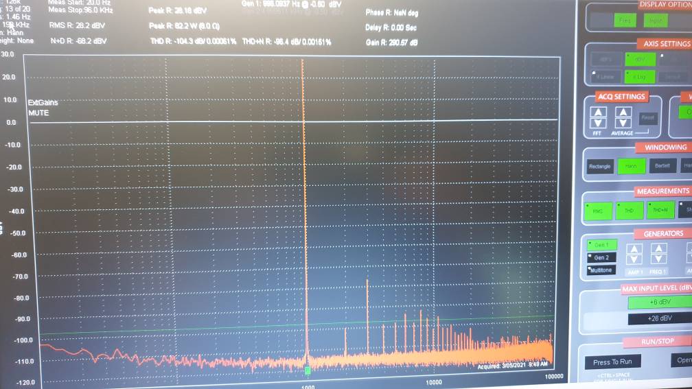

Can you ask them to see if the resistor is magnetic?
Hi Stuart,
Please be informed that this part is not magnetic as per Supplier

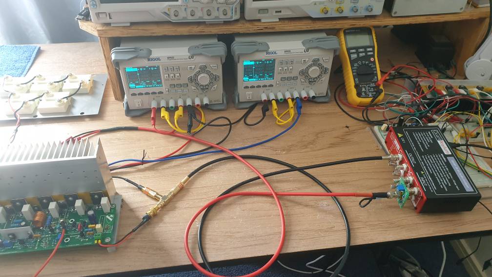

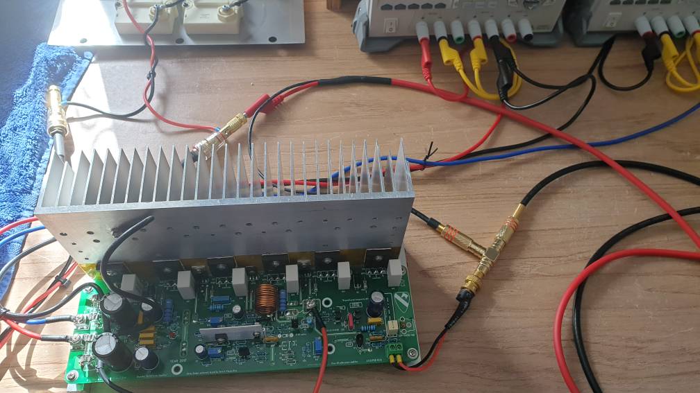

1. It is a good demonstration of theory. Remove the ferrite core and it will not cause much more distortion over the 1.5uH inductor.
Since you have remote mounted the inductor, it would be interesting to put it back in place after testing with a linear resistor, and then we will know for sure if any of the nearby steel causes distortion in the inductor. Because we actually can't rule that out unless we have a linear load.
2. Yesterday I replaced the metal film resistor across the output coil in my bench amp with a nonmagnetic one.
3.And that really feels like fudging. I can only imagine Stuart feels the same way if he has been going at this for months to find the solution.
1. I will definitely try that when I get time. Please note that this was an extra inductor that I added in series with the load. I had already soldered back in to the pcb the original inductor in the original location.
2. Please take some photos as a picture speaks a 1000 words.
I never knew there was such a thing as a nonmagnetic resistor. Do you have a part number?
3. I've been taking distortion measurements for over a year now and this has been causing me alot of grief as you know. But I'm really glad that it's helped you find a solution to a issue that you were having. Lets hope it helps other members too.
You can't really tell from looking at things whether they are magnetic. The original coil resistor was a 1/2W carbon film and I used a carbon comp resistor to replace it, but those can still have steel endcaps or steel leads. Same with binding posts. You don't really know until you test it with a magnet.
I can't detect any magnetism from the stainless bolts I used with the EBG resistors with a strong neodymium magnet, and they don't cause any distortion that I can detect. So some grades of stainless seem to be okay.
I'm curious where the Mouser staff gets their information because nowhere on the datasheet does it specify that resistor is nonmagnetic. Maybe they just assume that non-inductive means nonmagnetic? I have been burned in this scenario several times. Maybe you need to clarify.

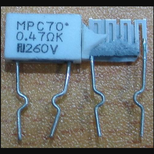

This looks like a potential candidate for the coil resistor:
Search results for: koa bpr KOA Speer 10 Ohms Current Sense Resistors - Through Hole – Mouser Australia
Picture of a similar resistor from Fukushima Futaba is attached.
