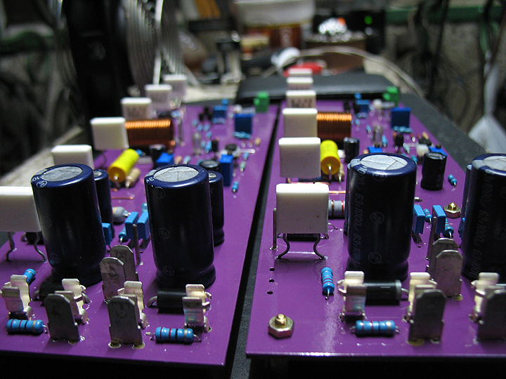

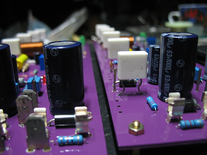

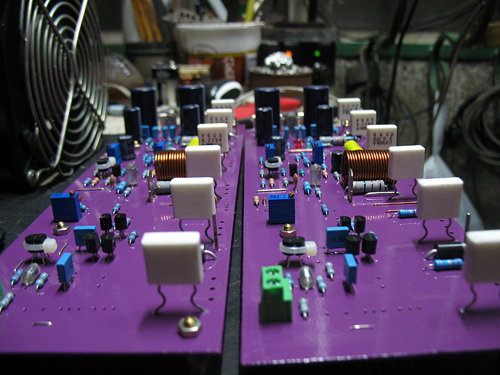

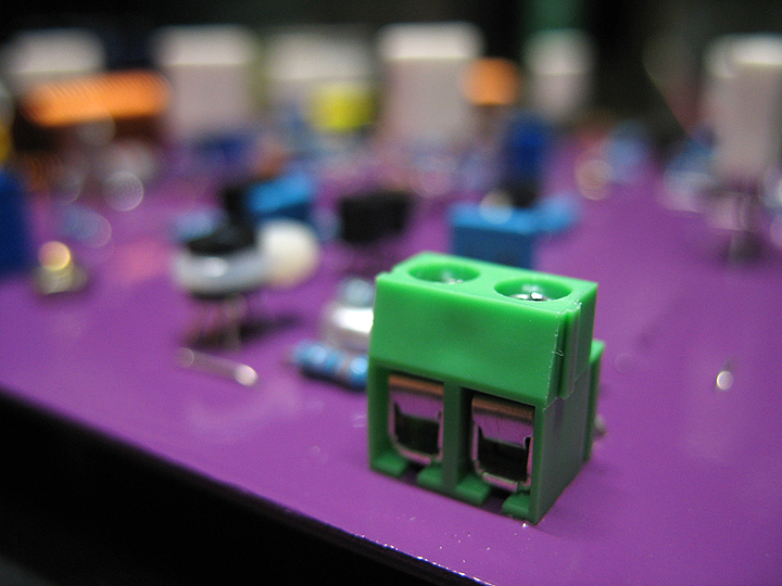

That's a nice looking board you got there. Though I'm biased with OS's approach because I love those casings with the heatsinks at the sides ala Krell.
You're right, I hope someday (in our lifetime) heatsink prices drops like a rock... though I doubt it... 😀

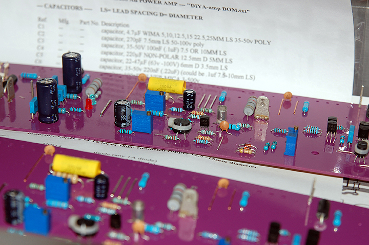

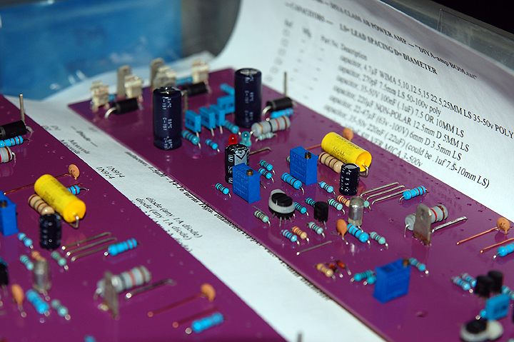

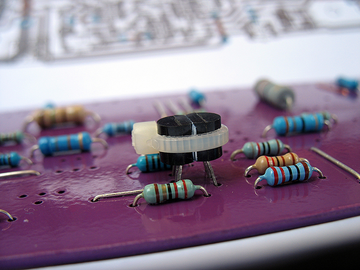

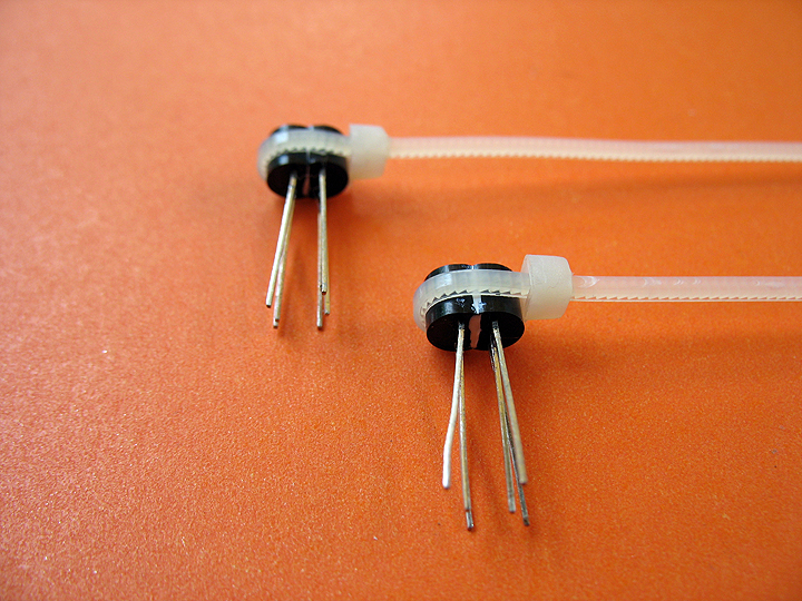

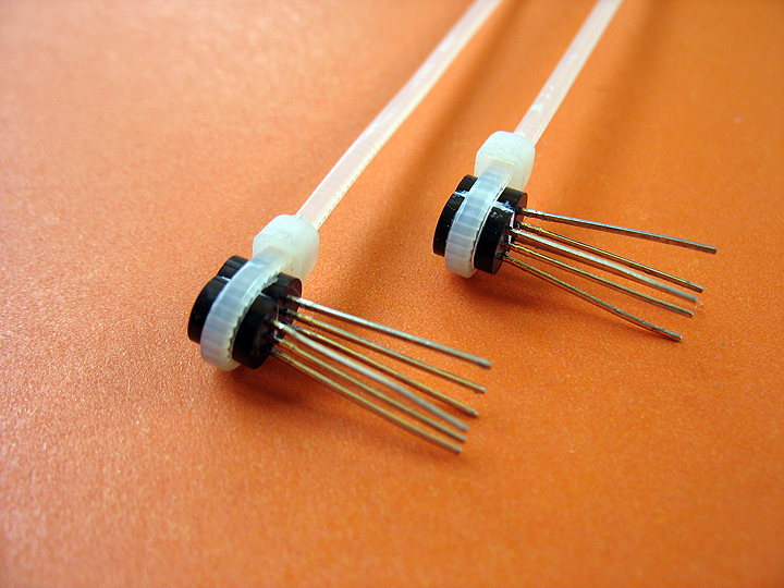

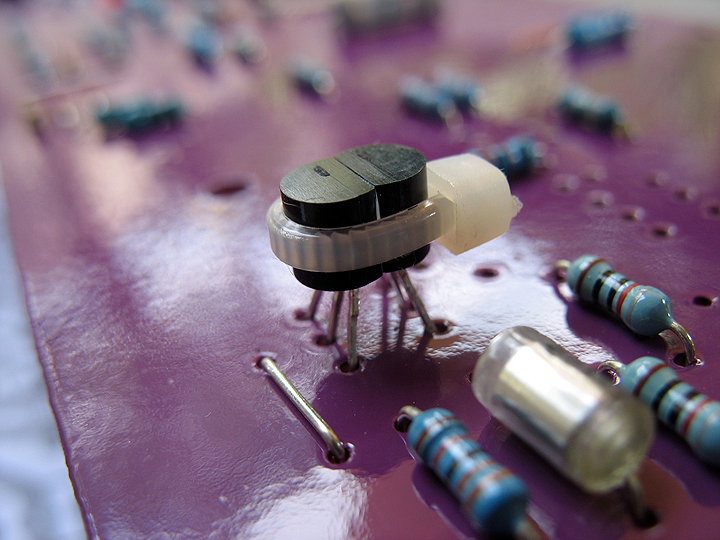

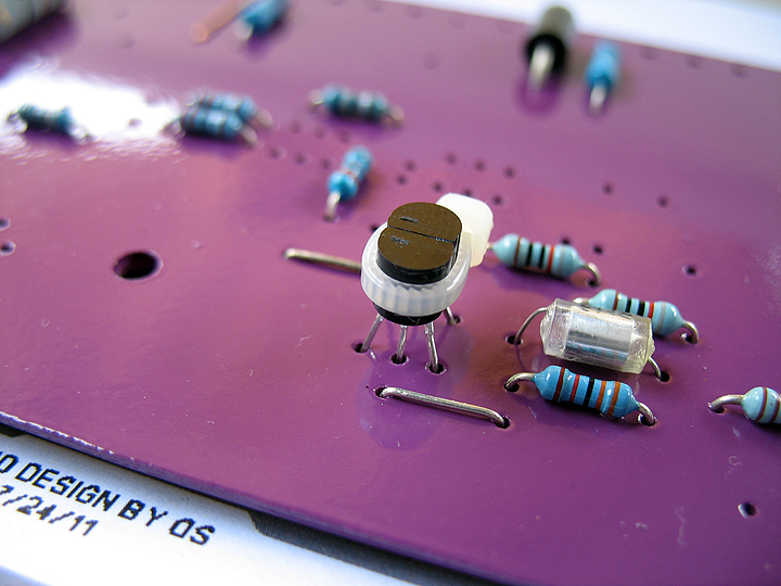

matched hfe for the LTP transistors...
applied thermal compound and tied the LTP transistors...

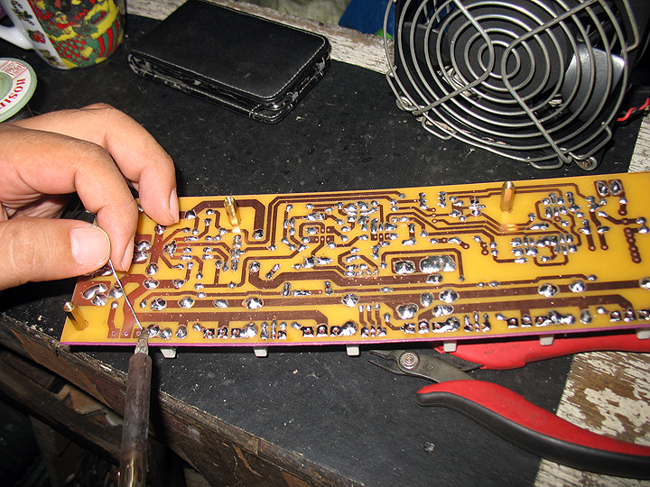

mounted and soldered...
I also did this to the small CCS transistors...

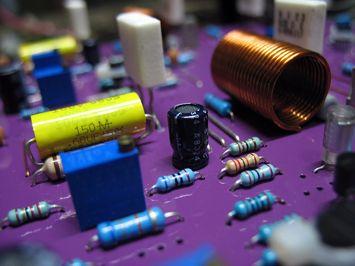

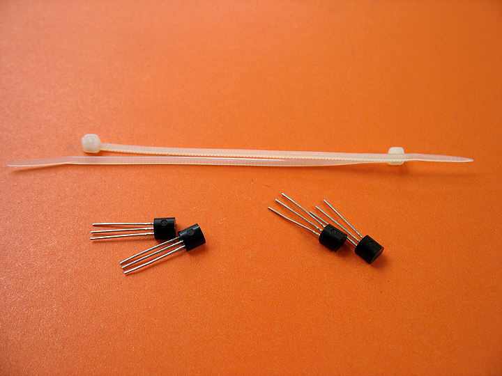

^not if that is a genuine nylon, besides those trannies do not heat up that much if at all.....🙂
I wonder if nylon cable ties suffer from creep.
I have used the same in my more than 8 year old diy amp and so far I see no problem. The cable tie I used is somewhat stretchable and not that brittle.
I'd welcome it very much if you have a better technique to share.
you can also use this "panduit" stainless steel ty-wraps.......Stainless Steel Cable Ties, Permanent Identification
Yes, as mlloyd1 pointed out, I would expect heat shrink to work quite well. Superior to cable ties? Perhaps not significantly so.I have used the same in my more than 8 year old diy amp and so far I see no problem. The cable tie I used is somewhat stretchable and not that brittle.
Thanks tony, those things looks real sturdy...
heat shrink tubing also works well here for small signal devices
mlloyd1
thanks, that's a great idea and should really work well too..
I'd stick with the cable ties for now, will try the heat shrink tubes in another project though...

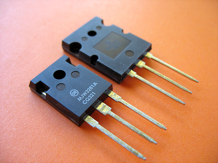

Big Brother 😉
There's one vote, anybody else? 😀
I actually have both sets of the MJW and the MJL... I'm just looking for enough reason to use the bigger ones I guess... 😀
If you are using multiple pairs then the little brother may give adequate cooling/dissipation.
If you are using big brother than a one pair output stage is more feasible.

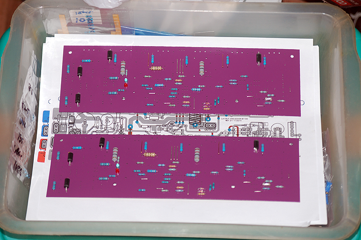

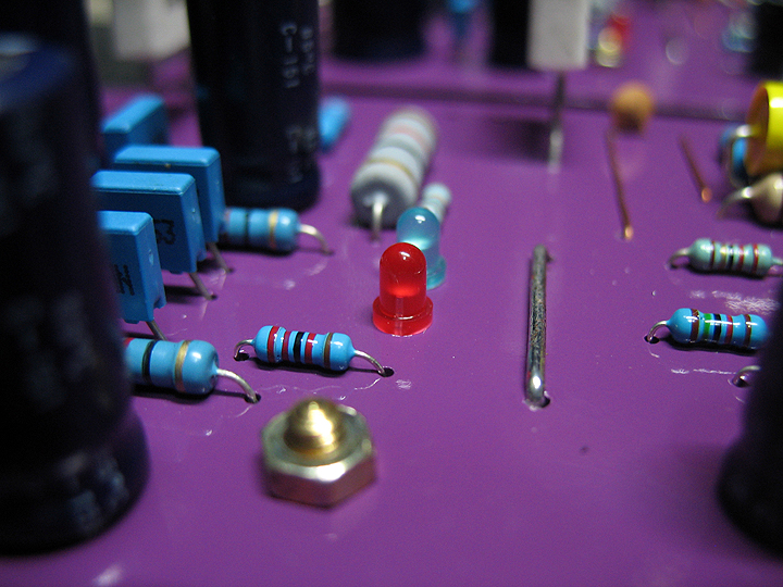

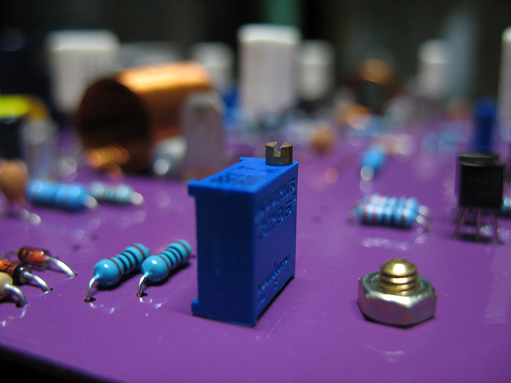

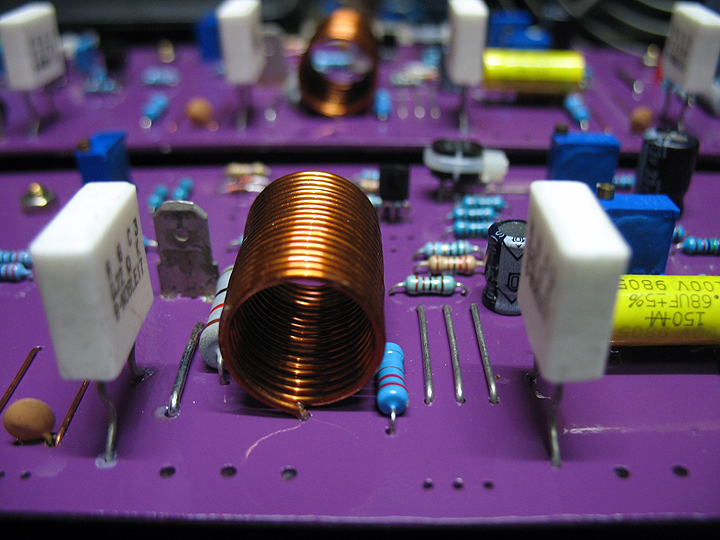

Baby steps... It's a holiday today so I got some time to work on the boards...
and some bokeh shots... 🙂
Excellent point, I might just be wasting Big Brother for this amp if 3 pairs of Baby Brother is more than enough...
That's one point each for Big Brother and Baby Brother then... 😀
