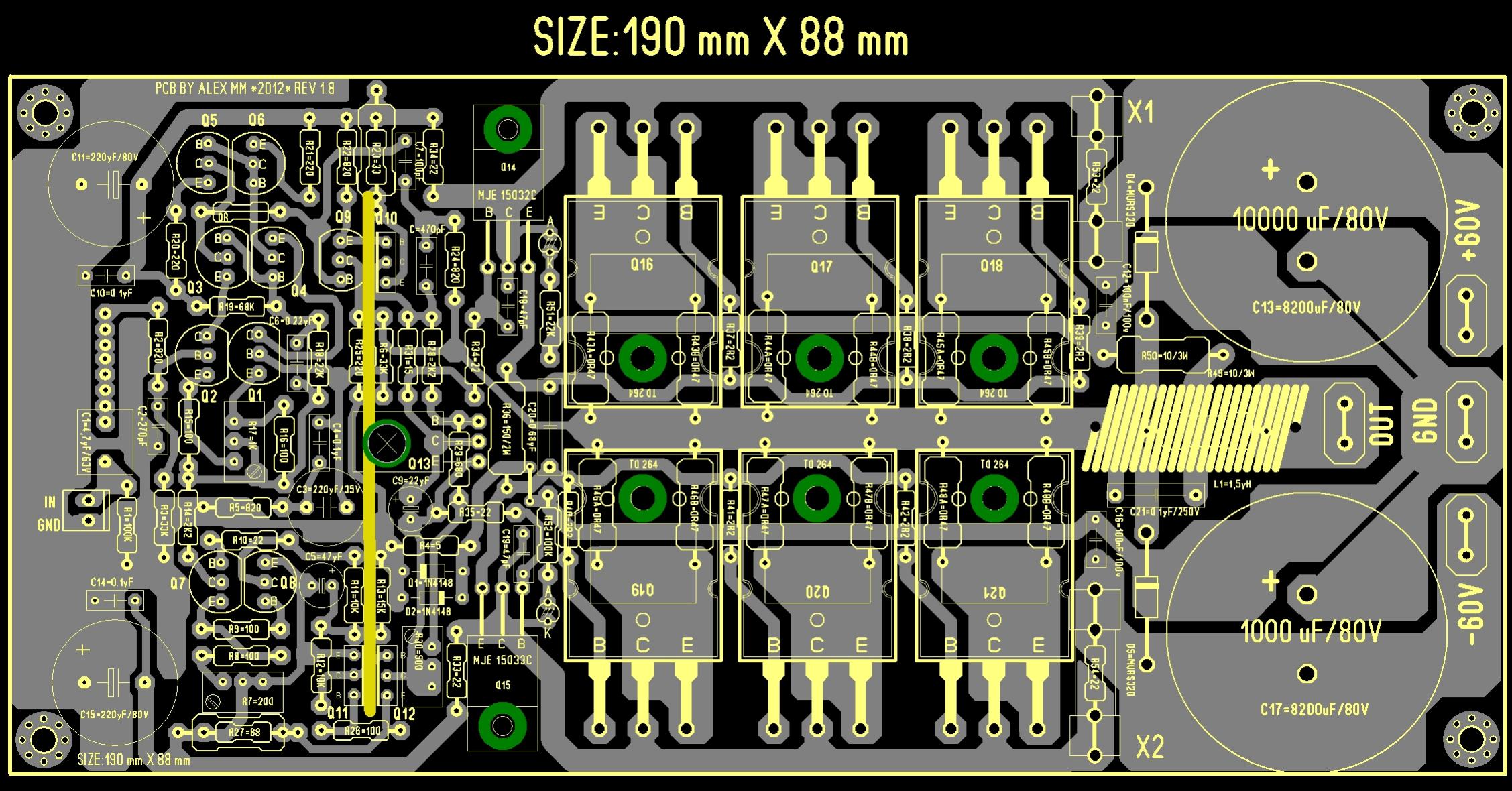

Alex, that PCB looks good, but the diyAudio PCB needs to work with heatsinks already drilled for a different project to meet the goals set forth at the beginning.

...... I layout this rev 1.8 and ask you what's wrong with PCB ? Size only 190 mm X 88 mm . I can also modify OS PCB for us in better shape ......![]()

nice layout, users of Conrad Engineering hatsinks will find this layout very useful...

love that alex mm is here for us . his pcb design work just amazes me !!!! however i do question all the heat from the outputs so tightly together .

imho, having those power trannies close together means they will track each other better, not a bad thing......especially when using conrad engineering heatsinks....

Alex, the decision to put the rails both on one side of the board, instead of wrapping around it was made for a reason. Furthermore, the feedback point is at not at the output terminal where it should be. OS's board was very carefully designed. Do not underestimate OS's work.

I remember that it was you who influenced OS to put the rails together. IMO a wise decision. If one wonder, just look back in the thread.

The layout could perhaps be even better while keeping the OS style layout. If we look at the PS section, loop area could be smaller. The cap closest to output section could feed BJT's furthest away and vise verse...

What we want from a PCB in audio is minimal degradation in bandwidth domain. Tracks current capability is not an issue, correct layout organization of the parts on the PCB and PCB itself as major part here and its sum of all parasitic influences to all parts is the biggest problem and what PCB designer has to have all the time in front of himself. Theoretically calculated frequency compensations resulting in no change on finished PCB will tell us the board is fine. New problems arising (oscillations, hum, noise, etc) when putting an amp into action will tell us, although too late but nevertheless, the PCB is falsely designed.![whazzat :whazzat: :whazzat:](https://files.diyaudio.com/forums/images/smilies/whazzat.gif)

in this case, just move the output pin closer to the feedback point and we're done.....me, i put the output coils at the binding posts anyway......
I think it's okay to fix pin spacings, why not? But the basic layout should not be compromised. If you want a different board, then by all means etch it yourself. But to jump in when OS is not here and suddenly try to change the design when he cannot add his input, is totally ridiculous and unfair. You should have discussed it with him when he was making the decisions, when there was a level playing ground.
