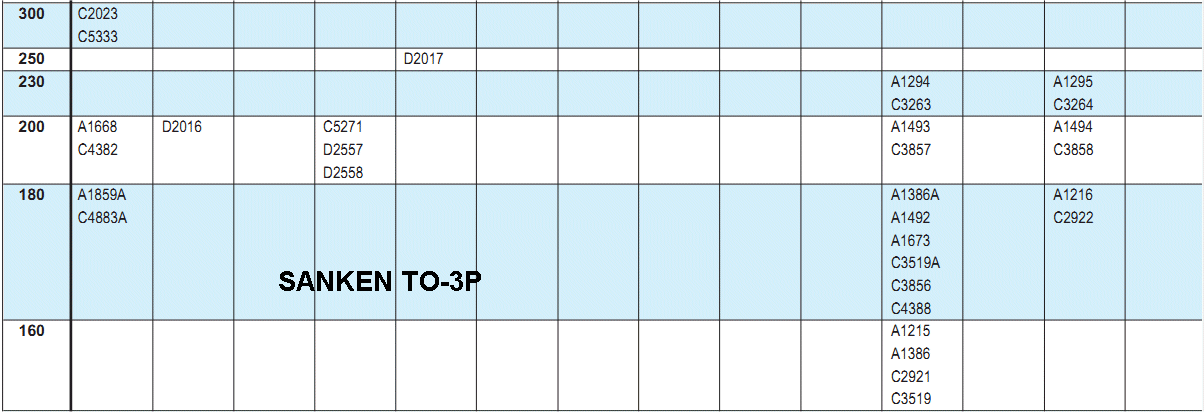

LIST of outputs ....
For the full 150w
NJW0281/0302
MJL4281/4302
2SA1943/2SC5200
Sanken to-3p's (below 1) quite a selection ... any below would work.
150w (marginally)

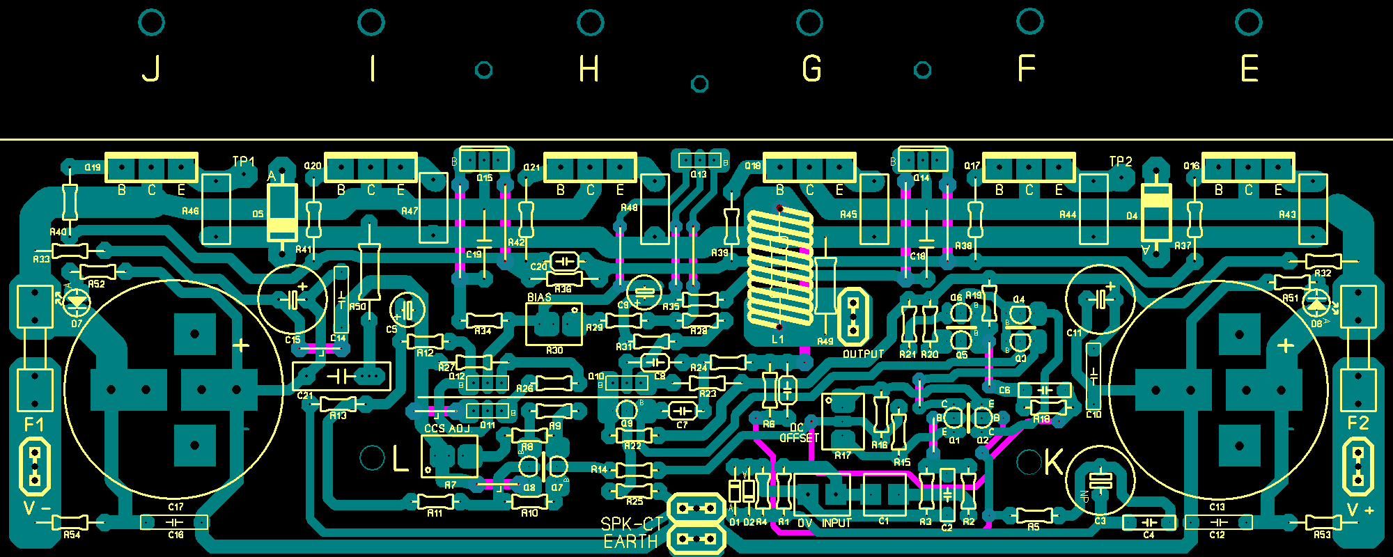

To ground plane , or not to ......
I was looking at the famous Doug Self "blameless" -
The Signal Transfer Company: Compact Blameless Power Amplifier
Close inspection of the PCB shows typical rail connections (like this amp) , and a ground plane around the input stage. Self's amp seems to stay PPM despite it's conventional layout (look at the AP THD graph) at 25w. At 100W , who knows ?
I'm at that point with my cad (below 1) , now I just have to decide WHAT ground to connect the plane to. Any pointers ???

I'm not a big fan of ground planes on power amps. They just seem like an opportunity to couple signals to where you don't want them. If the purpose of the plane is purely shielding and the reduction of radiated signals, I'd connect it to input signal ground, as that's the one point declared to be "true ground". Either that, or wire it back to the PS ground stub, probably the safest bet.
:up:

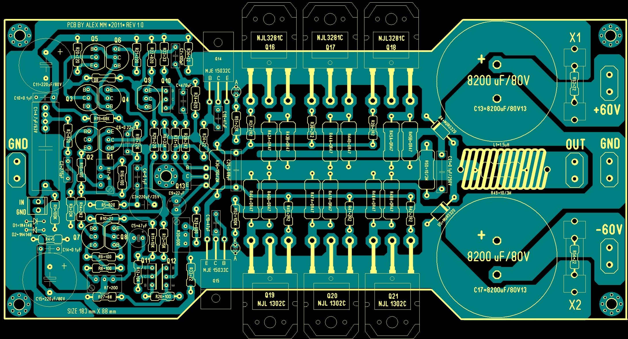

I like this one Alex, keeps high currents close together, small signal circuitry away from output inductor. Very nice.
All the pcb's in this thread are lookin' good.
Ground planes aren't simply a grounded equipotential higher frequencies. The 'return' currents through the ground plane will actually follow the trace underneath them that carries the corresponding signal. If you want to control where these currents flow in order to make a star earth you have to think carefully about the design of the ground plane.
A HAH !!
....My contribution, with another arrangement of parts on printed circuit .:)
Regards Alex .
Beautiful , alex. Your work is my inspiration.

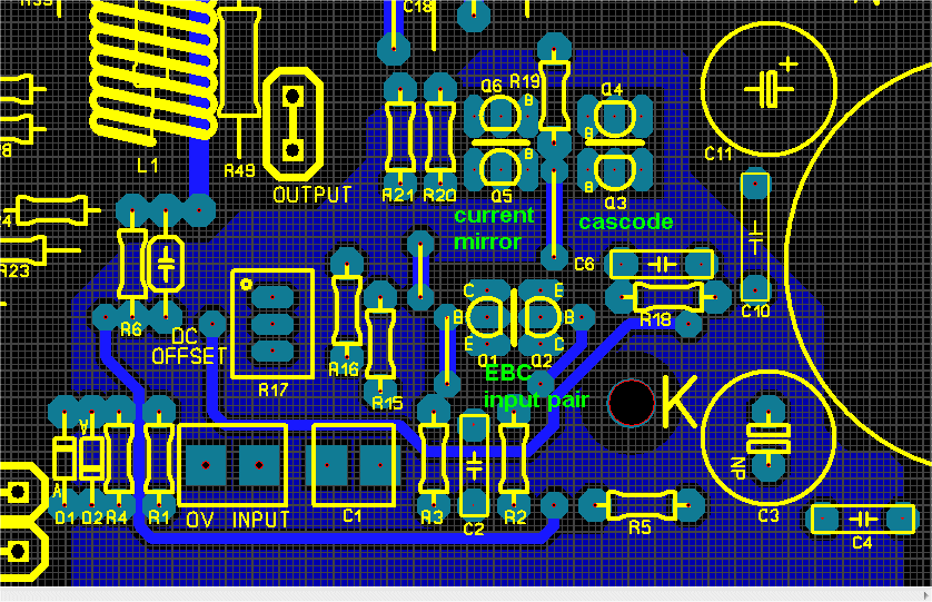

First ... only the input filter and input euro-block ground goes after the lifted ground resistor/diodes (5R or 4.7R).
R13,25/ C3,4 go directly to ground (the second "clean one")
You have 2 grounds ... this can work (universally) with another faston placed on the main decoupling ground (hook the 2 grounds together) as this amp (can just) have it's power supply onboard. If a external supply is used (to augment the onboard supply), the 2 separate grounds could go the the main star there.
- no VAS heat-sinking Q10,11,12
- Q13 needs a bigger hole
-C13,17 can only be 10mm LS 25mm unit , limited to maybe 10Kuf X 2.
35mm with 4 pin 22mm would allow apex jr. caps plus 15-22k panasonics. :)
-Q1,2 should be E-B-C , most good 45-60V BJT LTP pairs (90+%) are.
- C1 (the input cap) hey! ...what about the wima 5mm or 10mm poly's -
Fix these things and you will have glory.... :D
Oh BTW - here's mine (below)
Let's have a "shootout" , Alex :D

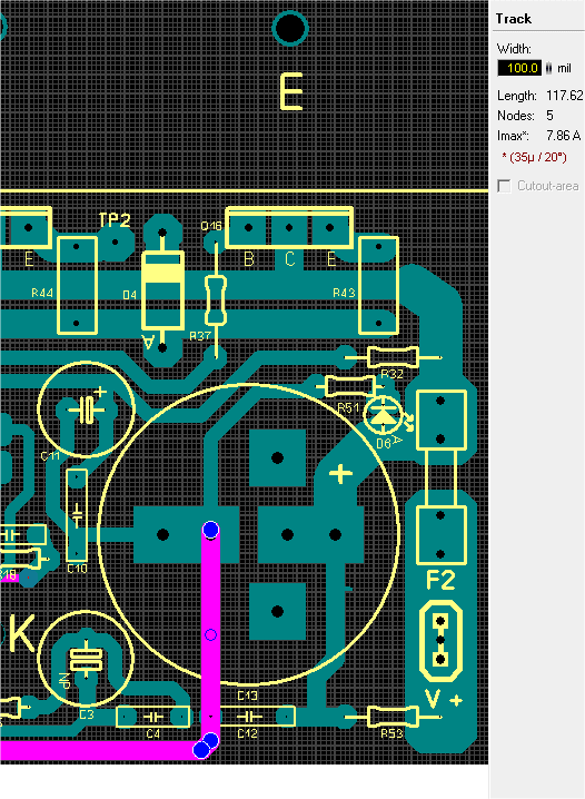

The grounds between the main caps are too thin for my liking.
I generally keep the main storage caps off the pcb or separately on one side of the pcb a bit like alex did. and have the high current stuff like speaker ground going from the caps and only keep signal ground going between PSU and amp.

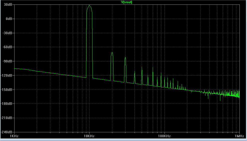

So , a "growling beast" of an amp with (below 1) .... just "fine tuned" both the BJT and FET versions of the cascoded input stage (same" perfect circuit").
quite the FFT , almost audiophile. A slight tradeoff in PPM's for better distortion products.
Simulated with high inductance supplies / resistance to get the ripple a ripplin' , did the "worst case" scenario at 100v p-p/10k ... still nice. :)
look below - 7.86A for those traces with just 1 oz. copper. "Imax" (below 1) 12A for 2 OZ @ 20C.
OS
