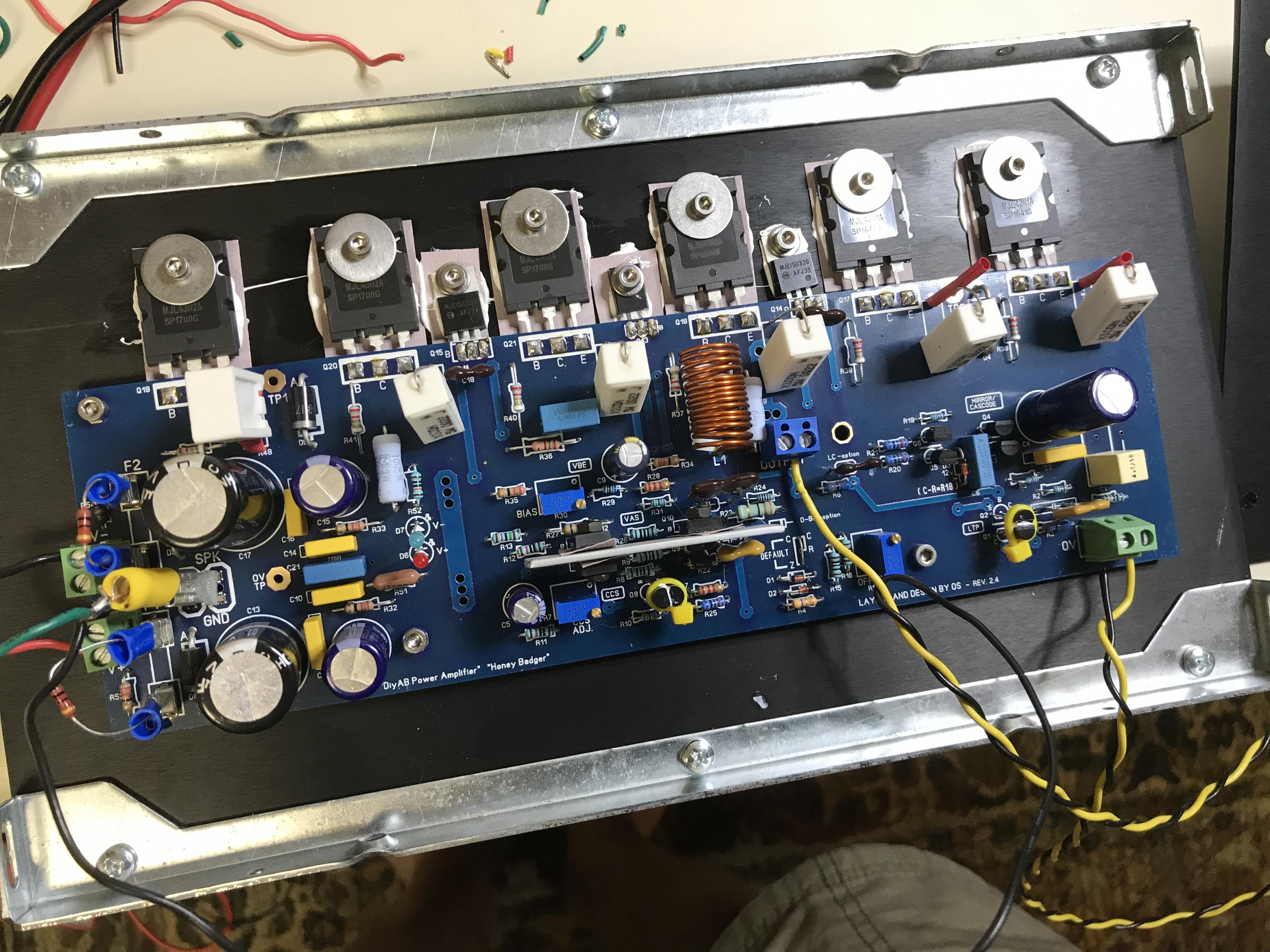

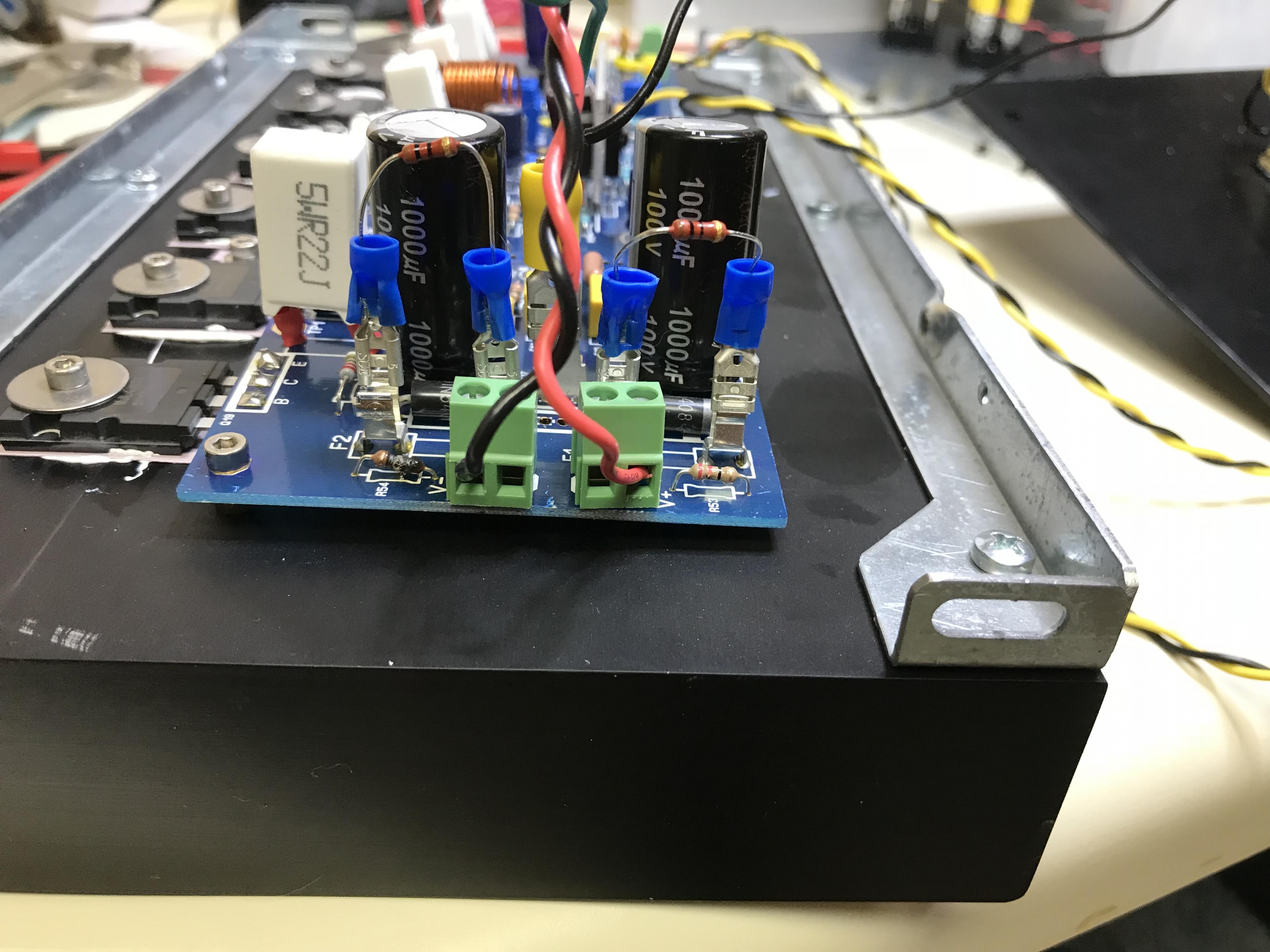

Smoke and sparks
Started my first test Power supply measures spot on at 63.8 volts both sides. Installed my two 10 ohm resistors in place of the two fuses turned on the power and r54 went up in smoke One thing I found later is if I put my continuity meter on a any C terminal of the transistors and the heat sink frame I have connection and other ground spots. Is this normal? I did my test without any soft start or surge protection ( cl-60 will be here in a couple days)
