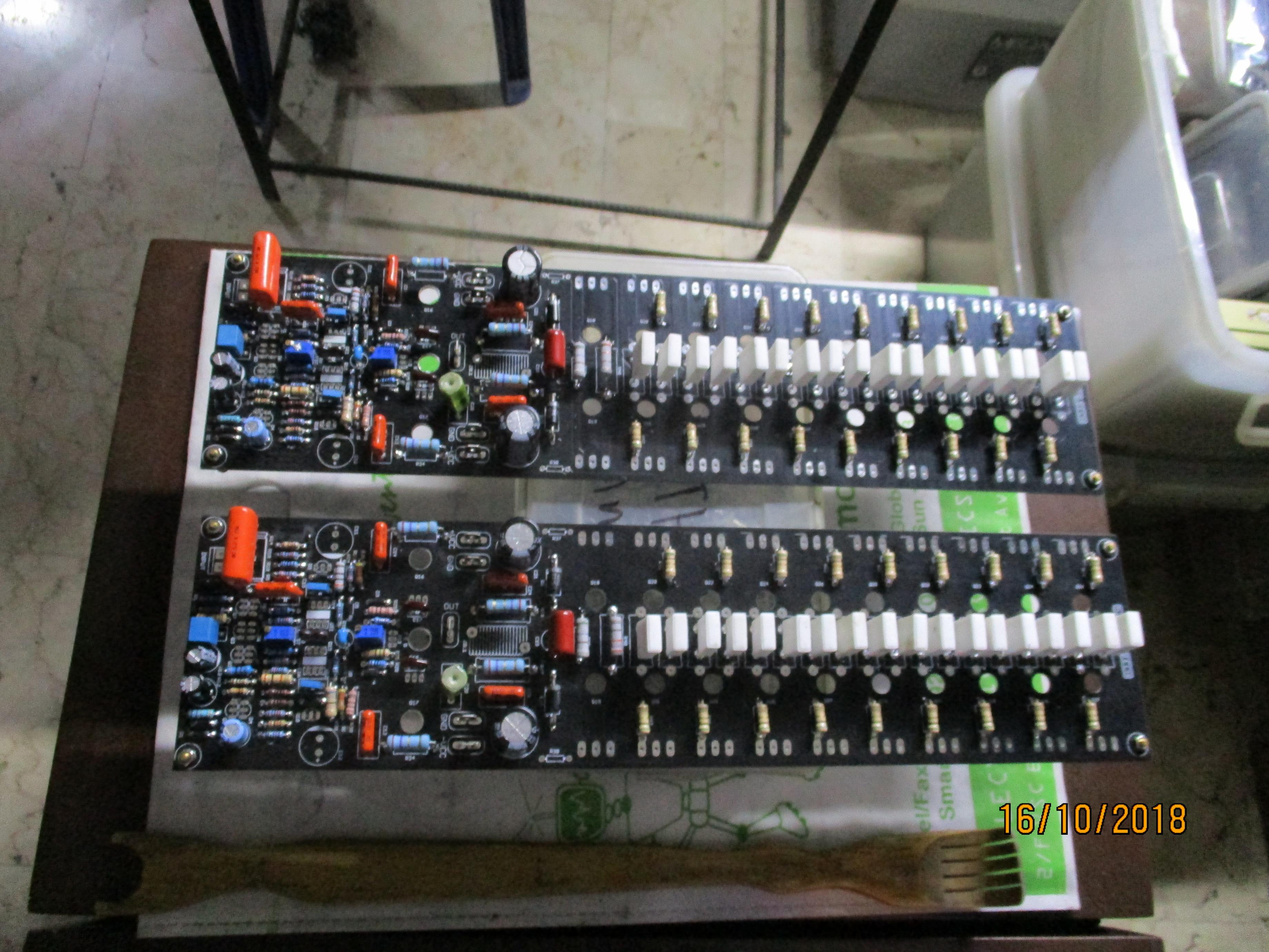

Build guide was made follow it. Go to a friend with oscilloscope, signal generator, you'll figure it out. Or a shop with gear, show them the build guide. To get a second opinion. Or goto a academy they probably do repair jobs. As a did.Build guide was made follow it. Go to a friend with oscilloscope, signal generator, you'll figure it out.
Use ltspice too after all it's a proven design you'll master it pretty quick. I'm not sure if the designer was a licensed ltspice user ask variac. As you propablly know without a certified license, simulation is likely to go wrong.
But I thrust you are a handy guy with time. Put pcb traces + power supply in simulation to get better results real results.
EITHER WAY enjoy the amp.
ROCK 5.8mV / 26.36mA on the one transistor, inspect that one I suggest.
Might be one of the reason the bias jumps suddenly.
Pot trimmer is useful, don't use a screwdriver that grounds you at same time.
Try to turn pot slightly, is the difference bigger in %
on the 5.8mV vs the rest output transistors.
Matching transistors, many don't on this topic, issues on that elsewhere.

I actually bought some HB boards a few weeks ago and was planning on getting started on this build. Just last night I just got my hands on cheap and broken Sony TA-N80ES.
Should I fix and do a complete recap on the Sony or continue with the HB build? Is the HB and better performing amplifier? I supposed I can do both, fix the Sony and build the HB but one of those projects would have to be put on the back-burner for a while. For now I'd like to work on the project that will give me the best performance.

The HoneyBadger is a very good amp. I have no experience with that Sony, but I would be surprised if it would come close to a well built HoneyBadger. I'd suggest to give birth to the HoneyBadger first.
