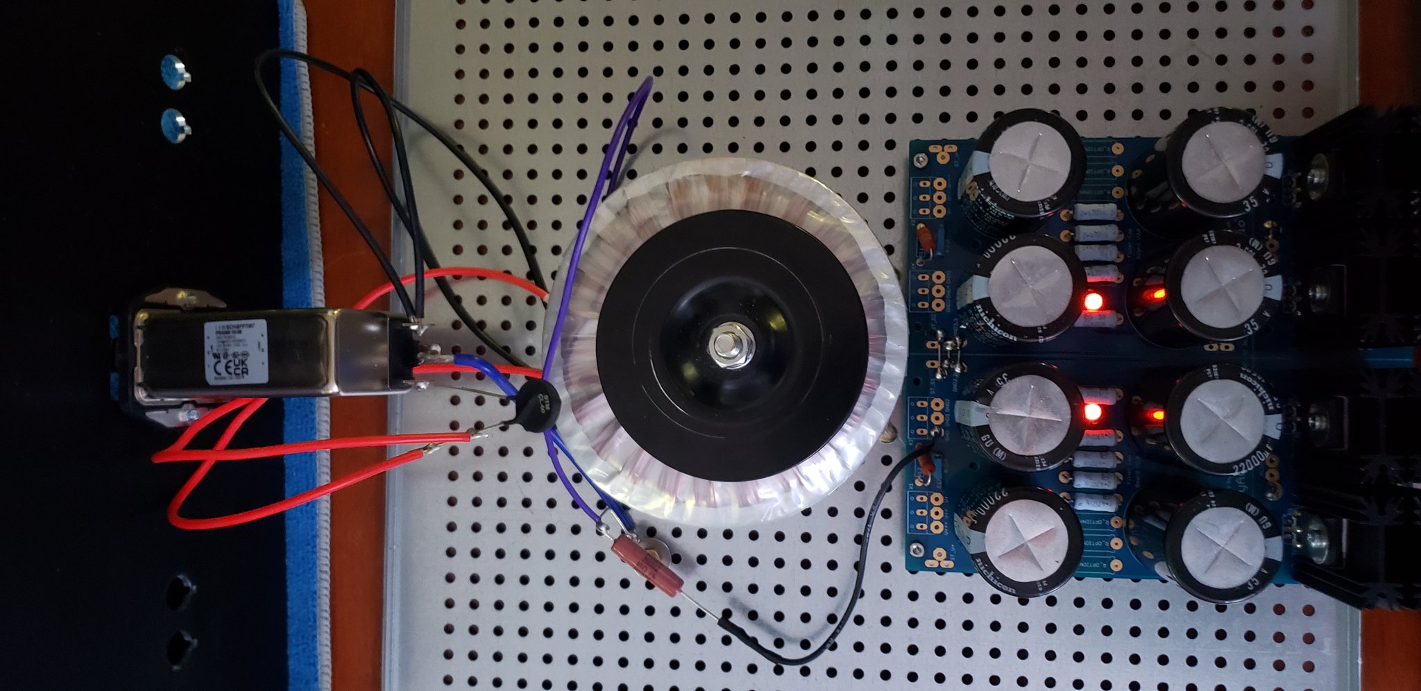

so now, understanding both primaries will need to have inrush protection by the CL60, what i could do is use one CL60 bridged between the IEC hot and both of the red primaries. This would satisfy inrush protection for RED(1, 2) and BLACK(1, 2) primaries, correct?
https://www.diyaudio.com/community/threads/a-guide-to-building-the-pass-f4-amplifier.234355/
That would restrict both primaries more than using two CL-60s. A single CL-60 is rated for 5 amps and your F4 amp should use around 1 1/2 amps so there shouldn't be an issue with it being overloaded. I would order another CL60 if you don't already have it and install it. You can use the amp in the meantime with just one.
Another option it to use a 3-watt 10 ohm resistor from your power supply ground to the chassis ground instead of a CL-60. Maybe that will free one up so you can use it on the primaries in the off chance that you already have the part.
Measure the voltage after the CL60 from the mains power and check the temperature of it. So long as things aren't getting too hot or the voltage isn't dropping, you should be fine.
So long story short, Running the mains hot through a single CL-60 and then to the red leads of both your primaries won't kill the amp and will make for an interesting experiment.

I am actually building an Aleph J, that information was lost in the forms a few posts back haha. The aleph J works at 1.7 amps per channel so i should still be ok.
I do have a few CL60's in the mail that i should be getting later this week. I just so happen to have a couple 10ohm resistors that i can use for the power supply ground.

Very nice. Those voltages are with no load. Still, progress. They will drop when you have a load on them. The DC voltage will come down a bit after you install the amps and start to bias them up. The mains might also with the one CL-60.
Also, it is best to put the transformer towards the front of the chassis. Your signal wires etc are in the back so you want to keep all of that stuff away from the transformer.

Cant wait to get the amp boards up and running! currently delayed, waiting on my cable shipment. I will continue to monitor the solo CL60 situation, i do have more on the way so, easy fix if it shows problematic. If not, less is more in my book. I think i will be keeping that 10ohm resistor on the ground. Definitely not just because i like looking at Vishay resistors, haha.
Thats a good point, transformer separation from the signal wires. This layout was influenced by another builder who valued shortest path possible, i think there's value in that. Anyways, i do need to find solution for better separation between transformer and signal wires. This is a 5u chassis, it filled up pretty quickly on that center axis. The IEC i chose may have taken up more real-estate than its worth.

The 10ohm resistor to ground cannot flow all the fault current if there is a big issue, where a CL-60 can. Please replace it as soon as you are done testing. Our use a big diode bridge wired as a groundbreaker.
Please do not put wires through holes in metal without a rubber grommet protecting the wire.
The single CL-60 on the primary might work, but you’ll have to monitor the temp under load. It’s going to get VERY hot, check datasheet for acceptable operating temps. The current mounting scheme and connections to the primary are not acceptable for anything other than testing the PSU, and even then having that much exposed bare conductor is simply dangerous.

Yes, generally speaking it’s going to be quieter if you have the transformer at the front of the chassis.
If you run out of room, you can mount the transformer and filter board asymmetrically… it will work just fine. Also vertical mounting the transformer frees up a lot of room, that is also a good option.
