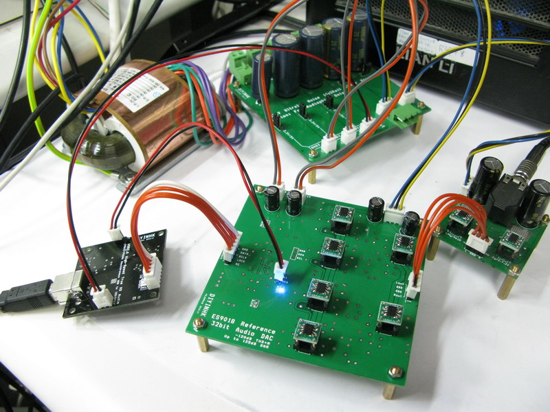

ES9018 32bit Audio DAC kit USD99.95
The lowest cost ES9018 32bit Audio DAC kit is finally here
I received many PM asking about when will it be release,
I decide to release the final beta to the public, it is tested to work with our USB to I2S for ES9018 PCB.
All component are layout with hybrid soldering pads for thru-hole and SMT component to increase diyer flexibility.
The oscillator pads is universal, it fits 7050 5032 and Crystek CCHD950 footprint. It also has enable pin for diyer to choose synchronous or asynchronous operation easily.
The PCB runs in hardware mode(default), it also has SDA SCL routed out for Diyer to change the es9018 register if needed.
The schematic and BOM is printed directly on the PCB for diyer easier to assembly.

Hi diyinhk,
Congratulations! I like the fact that there are through holes in the pads.
Looks like you have a digital input power line for the digital 3.3v which also powers the 1.2v, and a separate 3.3 line for AVCC.
What is the circuitry next to the AVCC power line?
Some initial suggestions:
1- Separate the D2, D3, D4 and D5 lines in order to support DSD
2- Add some pads to take the balanced output straight from the DAC
3- Add some pads to take the balanced output before the conversion to single ended output
4- Add a pad for U.FL connector for the clock input.

It would be great if the following features are available, I would be in for 4 or maybe 6 boards depending on assembled price.
(1) Correct implementation of digital volume control ie no resolution loss in the upper 75% or so of the volume control range.
(2) Flexability in choice of output stages
(3) Ease of bypassing on board regulators to allowvarious LiPo4 battery power.
(4) High quality mini UFL ( as per Quisp suggestions) connectors or pads where possible.

Nice one !!
Interested as well at least in one, but might have a few friends that might jump on board with a few orders.
Also wondering about future plans on a 8Ch balanced version ??
Agreed!
However, I would like to see more UFL connectors for I2S input, specially for SD, WS and SCK.

Thank you for all member suggestion,
The v2 pcb is ready, more thru hole component compatible soldering pads,
it's still default to I2S input^^ for easily to most of the people, but dsd user can use cutter to cut the trace and use d2-d5 seperately much more easily.
The source rises ES9018 chip priceT_T and the v2 pcb includes adp151 ultralow noise regulator pre-soldered for more friendly to thru hole diyer. Hopefully, the initial target price below 100 is still achieved^^ Actually, the source sudden reduce ES9018 price in the early of this month but rise again, if people also follows our cm6631 usb to i2s for es9018 pcb thread should know.

It's great to see you develop this in response to people's ideas. Any pictures of version 2 ?
Great work - US$100 is a good price - most of the other ES9018 DACS are several hundred dollars.
I also see you have some other modules - headphone amp, etc - are you planning to sell these too ?

most of other es9018 dacs have all the parts soldered/included too and 4 layer PCBs, so not sure its a valid comparison. its cool there is a low cost option for people who want to start from scratch, but when you add everything up including decent power supplies for the analogue sections and clock, I wonder how much cheaper it will be. I bought my AKD12Ps on teflon board with only ESS dac soldered for $130. its unfortunately nolonger available that way. it ended up costing me more to stuff it myself, because parts are bought in smaller numbers.
or are all the parts included? my apologies if thats the case, it just seems unlikely with crystek clock
its hard to tell, is this really a single layer PCB?
Let's remember that this is a $89 board. Suggest things that cost near nothing to implement
Here is another suggestion:
Split AVCC in two: one for right dacs and one for left dacs. One can experiment TL431 shunts but those are limited to 100 mA

Balanced Outputs instead of the summed

From the pics, I think v1 is double layer. I haven't seen v2 - pics please !
Double layer is fine - it's the routing/layout/vias/etc that really matters.
$90 vs $130 is almost 50% more; the Crystek is US$30; so even with a Crystek, it's still cheaper; $120 with Crystek vs $130 without. So I don't understand why you are complaining. Maybe you're just concerned that lower price = lower quality ? Gotta wait and see for that.
Actually, I think most ESS dacs are a little overpriced - in this part of the world you can get a dual AD1955 with 384Khz input from an FPGA asrc, for US$150, fully built and tested, with six opa627 etc etc. And it sounds great with a Crystek CCHD-957.
However, I want to try an ES9018 to see if it's been over-hyped (or not), and that NDA/datasheet nonsense was simply a way of making it seem like it was super-secret tech (or really was necessary for some reason). So a low priced board like this is definitely interesting.
So anyway, I'd really like to see some pics of the V2... please ?
