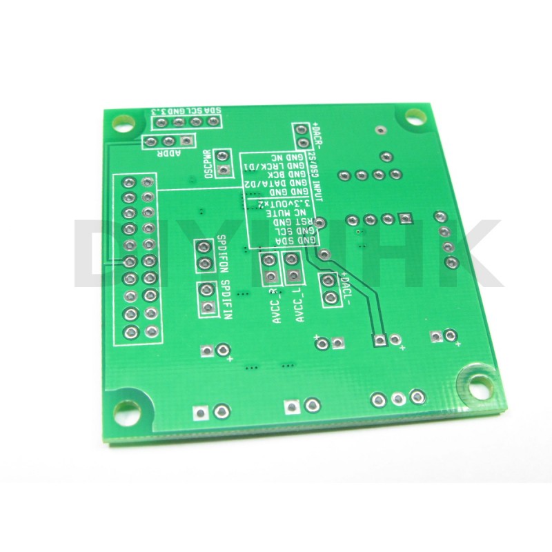

To be precise, where do I find GND pins to use with +DACR- and +DACL- outputs ?

I have been trying hard to track down more information about SPDIF connections of this board, but to no avail. So I ask my question here.
According to hifiduino the es9108k2m offers two SPDIF inputs. But the board only seems to offer one SPDIF connection: image and description by hifiduino (middle of the page)
Could someone (diyinhk?) please confirm, if a second SPDIF input is possible with this board and if yes - how/where to connect it?

Hi
I am very tempted to order the full DAC (DAC, USB receiver and power supplies) but I also need to be certain if I can connect simultaneously the USB receiver and a Toslink input.
On the DIYINHK website is stated that the input labeled "SPDIF IN" can be used to directly connect a SPDIF optical receiver(Toshiba TORX147 or equivalent).
However the pictures published on the DIYINHK-website are not clear in this regard. I think the picture of the backside of the board does not conform with the picture of the upside, and I also cannot see how the Toslink could be directly connected to the DAC-board.

Hi
I received good and clearcut answers from DIYINHK. I must say from my first contacts with them that their support and service look very good.
From their information I deduce the following.
You should look at the 4th image of the DAC-board product description on the DIYINHK-website.
The SPDIF-IN has two connection holes. The round one is for the output signal and the square one is for ground. For optical input one should use a Toslink input connection TORX147. The TORX147 has an output pin, a ground pin and a 3,3V supply pin. According to the torx147 official datasheet, a 0.1 uf decoupling cap is needed on the torx147 3.3v supply pin and the ground pin.
By default the board works with I2S. But if you make a connection between the two pin-holes SPDIF-ON it will switch from I2S to SPDIF. You can install a jumper on the board to switch between I2S and SPDIF, or you can make from the SPDIF-ON connections onwards a switch on your DAC case to switch between I2S and SPDIF.
Therefore the DAC-board can receive an optical input directly and be connected with USB through a receiver. If one wants to use the Toslink/SPDIF, one will have to switch from I2S to SPDIF.

The 9018k2m has differential (balanced.) output.
DIYINHK use an I/V converter with SE output, actually this is an bal/SE converter I/V stage.
Don't use an another converter to make differential output again!

In both versions I took balanced out from the dac. '+' and '-' for each bal. channel are noted on the PCB (DACL and DACR) and I took GND from GND pin of the +-12V power supply.
Later I took GND from 3.3V power supply, the one that powers DAC's analog output (it is the middle connector on the PCB) http://www.diyinhk.com/shop/250-thickbox_default/usb-dsd-dxd-384khz-dac-with-bit-perfect-volume-control-and-spdif-inputxmoses9018k2m.jpg
In both verions first make sure to unplug the OP amp from the socket, just to make sure. I think that taking the GND from 3.3V analog power supply works better.
