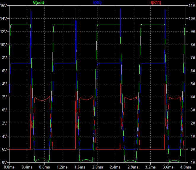

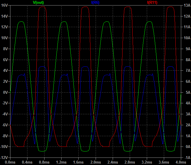

I also found inherent destructive cross conduction problem for input signals larger than 3V in my simulation. I suggest some kind of input over voltage protection.
Please edit and state these limitations on post #1 before too many people use other supply voltage or large input signal that will destroy the output mosfets and kill the speakers.

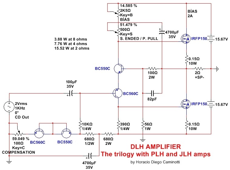

I make this clarification again: the DLH was developed as it was presented bearing in mind as many quality premises as possible. The input signal that was anticipated was the one that can deliver the output of a typical CD player (2 V RMS).
Whoever needs to adapt it to build it with other values of available elements, can do it perfectly, but will have to recalculate it without losing quality as its main objective. It is not impossible, but whoever has to do it will have to resort to his own abilities.
As a simple data when analyzing the scheme of post 1: assuming that both values of Vgs are similar, the potential difference between the collectors of the BJTs is equal to that of a single rail (around 15.67 V). The rest of the voltage (the other 15.67 V) are distributed proportionally between the two trimpots and the fixed resistance of 390 ohms. From that situation, we can predict the collector current of any of the BJTs, since they are extremely very similar. From then on, all calculations and possible considerations could be reconsidered. All exposed is with short-circuited signal input.

Yes Diego, but CDs are disappearing. I think you are also aware that DACs with 3V RMS output are incrasingly being offered. These would be fatal when used by DLH users due to the inherent cross conduction on large input signal without any input limiter. You can save the DLH from being destroyed by publishing clear limitation and limiter as preventive countermeasure.... I make this clarification again: the DLH was developed as it was presented bearing in mind as many quality premises as possible. The input signal that was anticipated was the one that can deliver the output of a typical CD player (2 V RMS)....
if it is necessary to adapt it for a DAC output of up to 3 V RMS, simply increase the resistor from 56 ohms to 120 ohms (in the feedback network). A much more simple and better solution than any input limiter, from many aspects. A very slight adjustment of BIAS and OFFSET may be necessary.

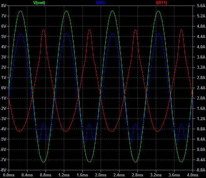

As designed, my simulation show cross conduction at ~8V peak output corresponding to >2V RMS (2.83V peak) input. Will happen at lower input signal if gain is increased, or higher input signal if the gain is decreased as Diego explained above. A point I think DLH users need to clearly understand.
Attached are simulation results showing output voltage and current through the 0.15 ohm source resistors at input voltage 3V and 5.66V peak into a 2 ohm load. I think some kind of input limiter is a good insurance to avert potentialy fatal result when the DLH is being used with a source with high voltage output like the 40V capable Aksa Lender preamp.
However, cross conduction behavior of the DLH Buffer is more benign. Last attachment show that the DLH Buffer has the potential to survive occasional 40V peak input without any limiter.

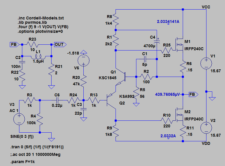

It would be interesting to indicate the scheme that has been simulated and under what type of adjustments the offset, bias and mode of operation of the output have been set, in order to analyze the exposed results.
I can do better Diego, I attach the Ltspice circuit I use. But simulation has little value to you with working unit, direct measurement is always the best.It would be interesting to indicate the scheme that has been simulated...

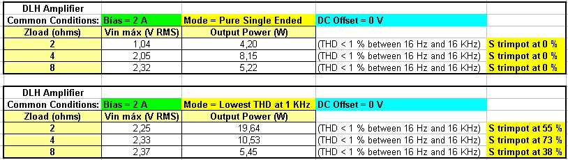

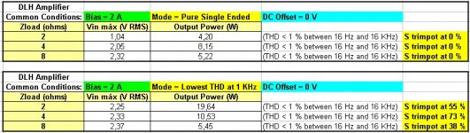

I upload a box of limitations referring to the version shown below. I hope it will be useful to clarify your doubts. Keep in mind that depending on the settings of the trimpots for DC Offset, the operating mode chosen for the output (SE / PP), Bias, the value of the load and the voltage of the power supply, certain limitations may appear (limitations that also exist in the PLH, for example).
If you need to operate the DLH from the output of a DAC with voltages greater than the maximum 2 V RMS, it may be necessary to decrease the closed loop gain in the same rate of increase of input signal over the reference of 2 V RMS. With 3 V RMS, for example, increase the 56 ohms x 1 W resistor of the feedback path to 120 ohms x 0,5 W.
Note that using a typical CD signal, you could adjust with almost the majority of the load options (except for 2 ohms operating in pure single ended). The mosfets would operate within their safe limits.
