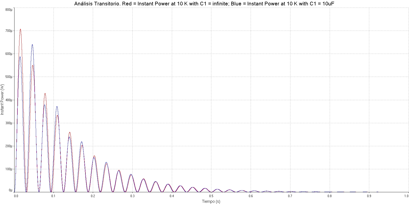

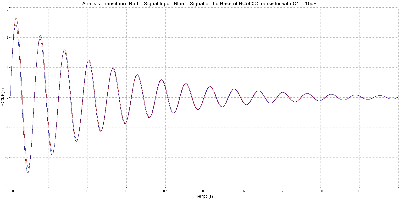

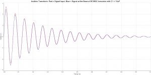

Regarding C1, I must say that everyone has the freedom to install the one that seems most convenient to their needs. In my opinion, I have dimensioned that great value for the maintenance of low levels of THD at low frequency and to maintain similar energy profiles corresponding to a low frequency damped signal (signal that could correspond to a kick of a bass drum, for example) . Comparing between the two values for C1 (between 10 uF and 4700 uF, for example), we see that the envelope profile of the decreasing amplitude of the damped signal changes. But what is most disturbed is the envelope of the instantaneous energy that reaches the base terminal of the BC560C. The envelope takes on an entirely different profile. As the signal frequency increases, the profile tends to resemble that of the original signal.
That is my criterion for selecting the value of C1. I totally respect the criteria of whoever wants to adopt another minor value.

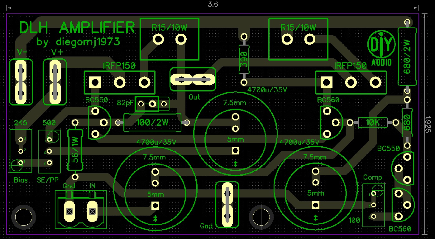

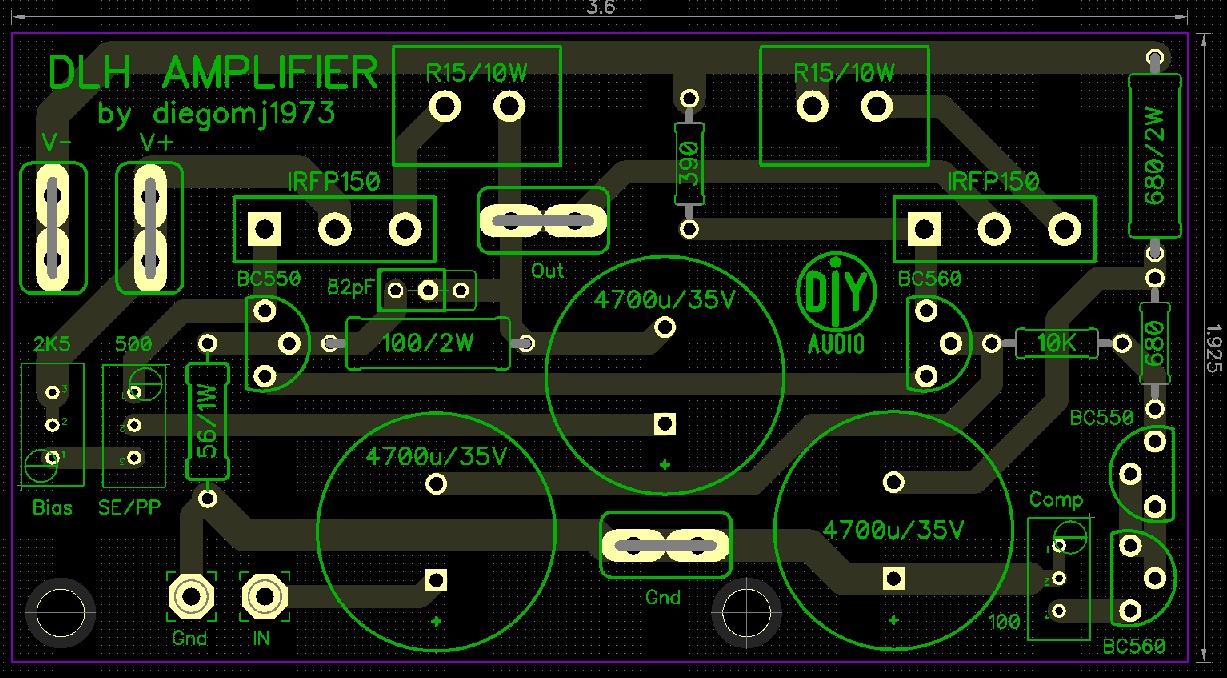

As soon as I get home I'll post a pdf and gerber files. I'll also add 5mm lead spacing for the three caps.

On your profile above you are comparing power vs volts. Can you plot both as power? I believe they should be similar assuming the base of the transistor doesn't have a low impedance.
I'm so glad you understood the difference.
The second graph is well revealing of the difference in the envelope, between employing a low capacitor value for signal passage and employing a high capacitor value for the same function.
Electrically, there are differences. I think, psychoacustically could be perceived as well
Best regards
Best regards
Well done all of you guys that contributed, the turn-around was extreme and the outcome exemplary. I will be putting it together in the next few days as I have become a low power class A nut. Unfortunately I cannot work at the pace of XRK971 but I will give it my best shot. Thanks for sharing diegomj1973, XRK971 thanks for confirming and Ripcord, the PCB is so elegantly simple.
