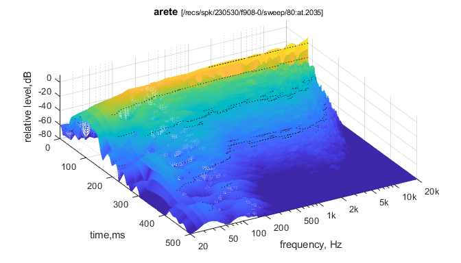

It is based on FSAF (Fast Subband Adaptive Filtering) which is a 21st-century version of Welch tfe(). You can transform a full-band RIR into sub-band, back and forth, with NPR for any prescribed precision (-120dB reconstruction error is trivial). It takes much less MIPS re full band (which requires 2 hours to process 1 sec of recordings). By splitting the space, it can lower Fisher's matrix eigenvalue spread from 10^15 down to 10^4. I use single-model one-pass ReLS and full-band final filtering to avoid matching too well - otherwise, I would miss the dynamic instabilities of a driver.But I AM interested in your AEC measurement. Could you at least give me a hint of what it is? I'm spent most of my previous life dreaming up 'advanced' measurements and trying to correlate them to good sounding speakers.
So far, the best results (closest to the music) I achieved by using a modulated noise as excitation and examining the residual.
1. AWGN
2. shape it frequency-wise to approximate rock music (Queen's Dust in my example)
3. Modulate the amplitude
0-3 sec - nominal (I use -25 dBFS)
3-4 sec - nominal +10dB
4-8 sec - nominal -10dB
8-9 sec - nominal +5dB
9-12 sec - nominal -5dB
12-15 sec - back to nominal
I would say that the number of false positives (spk shows good numbers while it is not on real music) and false negatives (spk shows bad numbers while it is not) is much lower than for sine sweep, where correct answers and false positive/negatives are uniformly distributed, I have 2 | 3 dozens of speakers, which is not awfully representative.

- It ISN'T about Acoustic Echo Cancellation ie not about making pseudo anechoic measurements but about speakers that might respond well to this
- shaped noise signal is ramped up in level and then down.
- Measurement mike & low distortion LDC mike both in front of the DUT. Measurement mike used to 'flatten' LDC on-axis response ie correct 'linear' distortions with simple DSP
- Signal from da LDC 'de-convolved' with the 'input signal' using fancy new supa fast FFT methods
- Residual is presented in 'time-frequency' display to show how LTI varies with level
- Residual can also be listened to
NPR - Yes.
ReLS - Start with https://www.researchgate.net/publication/330853444_A_Shift_in_Paradigm_for_System_Identification .
Naive summary - correct. Without LDC, only by a typical measurement mic like Behringer ECM8000 you won't get > 50dB of dynamic range, which is a joke and a source of dystopian arguments.
BTW, you can get a kind of pseudo-anechoic measurement while selecting the very top of the ridge of the RIR
... (room impulse response) spectrogram (wavelet-ish). It works for well-damped closed boxes just fine but it is somewhat tricky to separate a vented box and a room. It does not matter how you get RIR.

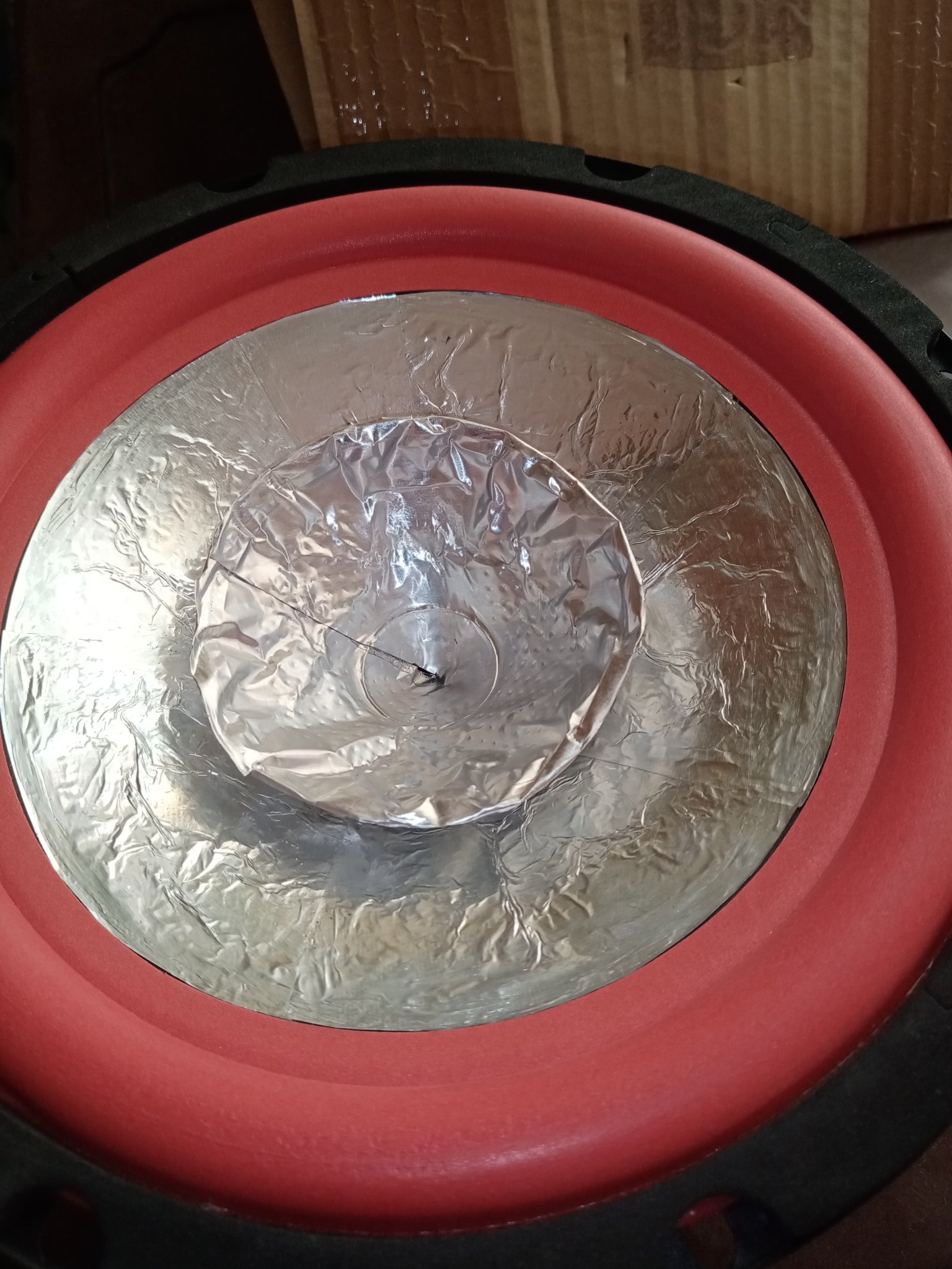

Honestly I do not take care too much of measurements.
With my DIY mods I change the characteristics of the (paper) cone, put a Faraday ring onto the pole plate and make even a whizzer by hand.
Only measured once frequency response to check if this cheapo driver can be converted to a fullrange driver or not.
https://www.diyaudio.com/community/threads/how-to-make-a-whizzer-cone.398063/post-7510218
https://www.diyaudio.com/community/...loudspeaker-sandwich-cone.402917/post-7443476
https://www.diyaudio.com/community/threads/how-to-diy-add-a-faraday-ring-to-a-loudspeaker.409852/
Then the EQ on my Fiio X1 or smartphone can correct roughly the response to desire. Additionally a transconductance amp can help for distortion and frequency response.

With all the mods you can DIY - also adding extra same size magnets giving a plus of maybe 1.5db efficiency I tell friends asking for advice for throwing out standard loudspeakers in cars and putting new ones in that the original ones are not bad if you tweak them.
But I understand that many people do not know how to change / modify original drivers or fear the investment of time to apply the changes.
