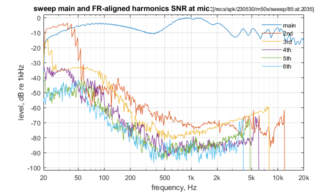

Headphones: Audiotechnika M50x and up, in the same or above class from AKG, Bayer, Sony, Focal, Sehn. They all sound approximately the same, it is not easy to tell them apart while blind-testing them. They measure pretty well except that FR is not (scientifically speaking) measurable because it heavily depends on the pressing force, location, and skin. The LTI distortions (energy-wise) in mid-range are < -80dB, very smooth, with no Barkhausen noise, and nothing to offend your ear.So what are ‘good studio headphones’ if you care to share…..what makes them ‘good’?
How do you know the primary fault was the speaker system?……could the distortion come from the amplifier?…..too much input stage gain creating clipping?……not hard with todays digital input streams without a viable reference beyond LuFS.
yes….microphones will NEVER completely represent a live grand piano experience….the best of the best engineers know all they can do is capture what sounds best to them in the moment. Adding room mics helps but again, never to replicate what your ears experienced live………remember…..your outer ear is a very complex bio engineered waveguide…..no such apparatus on condensor mics……….just a capsule with a polar pattern.
Piano is extremely dynamic……and to process it, it requires dynamic compression…….which through limiting adds distortion……very frequency dependent…….hard to blame a ‘speaker’ over a headphone ‘speaker’ without considering the response ……maybe the headphone has a deep null at 6.3k surpressing the objectionable distortion where the speaker is more linear in that range…..again….no real reference.
The guys who design these headphones say that despite their high cost ($250 and up) these are sold well below cost because the amount of their R&D is simply insane while the sales volume is miserable.
