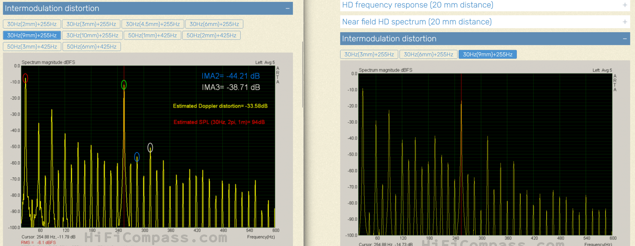

Here's an example of distortion, here in the vocal track, especially noticeable as things warm up at around the late 30s seconds in.Pages and pages and I still concur.
Angelo's method measures response & THD to a given accuracy in the theoretically shortest possible time. That's why I developed the theory & code about a decade before him. I wanted it for factory test but at the time, the computing power (and more significantly, good A/Ds) were too $$$ as I wanted loads."[...] Although much, much slower than a log sweep the stepped sine measurement can measure low distortion levels much more accurately than a sweep [...]"
[https://www.roomeqwizard.com/help/help_en-GB/html/graph_distortion.html]

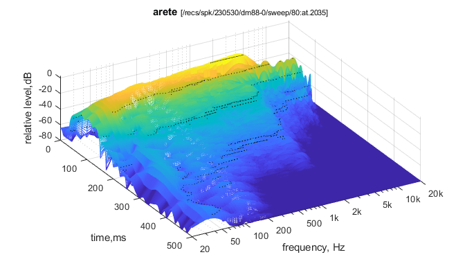

At last! A 'waterfall'. Deleted 10 pages of why 'waterfalls' aka KEF CDS aka KEFplots are rubbish
OK! I'm biased. 'Waterfalls' are probably the most important measurement done these days that relate to how things sound. But the correct interpretation of 'waterfalls' is sadly lacking .. let alone for Wigners, cepstrums and other high falutin buzzwords.
JA at Stereophile has probably looked at more 'waterfall's than anyone alive. But I once spent an hour or two over several pints explaining to him the difference between our PAFplots & da KEFplots and also how to interpret them. eg the CDS of a good sounding paper cone is very different from that for a good sounding plastic cone.

Could anyone explain to me why a waterfall (Integrated RIR Gabor transform) is better than a simple spectrogram of RIR? Although I prefer wavelets, and yes, I use them as variable-length windowing skim,

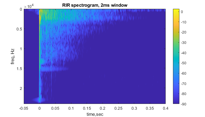

Waz iz 'simple spectrogram of RIR'? Can you post an example? You must excuse my ignorance of Gabor & other buzzwords.Could anyone explain to me why a waterfall (Integrated RIR Gabor transform) is better than a simple spectrogram of RIR?
AFAIK, all da 'waterfalls', wavelets, ceptstrums, Wigner stuff are operations on an 'anechoic' or quasi anechoic https://www.aes.org/e-lib/browse.cfm?elib=12875 IR so dunno about Room Impulse Response.
Not sure how you deduce that. Angelo's method has theoretically the best rejection of other stuff including noise bursts.BTW, Farina aka old good Chirp does not provide you with error bounds estimates and is overly sensitive to noise bursts.
I've made good measurements with background noise so loud I couldn't hear someone speaking nearby. One such occasion was when Angelo visited Cooktown, the Centre of the Universe, and brought presents.
Here is a 'typical' spectrogram of RIR (dB scaled) which is a convolution of anechoic IR of spk and the room (here, my living room with half of foam off):
It is kind of hard to get anechoic measurements for DIY. I know what it is but not sure why mention them if you can't get them? Instead, I use observable data and pick the top of the ridge on wavelet sgram as spk:
Dennis Gabor was the first guy who invented Short Term Fourier Analysis back in 1940s (he used Gauss window only then). https://en.wikipedia.org/wiki/Dennis_Gabor
I deduced my conclusions from the theory of System Identification, like in L. Ljung https://www.oreilly.com/library/view/system-identification-theory/9780132441933/ It is somewhat accepted that Least Squares are considered the Best Linear Unbiased Estimator (BLUE) in p=2 sense. The convolution methods like chirp, MLS and perfect sequences are much less computationally intensive but to pronounce them 'The Best' could be a bit contradictory to the current state of science as we know it.
Particulary, Chirp errs at low frequencies where both noise and non-linear distortions are at their worst.
