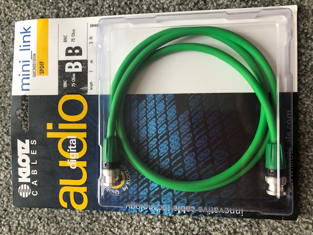

My very best experience till now is THE most flexible (as in: absurdly flexible) cable from Klotz combined with excellent Neutrik silver plated connectors. A tad short but very good performance. These cables cost less than the connectors when bought separately 🙂 When combined with Neutrik NBB 75 Ohm chassis mount connectors a very good combo with regards to both price and performance. That is when one wants highest performance as main parameter for acceptable prices. When I look at the color I imagine I made the world a tad greener.

Lo and behold, the ultra flexible Klotz 75 Ohm cable also exists in nice blue that goes well with the blue LEDs 🙂 Check those connectors by Neutrik. Silver AND gold and the best system for coax SPDIF all together, boy oh boy.
The 1 meter version is called: SWCN0010BL

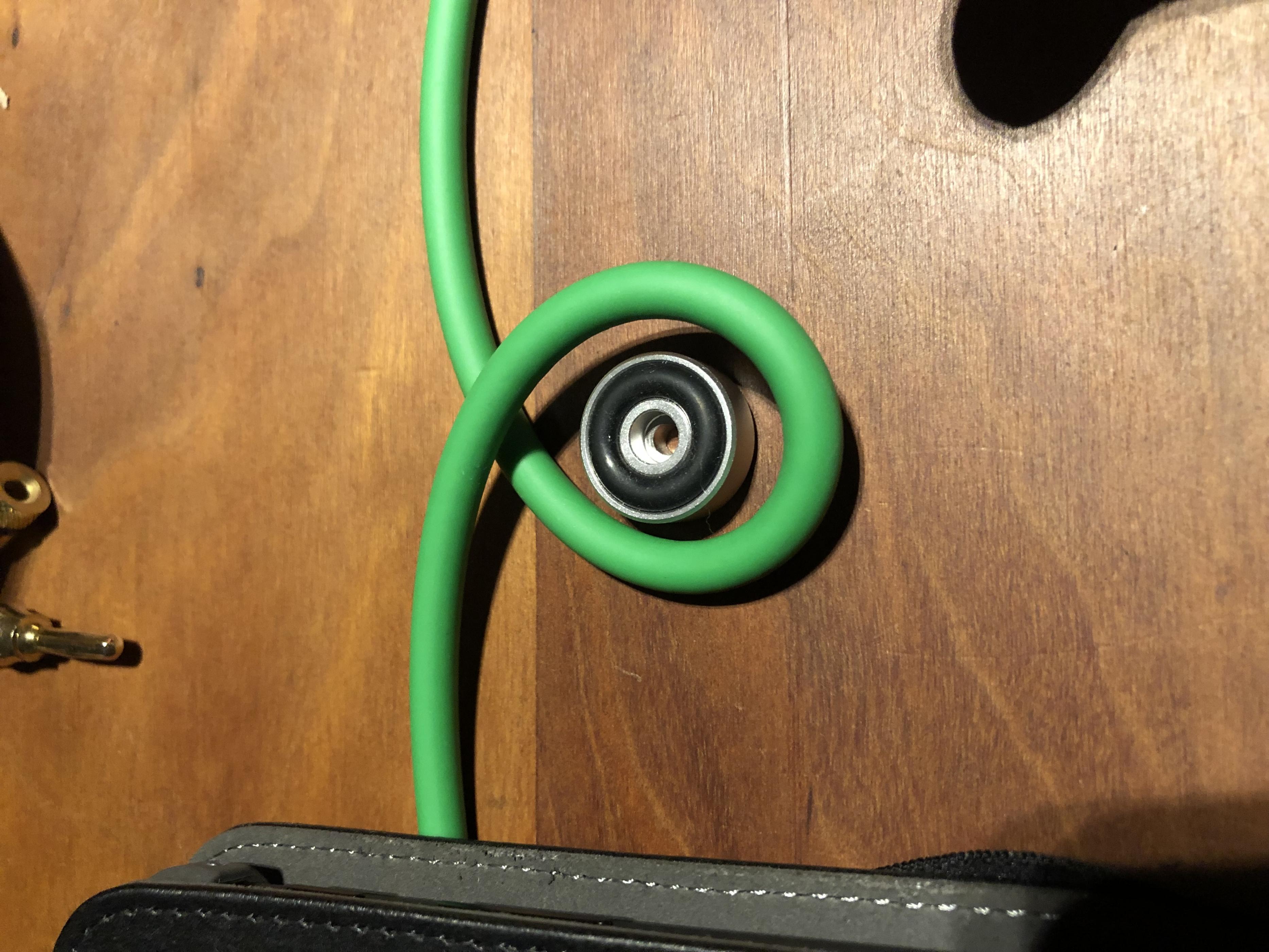

This is the Klotz cable. The aluminium equipment foot is 20 mm diameter. The Klotz cable is 6 mm which is unusual as the thinner (4 mm like RG179) cables are often more flexible. Not in this case.
