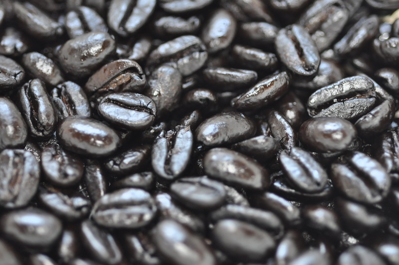

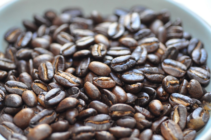

My 2nd 4oz roast. Pulled off the fire just into the second crack.
Congrats on the first two batches! The second one looks great, but I personally would consider the first batch "burnt".
It's worth letting both rest, and trying both as a learning experience.
I really like the caramelized sweetness of a darker roast (like your second batch) but I'm not a big fan of the charcoal profile of the very dark roasts (like your first batch). Others are into that though, so to each his own.
On the other end of the spectrum, if you end just after first crack, you get a pretty grassy cup that can also get pretty unpleasant, like eating an unripened avocado.
The best part of roasting is that you can dial in what you like for each varietal and roast to that level!
Best of luck and keep up the good work
