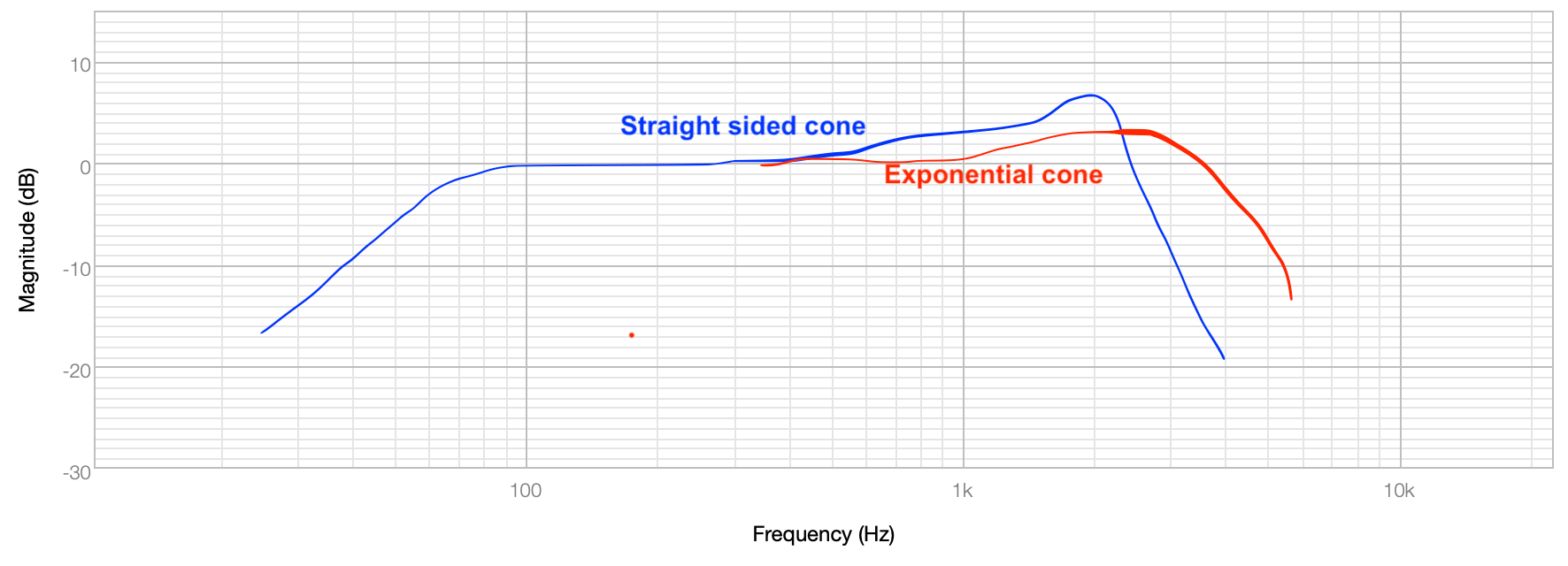

A straight sided "perfectly conical" cone (blue curve above) has the most piston-like behavior and has a rising response which peaks, and then drops off immediately. Because it's the most piston-like, it has lower distortion. The deeper the cone, the more piston-like it is. It's most often used in subwoofers. The radiation pattern is more beamy in the upper end of the range.
A flared "exponential" cone (red curve above) has a more gradual transition from passband to stopband and greater bandwidth. It has higher distortion because it's more flexible, but its breakup modes are more evenly distributed. This gives it more high frequency extension. It's usually easier to design a crossover for an exponential cone because the peak followed by the sudden cutoff of the straight sided cone is difficult to deal with. The radiation pattern is less beamy in the upper end of the range. It's the most common type of cone for speakers that cover the midrange.
I'm not certain that the term "curvilinear" has an exact definition. I think it usually means exponential, which means the flare is steepest near the voice coil and gradually flattens out near the outer edge.
