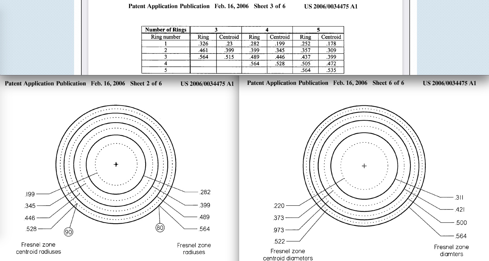

with the advancement of 3D printers, I have been looking into printing the phase plug disclosed in Dr. Geddes' patent application 2004/0034475.
As I understand it, a Fresnel zone centroid is projected on the diaphragm. However, although the application gives examples for 3, 4, and 5 ring phase plug, as best understood, this is only for a 1 inch driver, as the largest centroid is 0.973.
I am familiar with Fresnel zones pertaining to radio frequency, wherein the calculation of the zones depends on the distance between the source and the destination. As such, I do not understand, how to (re)calcualte for different diameters.
Any insight would be appreciated.

The centroid diameter of 0.973 appears to be a typographical error, a "9" rather than "4".
The outer ring for 3, 4 and 5 zone units is specified as 0.564.
The Summary Of The Invention (0013) states:
"In the Fresnel zone concept, each zone is of equal area. The number of zones is arbitrary except that there should be the same number at the diaphragm and the exit aperture and there are the same number of concentric annulus channels as Fresnel zones"
(0014) states:
"Usually, the phase plugs exit aperture is identical to the waveguides throat, or entrance.."
As I read the above, the actual diameter of the throat makes no difference (within reason) to the phase plug design, as long as each Fresnel zone is of equal area.

Hi Art,
first of all, thank you for the reply. I do understand what the disclosure says, but apparently I am not sure, how to interpret it, to make sure that my interpretation and resulting calculation agrees with the disclosure. Are you saying the the numbers are relative and could be scaled?
I am biased by my knowledge of RF, wherein the radius of the Fresnel zone (at its widest point) is a function of distance between a source and a sink and frequency of the transmission.
Do you know of any paper relevant to acoustics?
I all fails, I will try to contact Dr. Geddes.

In the patent the numbers were all normalized to a radius of 1. The best discussion of phase plugs can be seen at Acoustic horn design. The information there would be a better approach to phase plug design than my patent, which is 20 years old now.
That said, we did 3D print a phase plug and in that particular situation it did not make much difference. Would a more modern one work better, I don't know.
