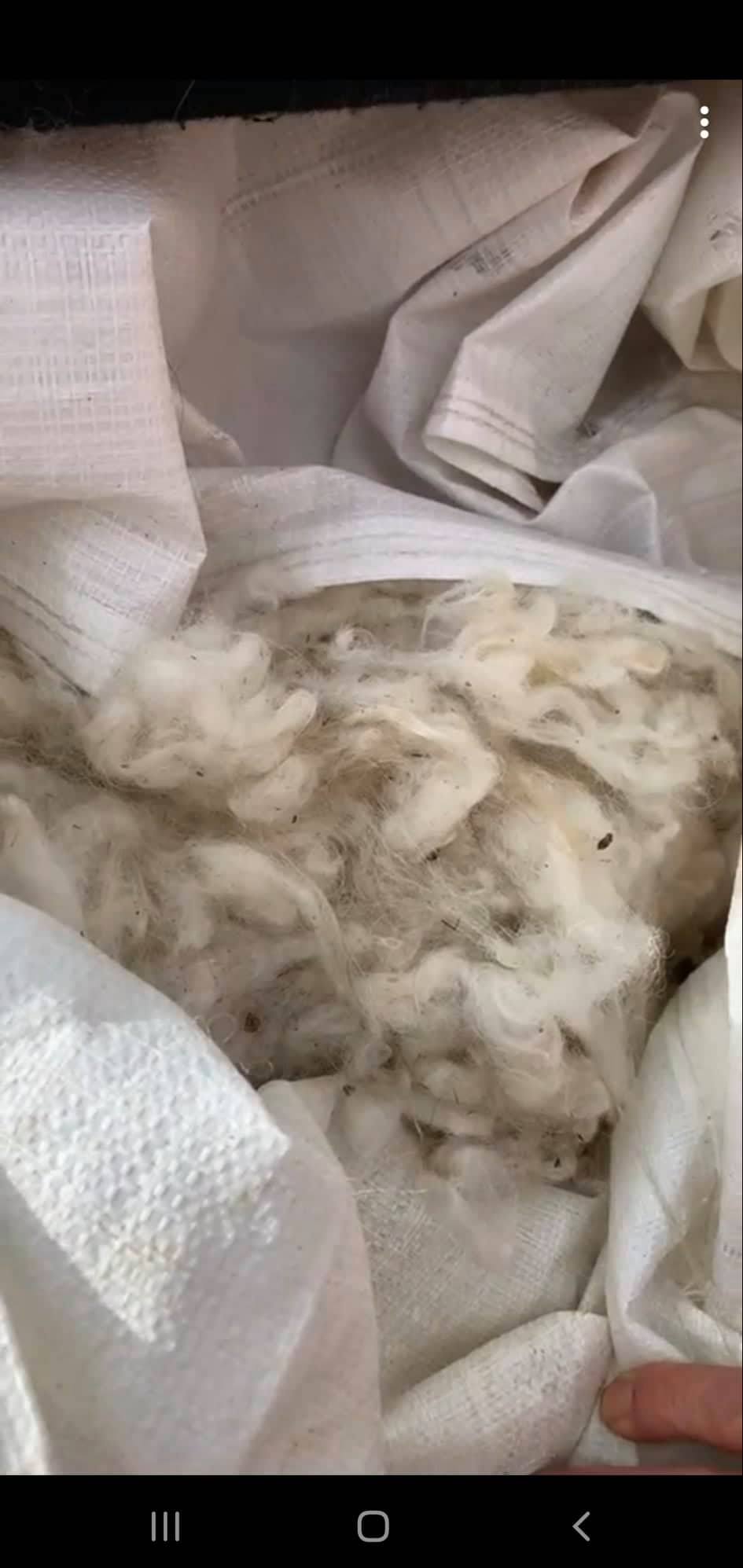

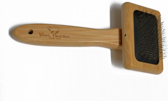

Greetings from Greece.
My mother-in-law 60 years ago (she was a farmer) used to wash it with soap down the river, then dried it in the sun and then cleaned and teased it by hand using special wooden combs.
I suppose you have better solutions to use soap but am not sure about how you could dry it in Iceland.
