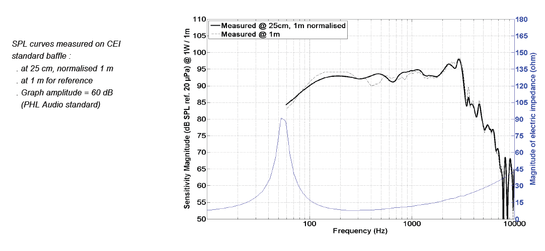

Thank you for your detailed reply. Why I dismissed you considerations about Le was that I only had the notion it would tilt down the mid range and upper mid range response. After reading in a thread by b_force, I also learned it can be responsible for distortion. That was new to me.
One thing is twisted in your reply: The highest Mms is that of the PHL audio 3411. This is also a black hole in some domains: If I could get a confirmation that this is the driver used in Genelec's S360A, which I use as a sort of model at the moment, the sum of applauding reviews available online left me without a doubt about its usability for mid range duties in a two-way. I have asked their lead engineer for confirmation, but naturally do not await a response. Sadly, there is even no linear distortion measurement available to my knowledge, which is a problem. I have emailed PHL audio and hope they would at least provide a frequency response, but they do not have the reputation to answer such inquiries.

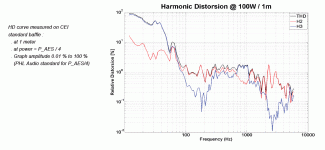

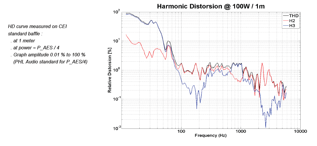

The Beyma 10G40 has actually a bit lower Mms at 52g and a reasonably controlled cone break up and a flat-enough response to work with:

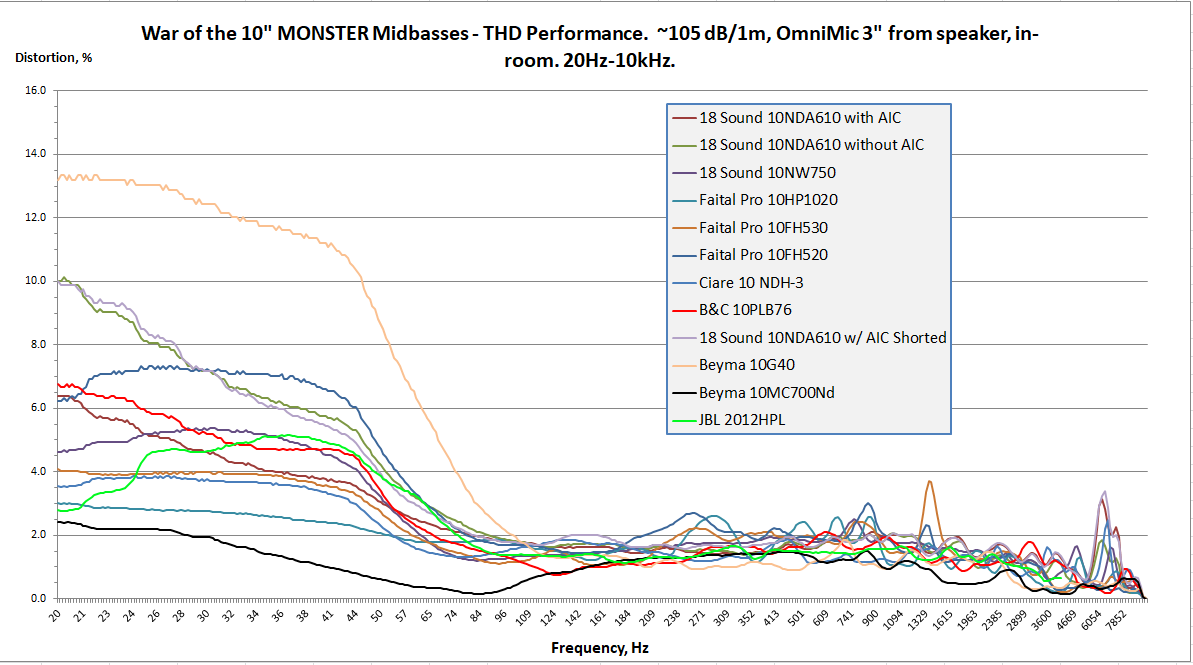

Its distortion seems to rise quite fast below 100 Hz, though:
The Faital i.e. goes quite a bit later:

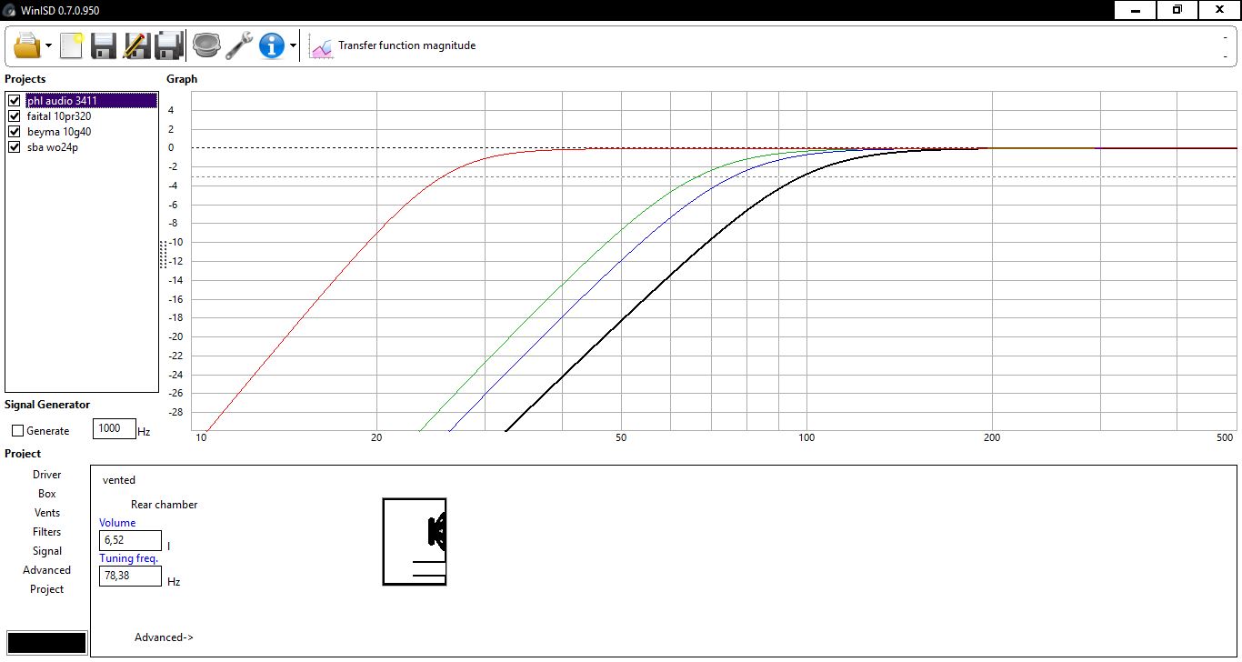

I followed you advice and created QB3 alignments with the four drivers at question. Here is the results, what do they tell me in combination with the above equalization results?
QB3 alignments in numbers:
phl audio 3411 (black)
6.5 liters
fb = 78
faital 10pr320 (blue)
15.4 liters
fb = 64
beyma 10g40 (green)
19 liters
fb = 57
sba wo24p (red)
71 liters
fb = 25
![Beyma_10G40_(Frequency_response_+_Distortion).png](/community/proxy.php?image=http%3A%2F%2Fwww.loudspeakerdatabase.com%2FBeyma%2F10G40%2FBeyma_10G40_%28Frequency_response_%2B_Distortion%29.png&hash=087206d53b6525e23ce882a8e407b6cd)
![War of the Monster Midbasses July 21 2019 01.png War of the Monster Midbasses July 21 2019 01.png](https://www.diyaudio.com/community/data/attachments/910/910720-e50f0f43ea74c021732c9e2a0b6ca6fc.jpg)
![faital_10pr320_thd.jpg](https://www.dibirama.altervista.org/images/ingrandimenti/faital_10pr320/faital_10pr320_thd.jpg)
![qb3.JPG qb3.JPG](https://www.diyaudio.com/community/data/attachments/910/910711-d7a4dacd8371685790720283831c2a63.jpg)
6.5 liters
fb = 78
15.4 liters
fb = 64
beyma 10g40 (green)
19 liters
fb = 57
sba wo24p (red)
71 liters
fb = 25

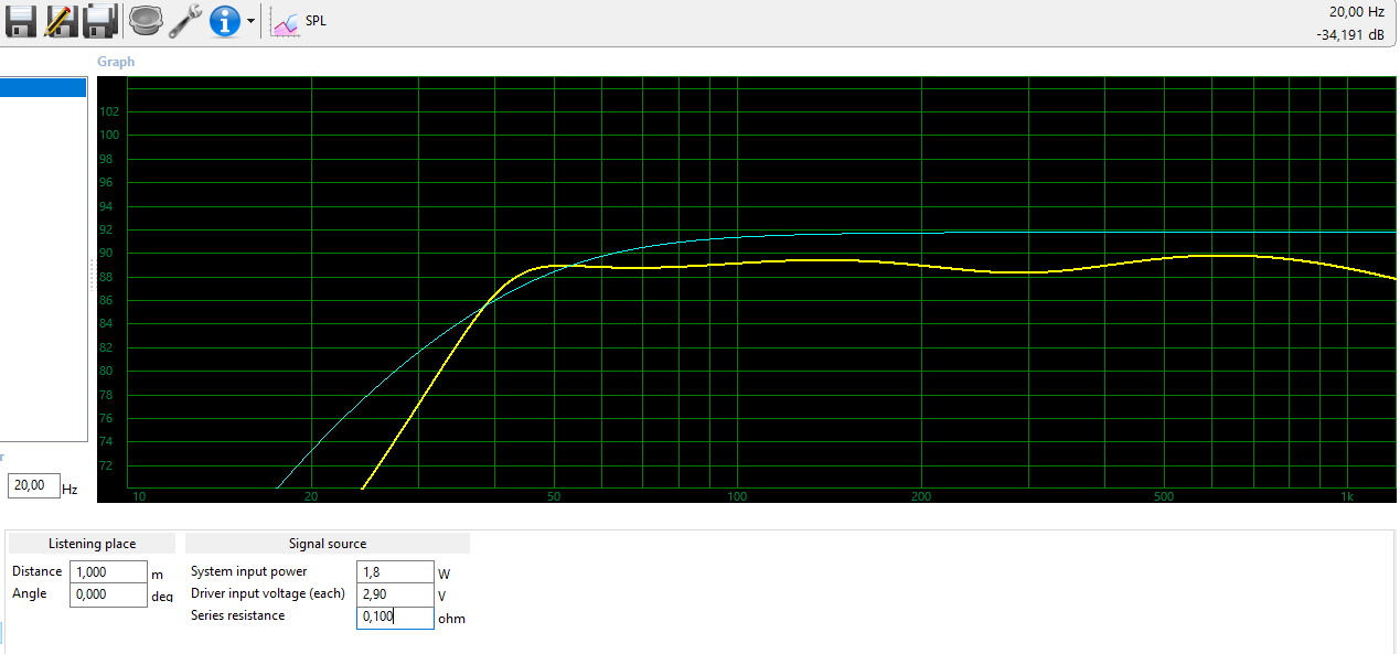

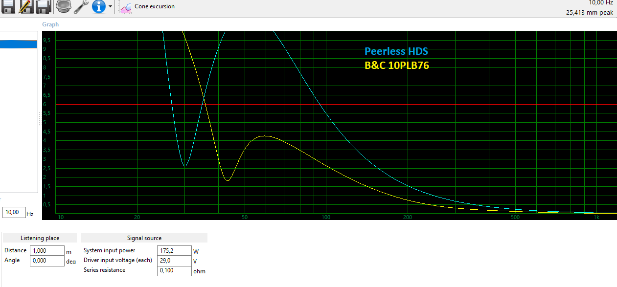

Sheeple, could i offer a different point of view on the woofer choice matter.

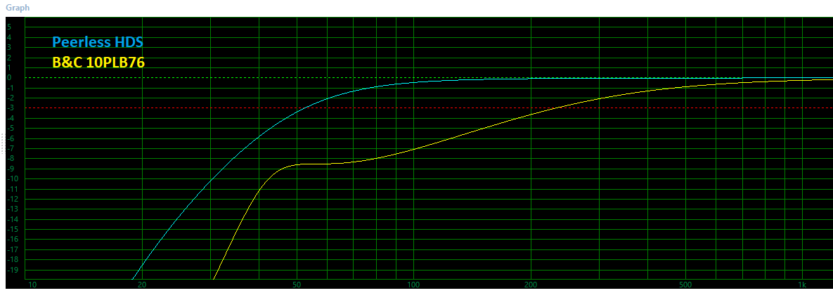

I saw Peerless HDS you wanted to use but gave up because TS parameter issue. I've done few simulations myself so here it goes.
This is Peerless HDS 8" vs B&C 10PLB76. Here is sim in 30 liter cabinet for Peerless and 20 liter cabinet for B&C.

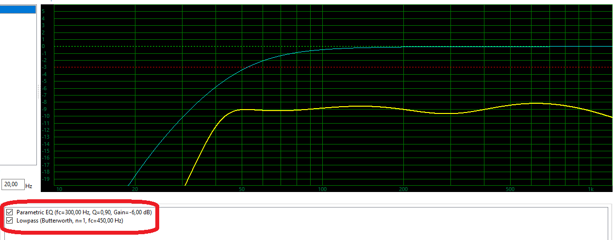

Looks dreadfull, right. Now, i applied 2 substractive filters shown on the pic so no extra excursion wasted. Not perfect simu but it will do for me to prove a point.

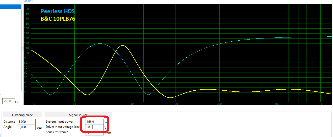

Mind you, this is transfer function magnitude. Now let us see how SPL vs applied voltage of 2.83V looks like in 2pi conditions at 1m for both.
Well, not bad at all. They are few dB apart. B&C is so much more sensitive than Peerless that you can equalize it and still remain competitive.
Let us crank up the volume to 28.3V just to see what happens with amplifier apparent load.
Look how much more VA Peerless needs in high bass and midrange than B&C. Let us see what happens with excursion at 28.3V since there is only 0.5mm difference in Xmax between the two.
I think that we can safely conclude that Peerless HDS is dead while B&C 10PLB76 is in linear excursion down to 35Hz.
Maybe quest for better midwoofer isn't necessary. Maybe by doing simulations like these you realize that you already have it. Just use lowest Mms ones from the bunch.
fb = 25
The THD % comparison graph is from the 10" mid-bass thread by member OscarS. The 10G40 sticks out as being the worst, but I remember he said that might have been rattling inside his test box, so it's possibly a measurement error. (I haven't gone back now to find the post again.)
By eyeballing the FR of the 10G40 in the datasheet it may look fine, I've traced it in Vituix, then it looks much worse, but then again eyeballing the FR and comparing it to other woofers in Oscar's thread I think it actually looked one of the best to me. So I wonder.

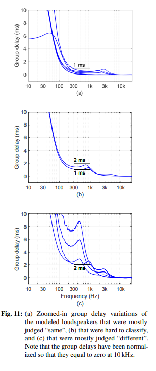

As far as group delay is concerned you might want to compare it to this set of graphs to determine if the group delay stands much chance of being audible.
https://research.aalto.fi/en/publications/audibility-of-loudspeaker-group-delay-characteristics

Btw, I do not know if I had missed it, but TLHP now shows distortion graphs and FR for 3411: Speaker PHL Audio 3411, 8 ohm, 10 inch
Distortion at "P_AES/4" probably means 100 watts. It's a 400W driver.
![3411-8.gif 3411-8.gif](https://www.diyaudio.com/community/data/attachments/911/911097-0f7fc33686be53f5b2ec30561709b05f.jpg)
![3411-8_.gif 3411-8_.gif](https://www.diyaudio.com/community/data/attachments/911/911099-61b32389389afd78ee88ab2d8fb26d52.jpg)
So they included the two graphs on TLHP as a reaction to my email inquiry. The full dataset is two pages, one additional page to the published. What they seemingly do not want to give away to the general public is three nonlinear Klippel measurements. Bl to X, Kms to X and Le to X. I think I am not supposed to share the document itself, but if I understand these graphs correctly, with higher excursion Bl is less than published number and Kms is higher, perfectly symmetrical in X plus/minus directions. So, looks well controlled and numbers seem to be good for excursion levels we are interested in. Actually this seemingly contradicts Zvu’s observation, as Bl is higher at lower excursion.
