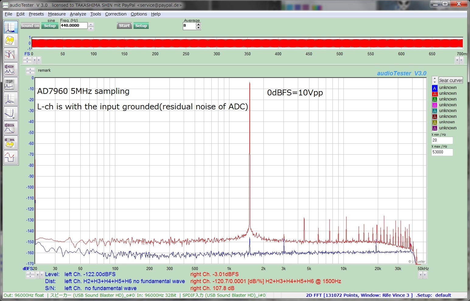

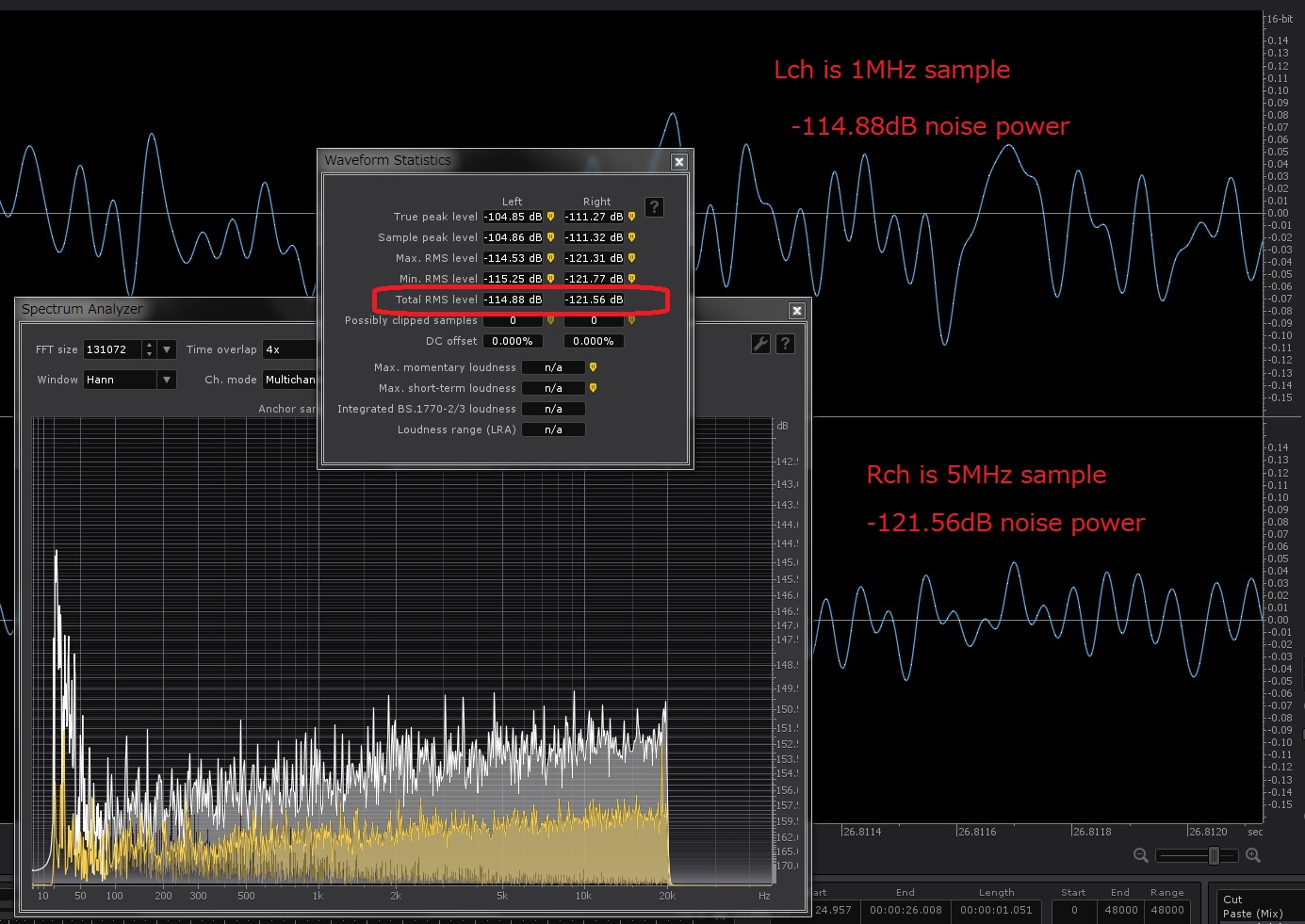

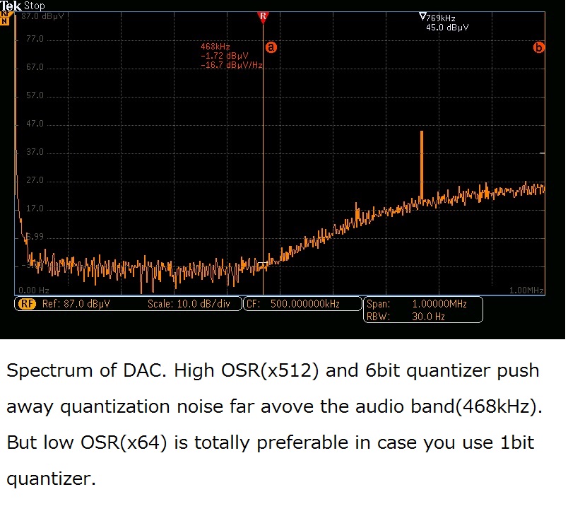

The attached is noise power of SAR ADC with the input grounded. L-ch is 1MHz sample and R-ch is 5MHz sample. 5MHz is better than 1MHz by almost 7dB because of 10log5. SAR usually outputs raw captured data. DSM ADC must have an internal digital filter to convert DSM data to PCM. There is a chance high sampling rate in DSM ADC doesn't improve SNR of converted PCM. But I'm sure SNR of raw data captured by ADC is theoretically improved by oversampling, and my experience also says yes.
My original purpose of designing ADC was also to archive my vinyl in digital format. The first version which used pcm4202 was three or four years ago. The second one with AD7982(1MHz sample) is my current version and used for archiving much vinyl. I'm sure the second one is enough performance for a music file.
But now I'm designing the third one to realize the best performance as possible for measurement purpose. Tha's why I use AD7960(5MHz sample) this time to achieve 120dB SNR and 120dB SFDR. The new version has almost fixed. I need to arrange environment to measure its performance. It takes some time.

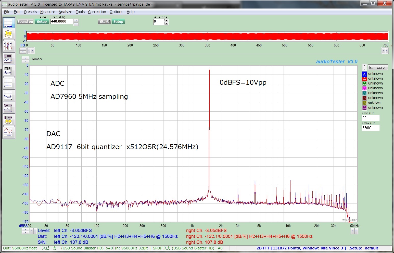

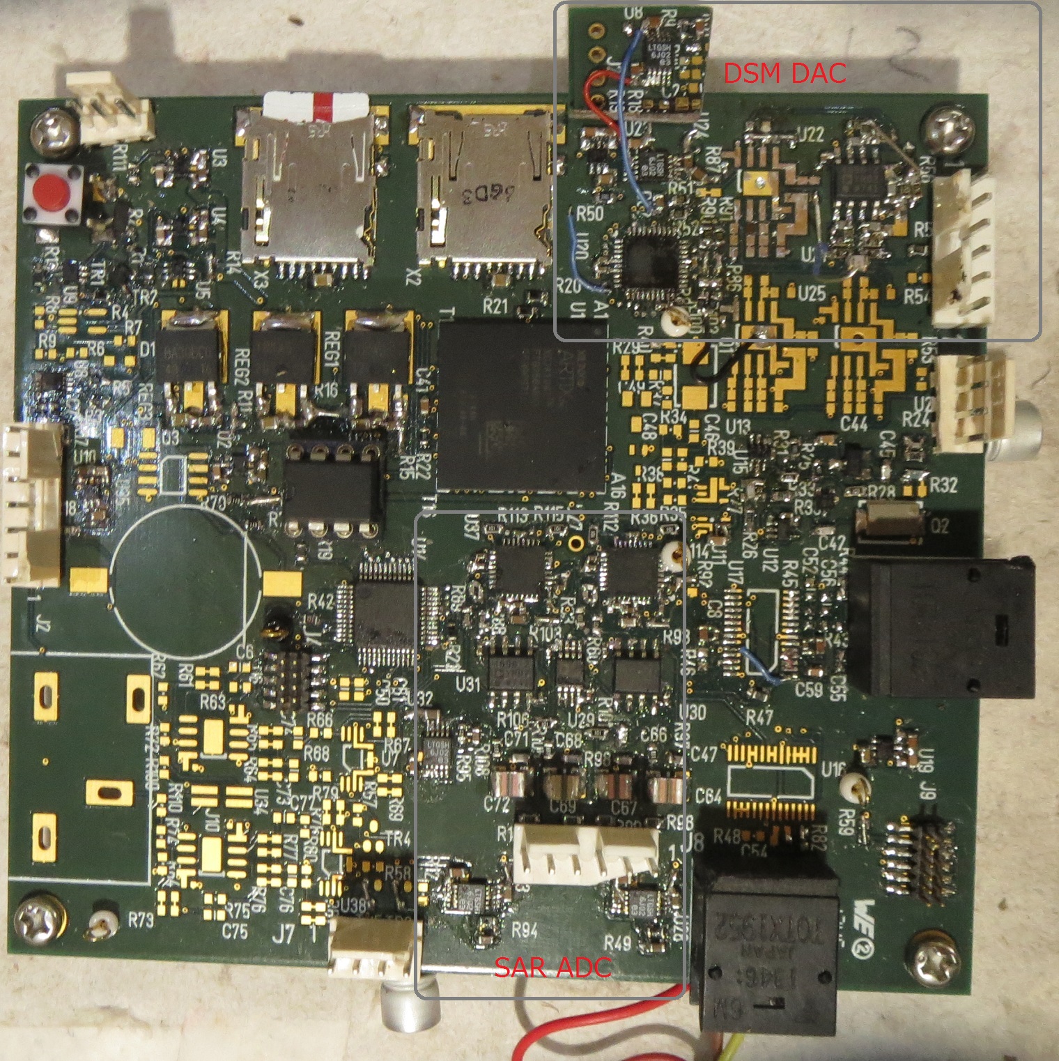

Hi, dabore84. I have fixed SAR ADC. The 1st pic is my PCB (10cm X 10cm). The 3rd version has onboard RIAA equalizer(lower left) because this is initially for digitalizing my vinyl. SAR ADC AD7960(5MHz sampling) has an excellent performance not only music file but also measurement instrument. I need to have onboard DAC which has low enough THD to certify the AD7960. I usually use multi-bit DAC(pcm1704) for listening music. But for that purpose, DSM DAC is necessary because of its excellent THD. That's why I started to design DSM DAC together with SAR ADC.

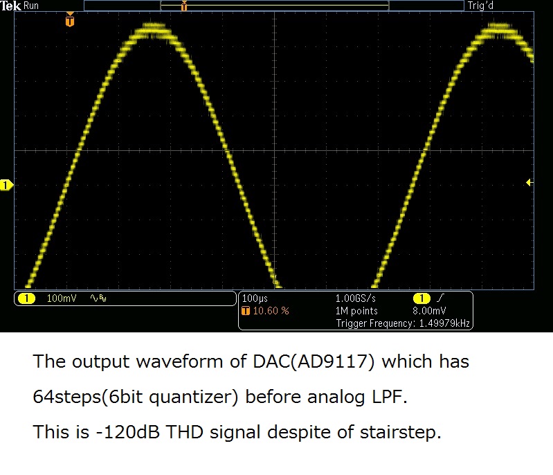

Designing SAR ADC is straightaway. Counters, shift registers and logic gates in FPGA finally take you to the goal. But DSM DAC with low THD was a long and winding road. It took much time than I had expected. Now I have almost fixed DSM DAC like the attached pics. The AD7960 has stable performance. L-channel and R-channel have the nearly same characteristic, which you can use to upsample by two(5MHz x 2=10MHz). The residual noise of ADC at a 5MHz sampling is -122dBFS(0dBFS=10Vpp), which is almost the same value as theoretical one. If you do upsample by L-ch and R-ch, you have -125dBFS which is very difficult to achieve by DSM ADC.

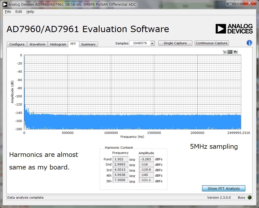

I have EV-board of AD7960 made by Analog Devices. It has almost the same numbers as my board. But less than -120dBFS THD isn't guaranteed one of course. The amplitude isn't reliable though the frequency is correct. Anyway, I'm sure the AD7960($50) is the chip for the buck.

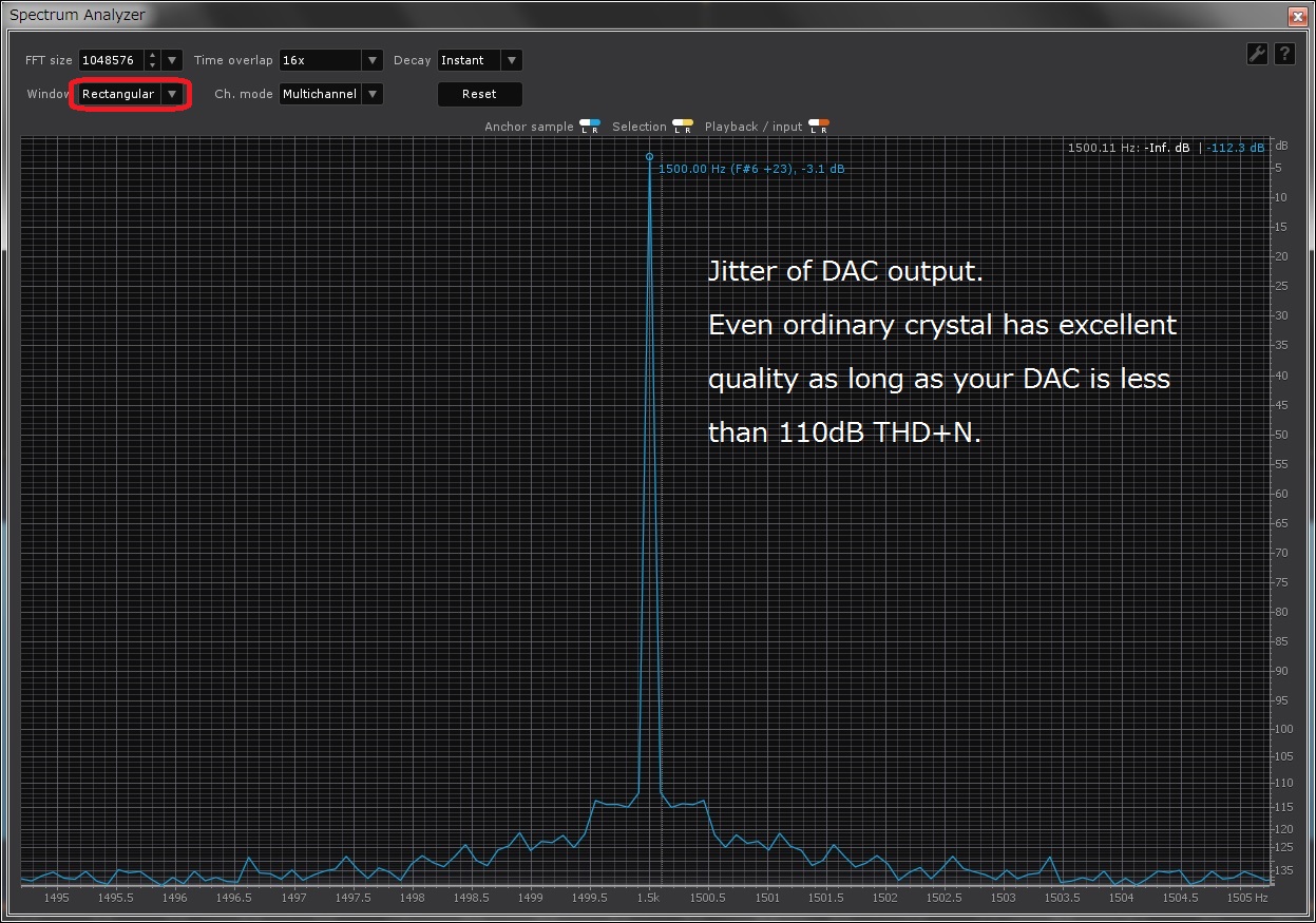

As to DSM DAC, I discarded commercial DSM chips when I decided to use pcm1704 after several listening tests because they didn't have strong bass for me. But Small FPGA in QFP(xc6slx9) and AD9117 may have some possibility for my current audio system. I'm planning to design small DSM DAC PCB without SAR ADC for my personal use. I'm sure DIYed DSM DAC, not commercial one is worth making.

My ADC is almost same as the EV board by Analog Devices.
The difference is ADC driver. Mine is AD4898 while EV board is AD4899. Both have excellent performance except for absolute rating of a power rail. AD4898 is 36V. AD4899 is 12.6V. AD4898 is more convenient to use and a dual OP amp.
The most important thing but rarely noted is a reference voltage. EV board uses ADR4550, which is a usual selection in general but not good for an audio application where low frequency is important. SAR ADC has many input pins for a reference voltage because of its topology. For example, AD7960 has four reference voltage pins and three dedicated GND pins. It needs much current from a reference voltage. Normal REF like ADR4550 has excellent temperature coefficient but has relatively large output impedance which often results in less SNR.
My second version ADC had such problem. I did many trial and error to find where the noise came from. I found finally it came from reference voltage like ADR4550. After changing it to normal low noise voltage regulator, the noise faded away. What SAR ADC wants in an audio application is not thermal stability but a low impedance to sink much current. That's why my 3rd version has LT3042 for voltage reference. This works well and easy to change the voltage.

High-speed sampling is for high SNR in the audio application. Inherent resolution of AD7960 is 18bit. But actual bit resolution is determined by SNR, where bandwidth is the most critical factor. The lower bandwidth, the higher bit resolution. I would say 20bit is the best in 20kHz bandwidth like audio application. The available bit resolution is 20bit at max even if your ADC claims 24 or 32bit because SNR dominates noise floor.
Raw data of 5MHz(24.576/5) is not directly used. My final sampling frequency is 96kHz/24bit. Captured data by 24.576/5 is downconverted to 153kHz(24.576/(5*32)) by the first decimation filter. The second one is 5/8. Then you have (24.576/(5*32))*(5/8)=96kHz. The advantage of SAR ADC is arbitrary division ratio whatever you want. A commercial ADC chip has only the fixed one. I have another sampling frequency, 24.576/6=4.1MHz. This is more practical than 5MHz because it requires high-performance op-amp which has the ultimate driving ability.
I would say 4.1MHz((24.576/(6*32))*(3/4)) sampling is a more convenient way than 5MHz.
My ADC is still on the way. Captured 96kHz data is written into SD card in fat32. But exFAT is better for SD card interface. I need to rewrite firmware to be able to handle exFAT. I already have read interface to SD in exFAT. It takes some time to write the code of write operation in exFAT. This doesn't have high priority in my todo list because fat32 is enough for my personal use. That's why I have no plan to sell the ADC board. I have already quit from a business. An audio person old enough to live only with a hobby.🙂
