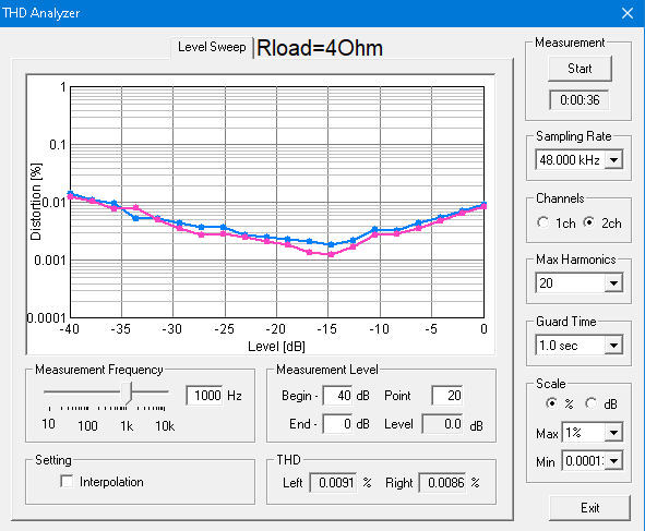

The MAD-50 was designed to work with near-field speakers over the entire frequency band, so distortion was at the forefront there.though distortion is quite high on the second one with the TAS5142, the first one is much better
When I switched to three bands and DSP for the active speaker, the distortion faded into the background. For the reason that the increase in distortion occurs at maximum output power, and 60% of the power goes to the woofer, the channel of which distortion of 0.01% at 100 W is not so important, the woofer itself at a power of 100 W distorts at 5% and higher. The middle channel operates at less power from the low-frequency channel, so it receives less distortion, less than 0.01%, if you look at the level sweep, you can see that as the output power decreases, the distortion decreases and becomes quite acceptable, well, taking into account that Since active speakers are most often listened to at powers below 100W, the result is that the sound is usually at a level where distortion is 0.003%, which is more than enough for active speakers. The increase in distortion is associated with a reduction in the dimensions of the printed circuit board, which in turn made its cost more acceptable. I decided that the affordability of the price is much more important than distortion of 0.005% per 100W.
