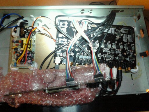

Hello,
Hereby I submit a few photos after.
Temporary construction with new Op amps LME49720NA:
The LR24-filters are created with the software rephase. The eq-function I have also performed with rephase by use the Input processing of NUC.

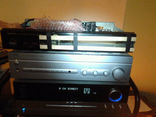

Here are some pictures of my system:
NAD325BEE for the bass and Harmann-Kardon AV Receiver with separable output stages for the rest 3-ways.
And last but not least the diy-speakers Visaton Atlas MK V

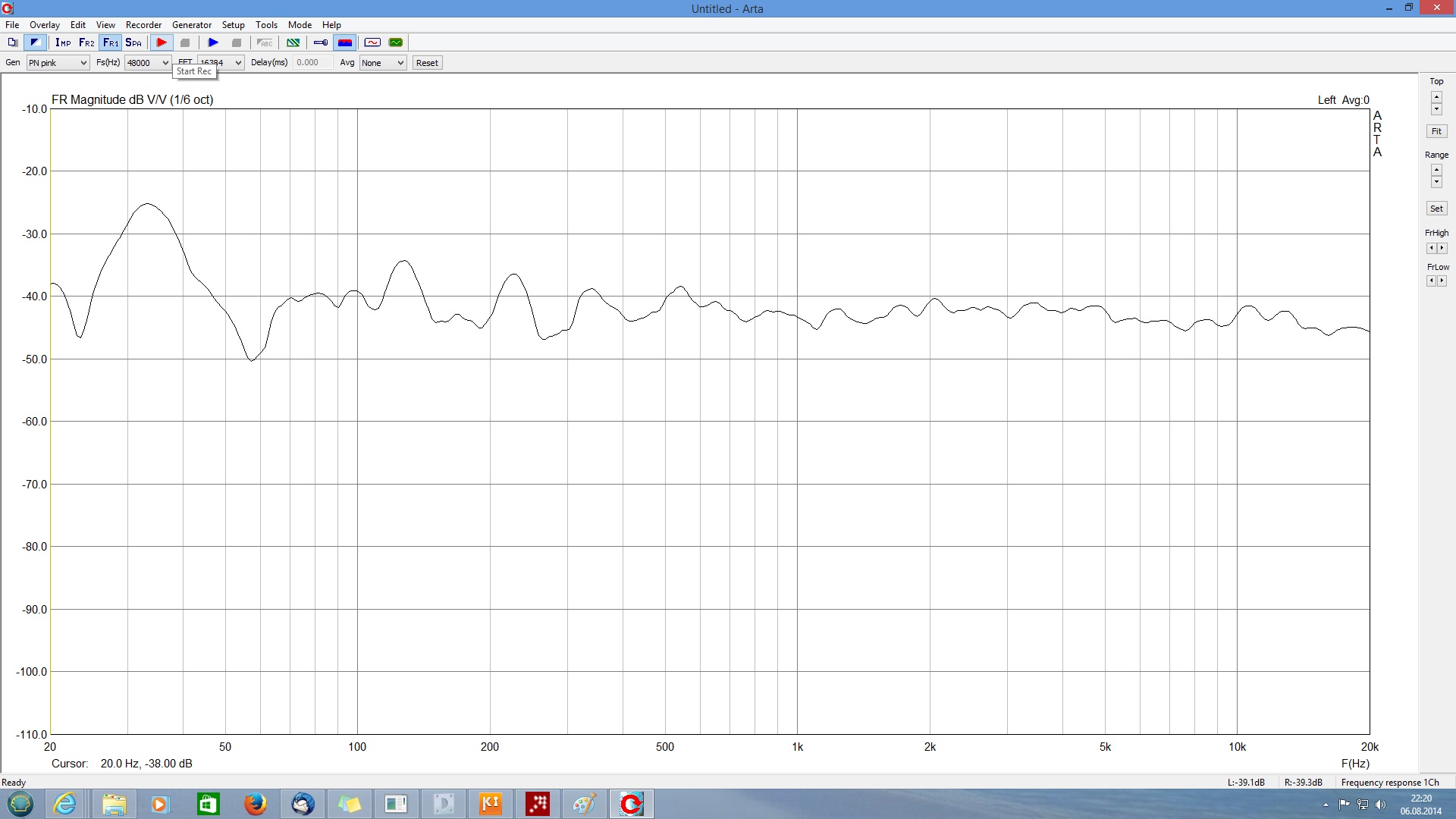

The measured frequency response with Arta:

Hi Frank,
Thanks for posting! Hope that this is temporary indeed
Nice! Can you post the frequency response of the filters? Just curious.

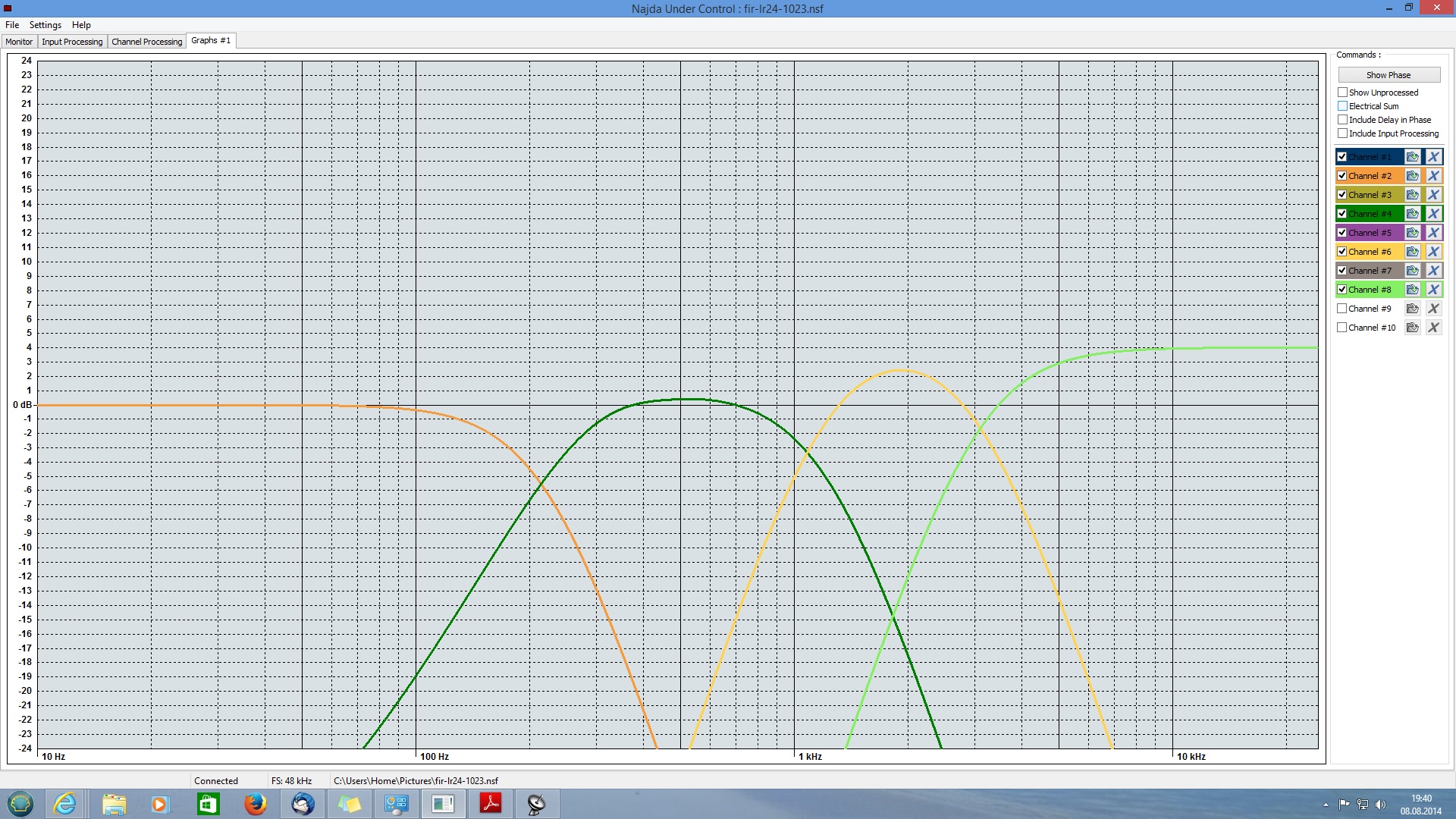

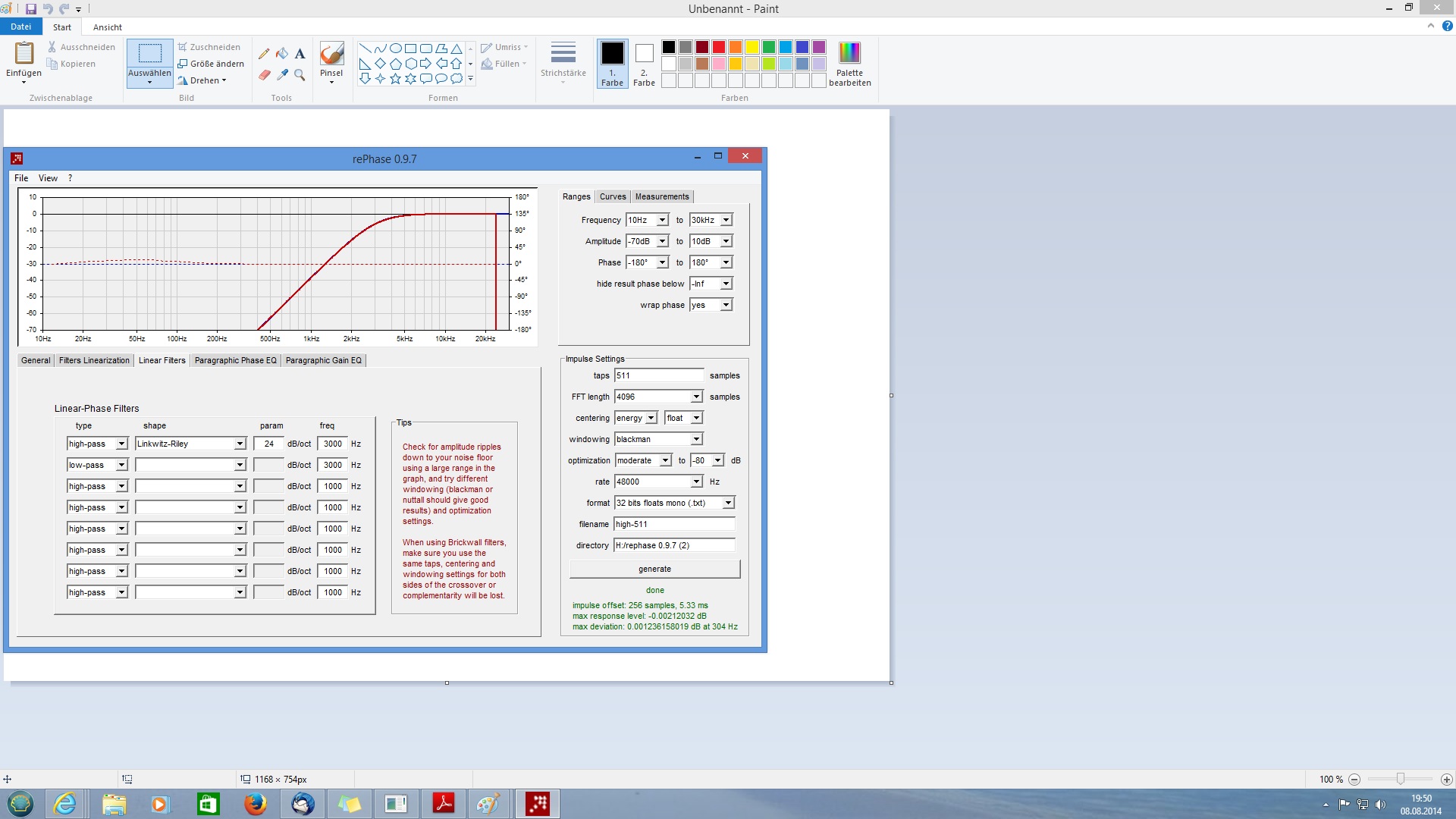

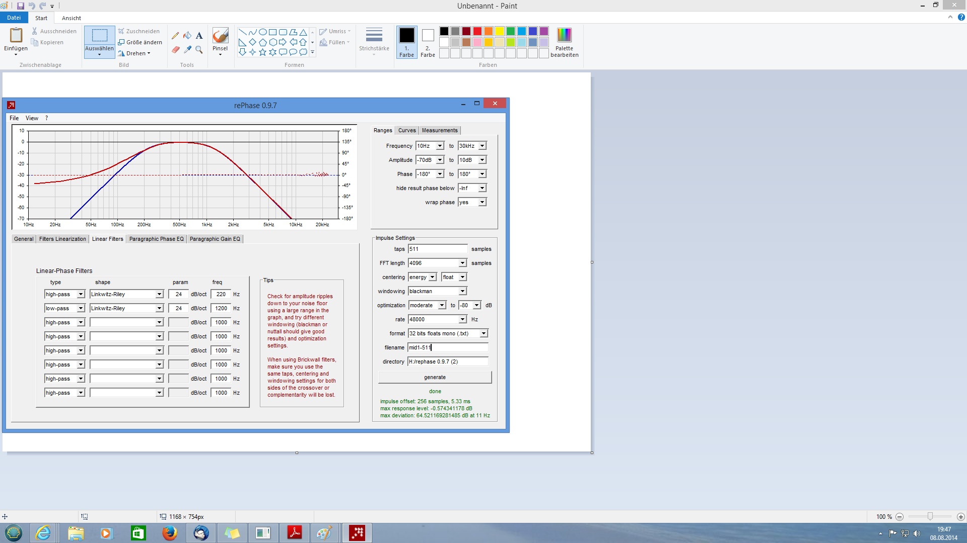

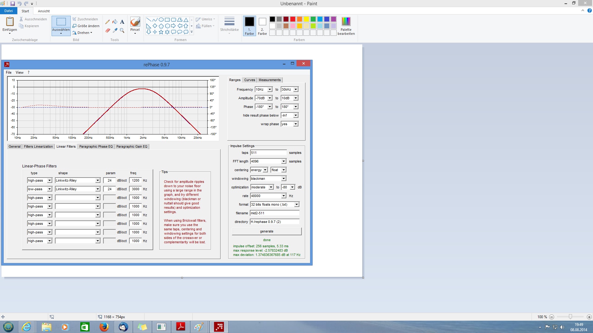

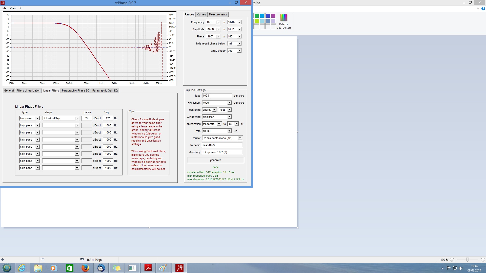

Hello,
the frequency response of the filters is carried out with rephase:
Fir-Filter for bass (Chassis Visaton TIW 300)
Fir-Filter for mid1 (Chassis Visaton AL 170)
Fir-Filter for mid2 (Chassis Tang Band W4-1320SIF)
Fir-Filter for high (Chassis Vifa XT 300 K/4)

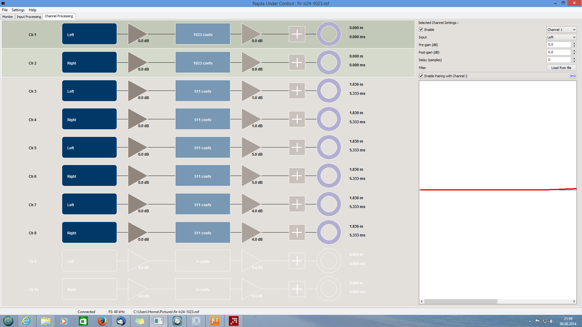

The filters in NUC:
Electrical Sum in NUC:
Electrical Sum include Delay/Phase in NUC :

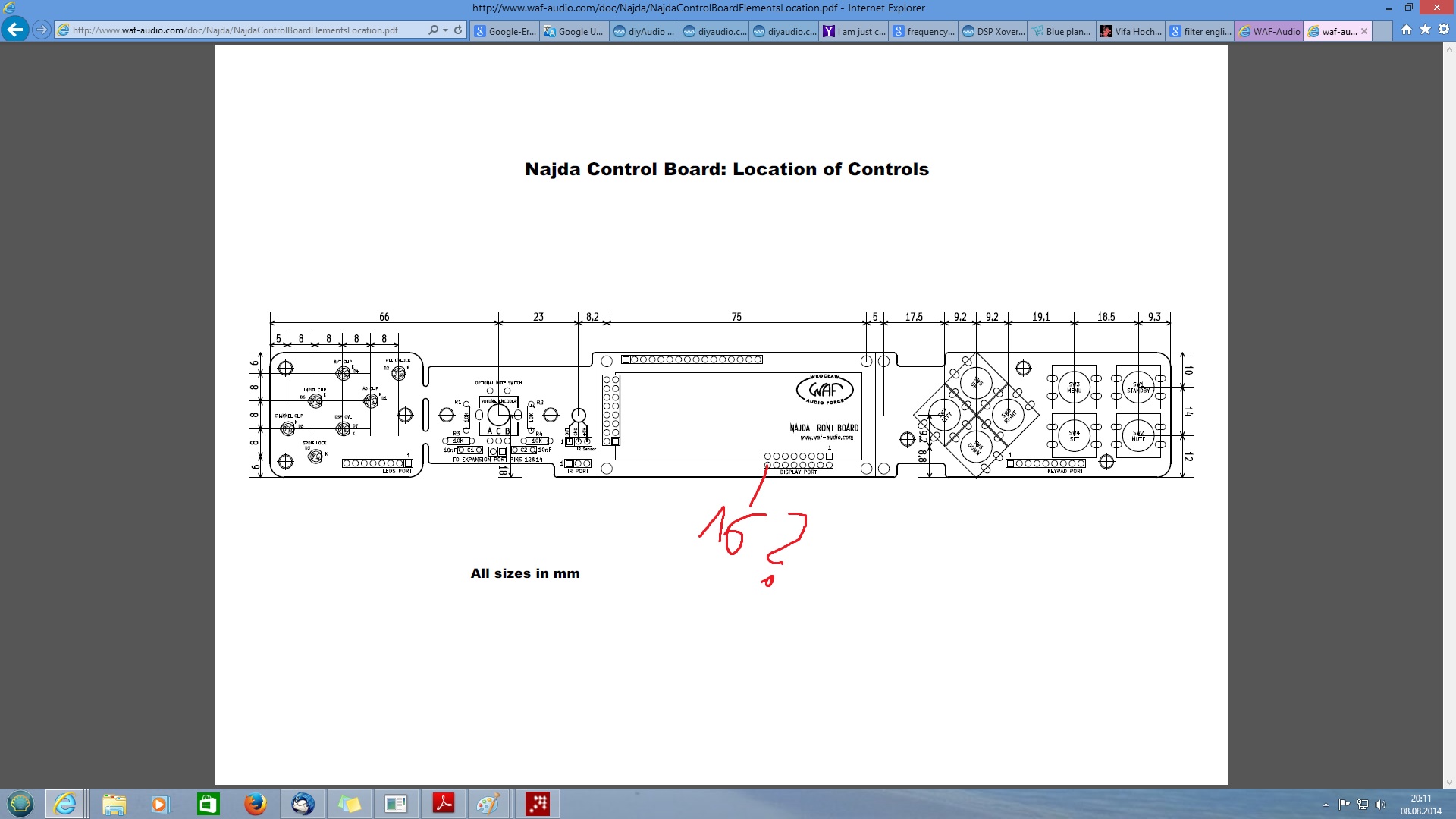

I am very satisfied with the sound. I just have not managed to get it to run the display. I do not know exactly where is located on the control board pin 16.
Frank

That's very nice! You might have room for improvement by setting proper delays required by FIR filter of different lengths. Please see this post if it can help.
Re. pin 16 of the display port, that's indeed the one you have circled on the diagram.

The delays are already implemented. The bass requires 512 samples and the remaining 256 samples. The delay is thus 5.333 ms.
Thanks for the quick reply in connection with my display. Unfortunately, it still does not work. Do I need to completely reinstall the control board (LEDs, resistors, etc.). Can I order accessories necessary with a new control board?
