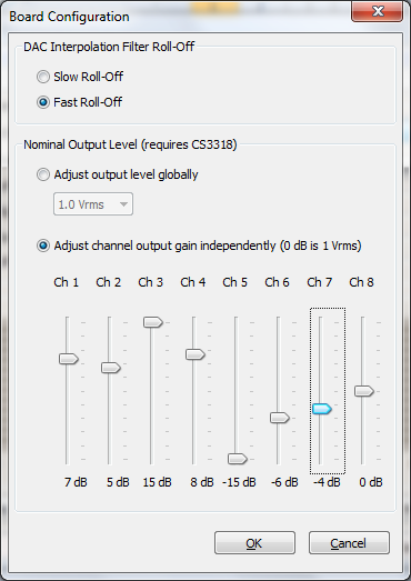

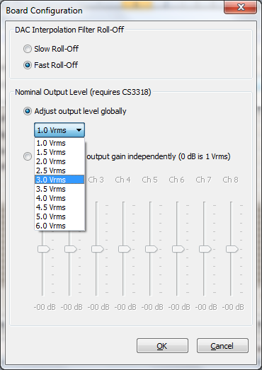

Today I looked at this idea that Kazam talked about and I tried to put it together with Shaun's comments.
So here's what the Board Configuration dialogue could look like.
If you want to set a global level, all the sliders are disabled and the level is rated in Vrms:
If you'd like to set various analogue gains for the outputs, then the combobox is disabled and the gains are rated in dB:
This might be part of the forthcoming soft/firm revision.

Great news on gain structure optimizing. I had to attenuate my tweeter digitally with 11dB. Now I can do that on the output. How would the output graphs look like then? Would you include the analog attenuation?
Well, no. The graph shows the Setup file expected outcome, meanwhile the output level is a board setting. A Setup file is a collection of DSP parameters, so analogue gains won't show up in the graph.
It's not always clear what should be seen in this graph and what should not be included.
