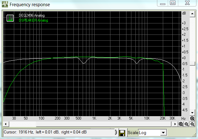

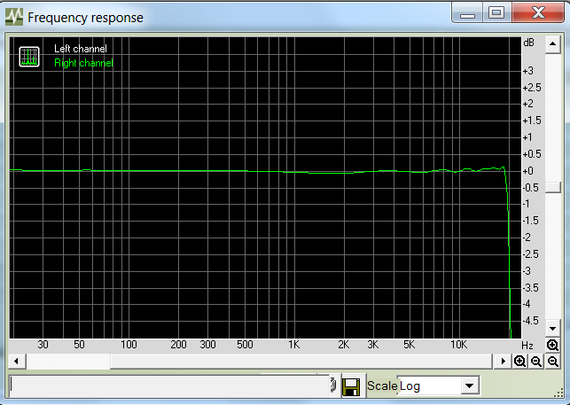

First test was for high level frequency response. And here is what I saw: Fig 1 (see attachments below).
Oops… I easily came to three conclusions:

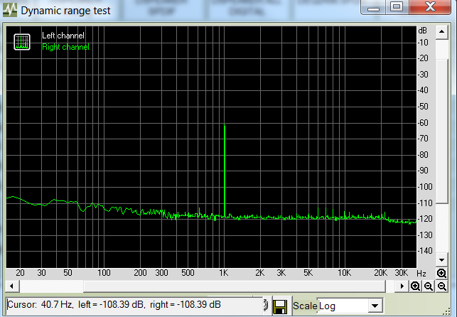

As you can see output signal is reaching exactly -60 dB, which means that DSpeaker has a unity gain. But (Oops.. again) the noise floor is at -120 dB at middle and raises to -110 dB at low frequencies. Overall measured dynamic range according to RightMark tool is 88 dB which is way below advertised 108 dB. Of cause we do not know what adjustment curve was used by manufacturer to specify the value. RighMark tool does not use any correction (A, C etc.) and noise level is calculated over full frequency range. A can imagine that magic 108 dB number can be achieved when using A weighting. But from what we see it is clear that DSpeaker offers at best 16 bits of resolution, exactly what CD gives us – say bye-bye any advantage from high-resolution digital sources. Modern DACs offer from 18 (entry level), to 19-20 (mainstream), to 21 (state of the art) bits of resolution. Again there is no excuse not to have at least 18 effective bits of dynamic range in any modern device. Considering that when used in pure analog mode DSpeaker should never see 0 dB signal at its input (otherwise ADC will clip) practical dynamic range is even lower by at least one bit. Thus dynamic range of DSpeaker is LOWER that recording on CD.

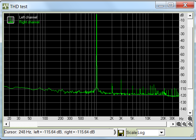

Now let’s see how much of harmonic distortions DSpeaker adds to the signal. For that I used full range 1 kHz input signal: Fig 3
Here we see that harmonics are quite low, with third is the highest at – 97 dB. All other are below -100 dB and thus are not really an issue. Though you can see a lot of high frequency hash, even beyond 20 kHz pass band limit. Overall THD is 0.0028%, which is within manufacturer’s specification. But you can see that overall noise level raises few dB up from -120 baseline, which may point to rounding errors in processing.

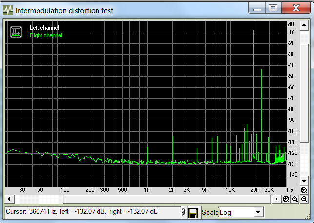

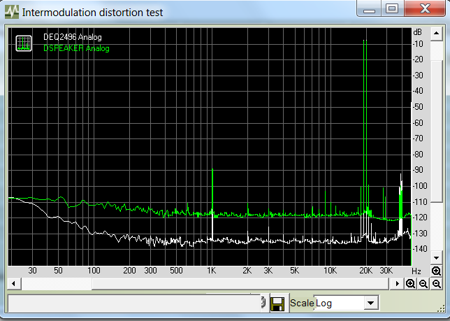

Now let’s look at IMD. For that two tones (19 kHz and 20 kHz) at -7 dB level were sent to DSpeaker input: Fig 4.
Result is not bad at all (if ignore already known issue with limited dynamic range). 1 kHz difference tone is just above -90 dB. Third order IMD components and aliases at 30 and 40 kHz are all below -100 dB. Overall it results in IMD at 0.013%. This is not exceptional, but not bad either.
As a summary of DSpeaker performance in analog chain, I can say that it can be used only if the music source is CD and owner of the system does not try to squeeze last drop of sound quality. But would people like this even bother with adding another device to their music system?
- Low frequencies response is limited by -3.5 dB loss at 20Hz. This hardly can be called transparent when makers of DSpeaker declare one of their device uses as subwoofer equalizer. What kind of subwoofer they are talking here – one that comes with tiny satellites as HT-In-The-Box?
- Response in top three octaves has visible ripple. This usually points to poor implementation of reconstruction filter when there is not enough processing power for that.
- High frequencies are limited to just above 20 kHz with sharp rolloff above that point. This simply means that this DSpeaker is useless in a system where high-resolution content is played (this actually includes vinyl – it has some content in low ultrasonic range, and people value it for that). This means that if someone uses DSpeaker he will not have value from high resolution music sources. This also causes phase and timing smear associated with low sampling rate. Based on my measurements I concluded that it is likely that input audio sampling and internal processing is done at 48 kHz rate. Considering that digital processing was routinely done at 96 kHz rate even a decade ago, there is little excuse not to have it in device targeting high quality audio market.

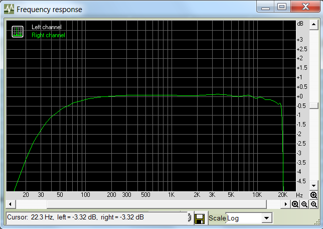

First I again tested frequency response: Fig 5
Here we again see early rolloff at low frequencies, ripple through last three octaves (though it looks a bit different), and ( surprise! ) same steep roll of at 20 kHz. Thus despite supporting 96 kHz sampling rate through SPDIF, DSpeaker is still limited to low sampling rate internally. I suspect that it simply converts whatever incoming data it receives into internal fixed sampling rate of 48 kHz. Thus users cannot get any advantage of high resolution source material, even when DSpeaker does not need to do A/D conversion.

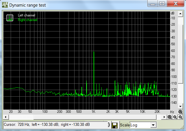

Now dynamic range test, just like I did for analog input, but now signal is sent to DSpeaker via SPDIF: Fig 6
We can see that noise floor dropped about 10 dB down to – 130 dB. It means that when digital input is used, DSpeaker offers up to 2 more effective bits of resolution (and low dynamic range in analog mode was due to limitation of ADC). But it does not help when so much of high frequency hash is now seen added to the output. From my experience this is usually the result of poor jitter reduction (this is most likely the root cause, since we do not see anything like that with analog input, when DSpeaker only uses its own clock source). Optical SPDIF interfaces never were exemplary in low jitter and thus any receiving device should have very robust clock recovery circuit (or use ASRC). It seems DSpeaker has neither. Below result of IMD tests confirm that: Fig 7
Intermodulation tone at 1kHz is very low, but we see a lot of components from 2 kHz and up, which correlates with high jitter. Also you can notice that alias components at around 25 kHz are not fully suppressed. I do not now really understand why alias suppression is so different in analog vs. digital input. The only explanation could be that designers used different reconstruction filters in these modes.
From the results above you can see that DSpeaker is not very good when used in digital input mode (actually mostly promoted by its makers) – it does add about two bits of resolution (and expands dynamic range), but still limits sampling rate internally at 48 kHz and now adds a lot of jitter related artefacts to the output signal.

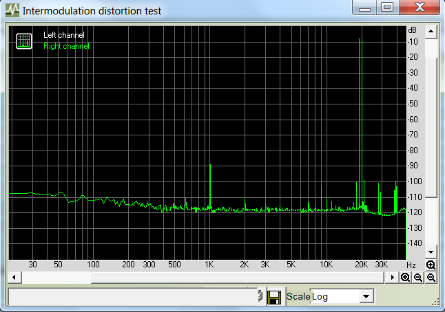

Next test is full range 1 kHz tone. And now we see much bigger Oops.. Fig 9
Looks like a lot of clipping happens somewhere. Apparently DSpeaker cannot tolerate full scale digital input signal when running in fully digital mode. And IMD test just confirms that: Fig 10
Noise floor is much higher than it should be (if we assume 18 bits processing), which again points to digital clipping (or rounding).
As you can see – DSpeaker is completely useless in pure digital mode, as it cannot tolerate full dynamic range without overflow in internal processing.
