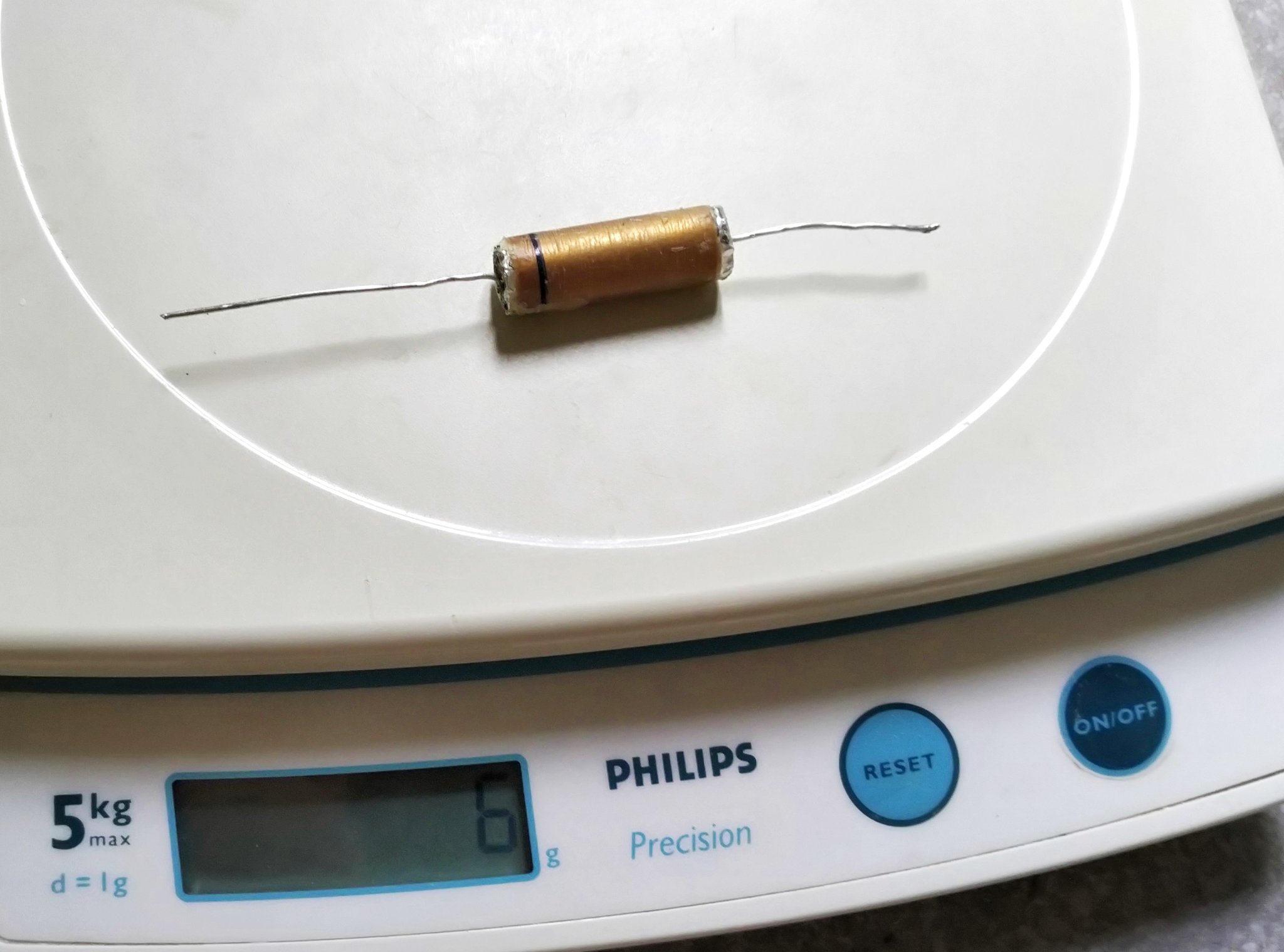

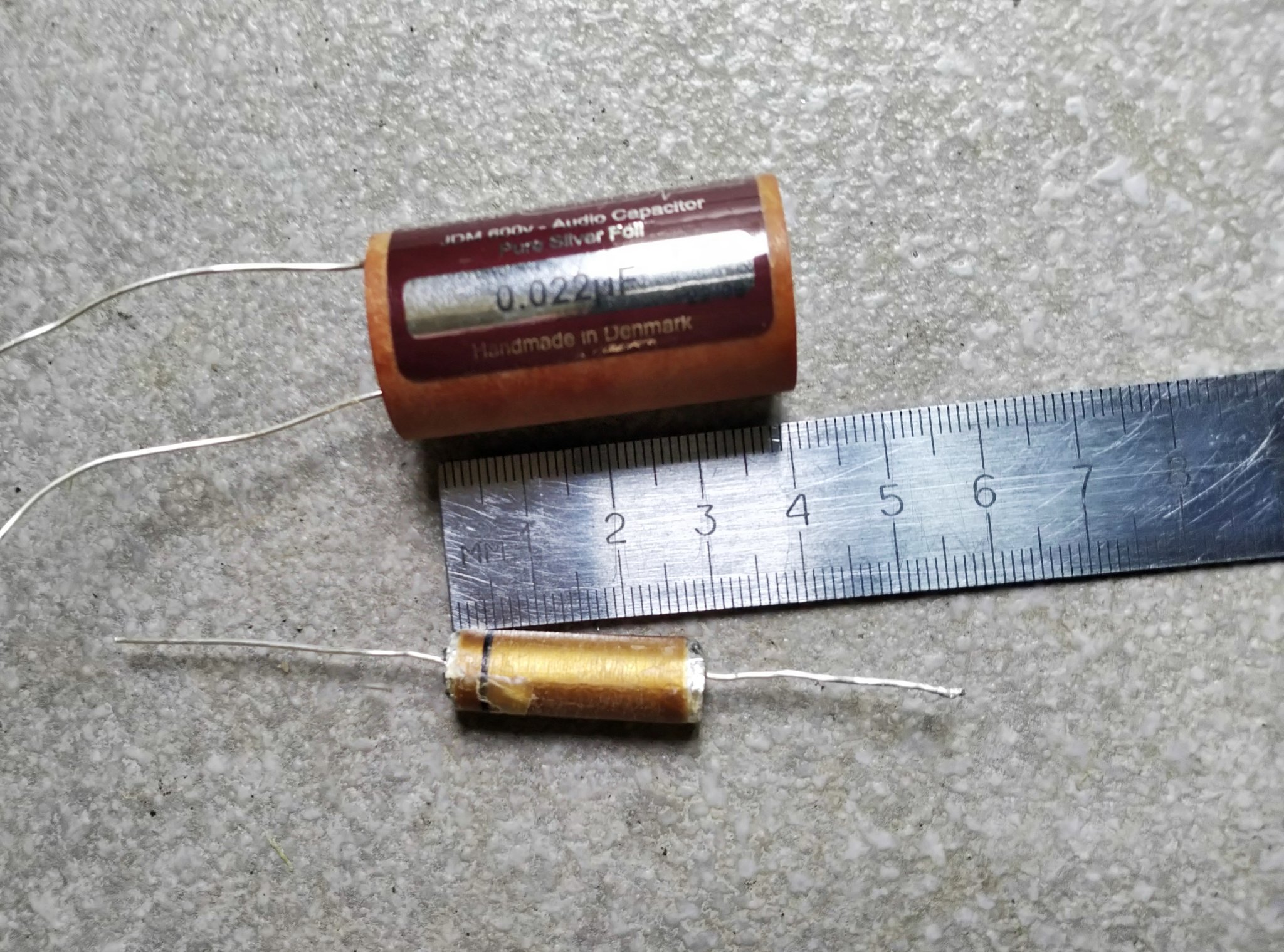

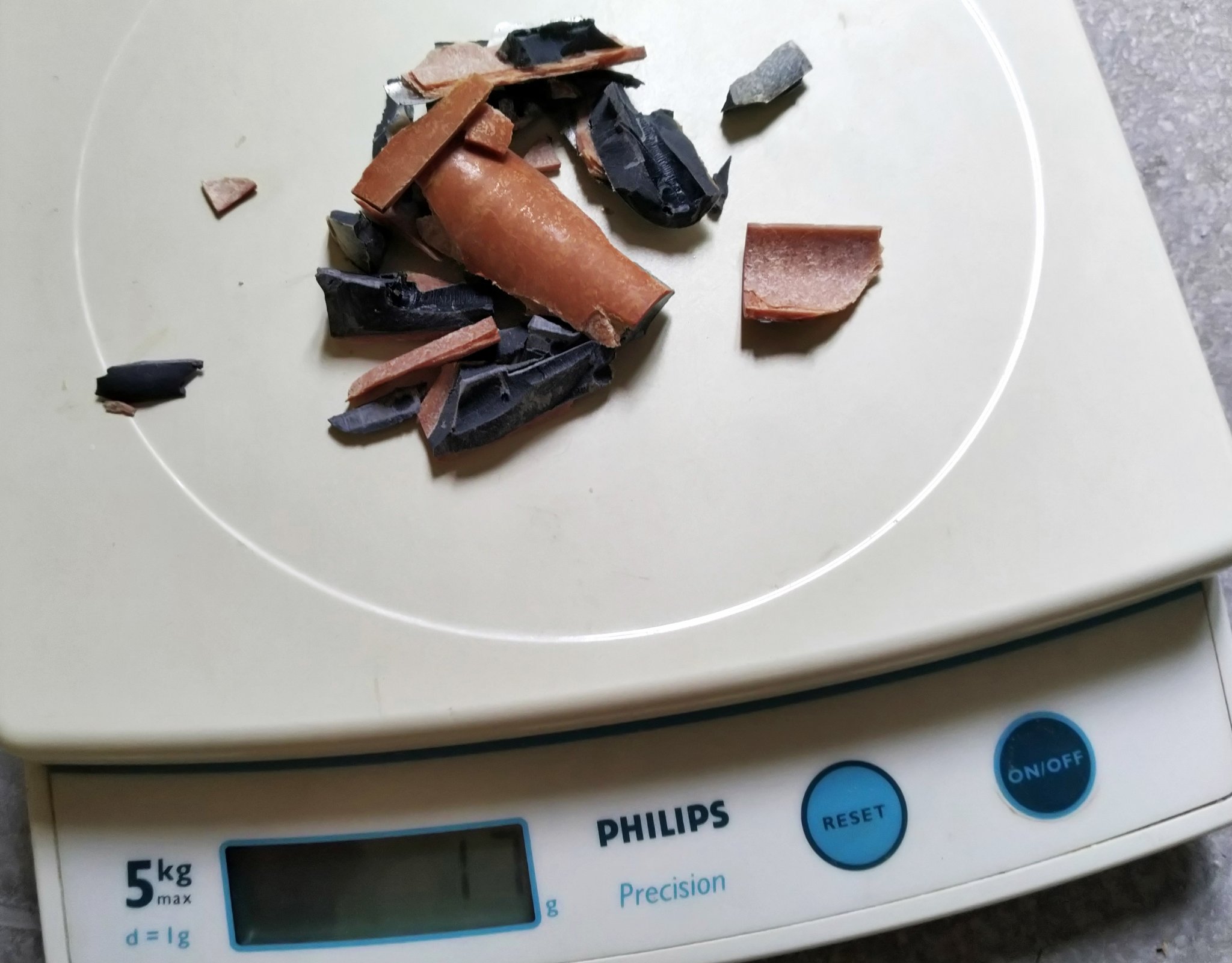

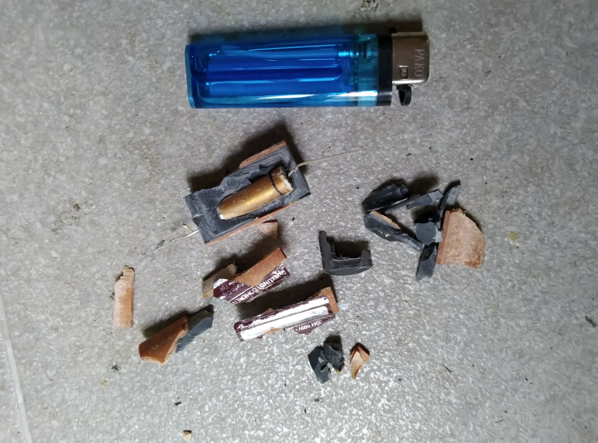

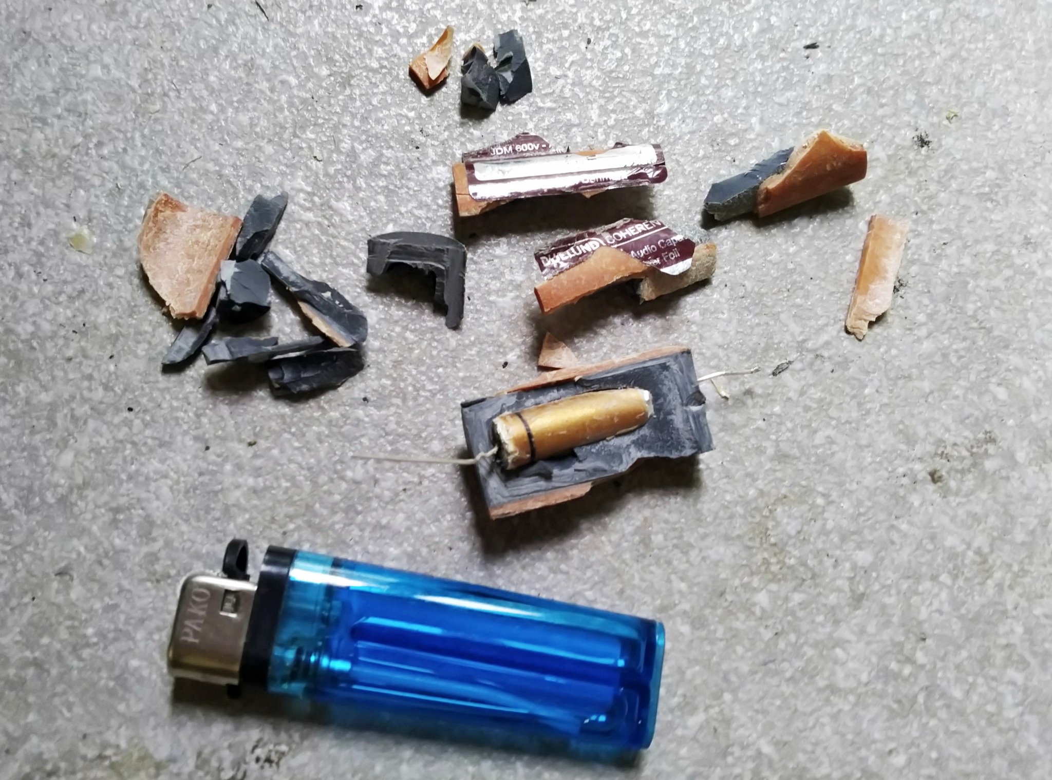

I opened a Duelund capacitor, so you don't have to do that
I thought that Duelund capacitors are physically bigger than Jupiter Silver Foil -Vitamin-Q because they have more foil and are better quality, but I was wrong. I found a ton of epoxy instead. The manufacturer could fit to 15mm diam package as 0.01uF, But for some reason he did't. I wonder what the real size of 0.01uF.. Overall these are great capacitors, I have no complaints about the sound quality

Thats what you call “extended foil construction” - it reduces inductance. the two foils are offset from one another and then the leads are soldered to to all the ‘flappy bits” as opposed to just one point on the foil(s). Not unique to Dueland very common in foil capacitors.Looks very hand made in Denmark. The edges of the foil sticking out could overlap. Strange that it is not trimmed more precisely.

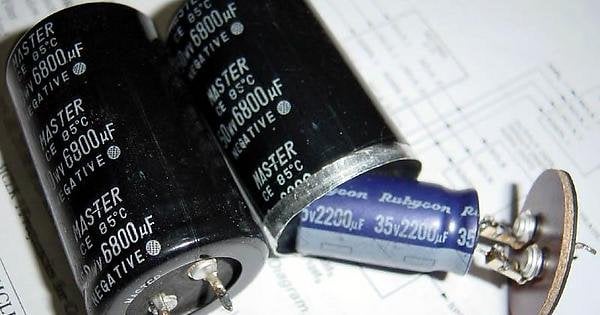

That "epoxy" certainly has a strong contribution to the sound signature. Diyers have been doing similar experiments for decades, remember rehousing electrolytic caps into bamboo tubes?
So I did listening comparison between potted and naked foil capacitors. As a coupling capacitors. Naked foil sounded a little more natural, just a hair. The difference was so small that it took a long time to compare. Epoxy really doesn't do anything positive
Bigger package is just a marketing thing
https://www.dhtrob.com/impressies/elna_inhout_en.phpSome tube guy called Rob from the Netherlands or Belgium did the Bomboo sleeve thing to Blackgates as far as I remember.
https://www.dhtrob.com/keesolaf/condensator_en.php
https://www.dhtrob.com/keesolaf/elco_en.php

This is correct, they purchased all the winding and other machinery from Jensen when Jensen closed down their capacitor arm of the business.They produce them themselves. There are numerous posts on social media where they got the matchines, also process of manufacturing etc.
Subjective?So I did listening comparison between potted and naked foil capacitors. As a coupling capacitors. Naked foil sounded a little more natural, just a hair. The difference was so small that it took a long time to compare. Epoxy really doesn't do anything positiveBigger package is just a marketing thing
Duelund may have preferred the sound with it potted.
The larger size is a drawback if viewed from a marketing perspective, as it makes them unsuitable for applications where space is limited. But the potting does fall in line with their design aims in combating vibrational effects.
I have used Duelund capacitors in the past and have some Silver Foil ones but not in my current system. I have opted for Jupiters in the past instead because of the smaller dimensions for a given value where space was a concern.
