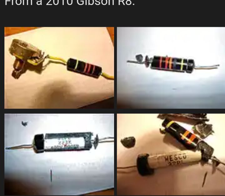

Gibson used to offer paper in oil vintage caps in their premium guitars, "for that vintage sound" 🙄
Only they were FAKE, just modern polyester Wesco caps encapsulated in an imitation plastic case.
https://www.reddit.com/r/Guitar/comments/2whtrg Any similarity is (not) a coincidence.

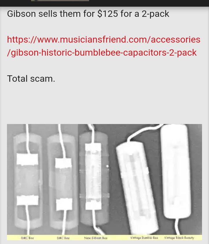

Let your eyes decide:Not to mention the fact that the comparison to the Gibson case is not only misleading because it is a completely different thing, but also unfair.
X-rays and user comment:

Inside the Gibson capacitor "container" sold as "for old time sound" it seems there is a mediocre capacitor with someone else's branding, if confirmed.
Inside the capacitor in topic, instead, there is a real handmade capacitor which is covered with different materials, I guessed for greater safety, but it will certainly have a reason linked to vibration isolation and also to the SQ.
That capacitor is handmade with silver foil for increased conductivity.
