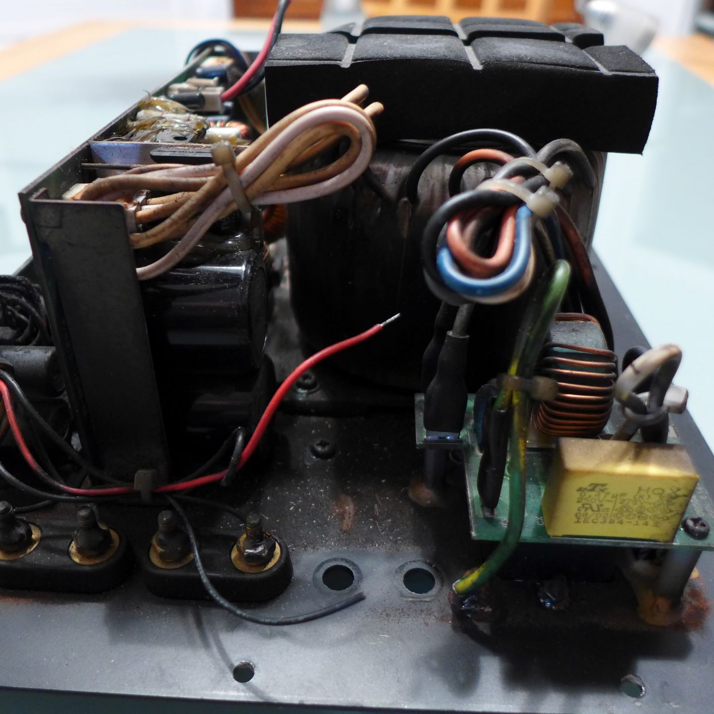

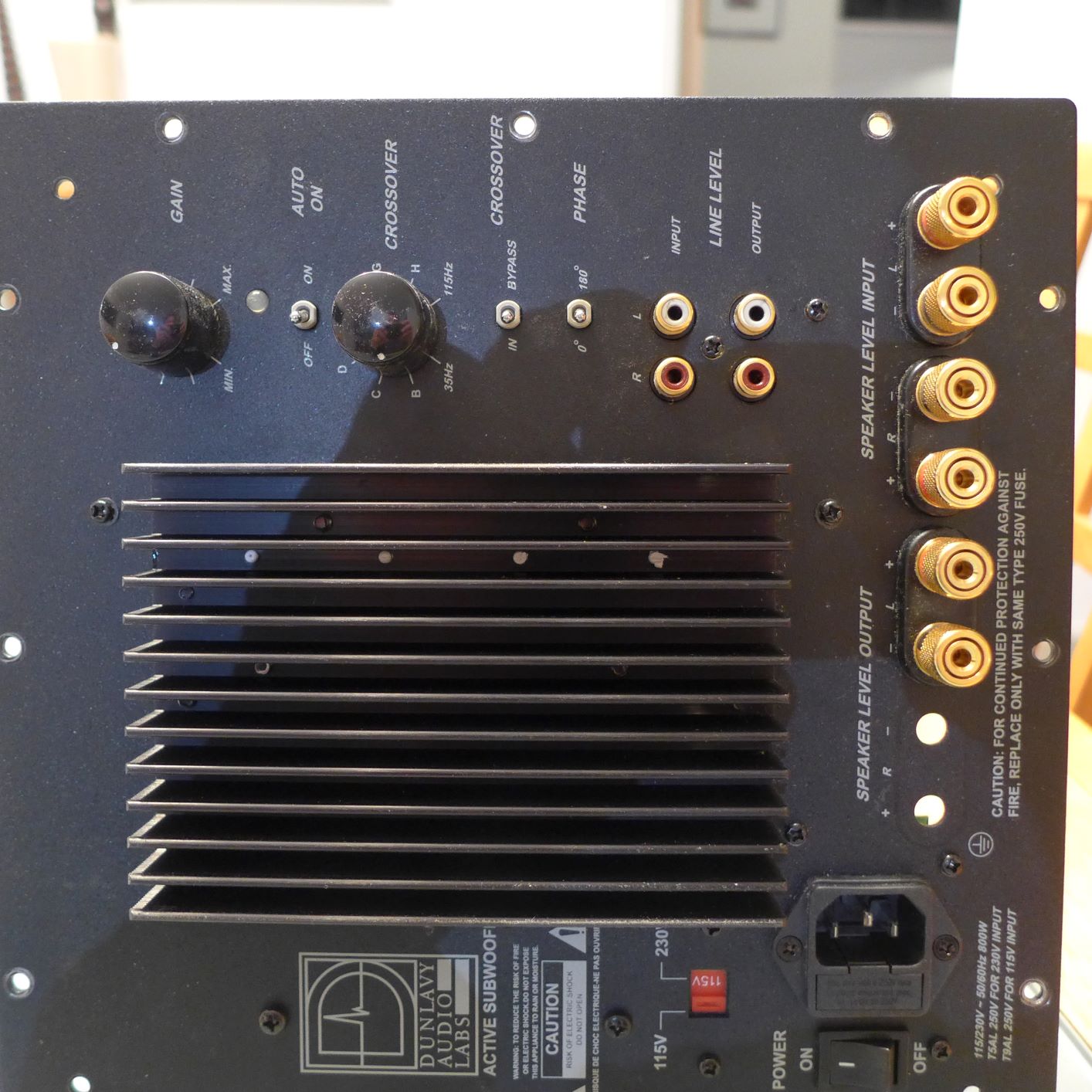

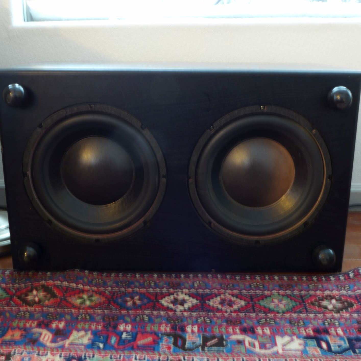

@johnnyk9 Yes my SC-S2 has 2 12" . See pictures. I bought it with a fried amplifier (see pictures) which I removed and sealed the cabinet after direct wiring 3103 cable. The amp appears to have caught fire on the pcb under the filter caps. The 2 - 12" drivers are wired in parallel for 4ohm load. The internal wires are 12 awg copper (not tinned) labeled dunlavy. Do these look like Eminence ?
I bought a pair of the SC-S2 drivers from a guy that had a bunch of them.
Built my own. They are essentially a Lab-12 with lower Fs and slightly less power handling.
Are your dual voice coil?
Also, how full was the cabinet with foam?
About 90% ?
Just curious.
