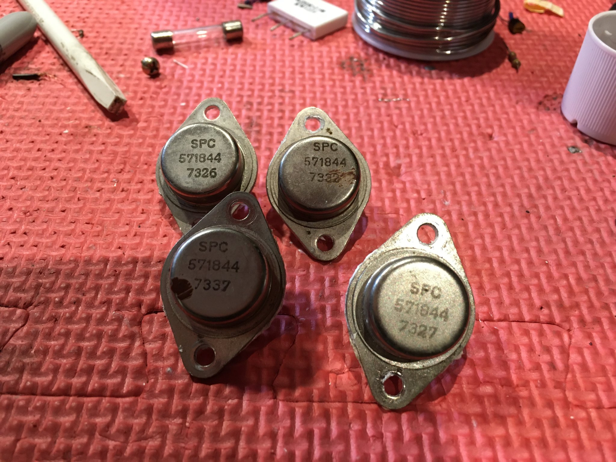

The original transistors are currently installed. I put them back in after finding out the new ones didn't fix the problem.
I'd tried a KSC945C in Q1.
I imagine you’ve already confirmed no drop across the output inductor.
It would be a tedious chore, but you could swap Q5 and Q6 across channels and see if the problem moves.
Signal does indeed clip at Q2 collector at same point it clips in the output. And in both places, as soon as it clips, the point of clipping gets pushed down more.
That's just the bootstrapping capacitor discharging, it's normal. You replaced that?
So what was in there before, presumably with very poor gain if one channel was falling short on power?

Old RCAs are usually good. Even the hometaxial 3055’s. RCA was the king of the single diffused process. Those Je ne sais quoi things were probably running out of beta. I’ll bet it was less than 17 at the 5A you could be drawing with an 8 ohm driver. At 4 ohms all bets are off. It might be a TO-3, but might not even be a 15A part. A 5 amp part might have a beta of 5 or 10 at 5 amps. I’ve had MJ15015’s (high voltage 3055’s) fall to the single digits at 7A and they’re supposed to be 15A. The parallel bank in an old QSC I was rebuilding with them just fell apart and I gave up and stuck in 15024’s the 2nd time around. But they still met spec……
I’ve been tempted to get some of the RCA1B01’s that electronicsurplus.com still has. Just tempted, not that I really need any more 2N3055-oids. Which is why I haven’t pulled that particular trigger. I still have a whole box full of 2N3772’s that were house numbered for TRW. Yes, they’re good.
When doing “the TIP mod” it’s just as common to go to the MJ15003 these days. One could only dream about them when the ST120 came out.

TIP31C and 32C drivers will give you dull highs. My 1971 ST120 came with house number drivers Q3 Q4 that were probably 2n5320 5322. 3 times the Ft of TIP31/32 which is only 6 mhz. Ask me how I know? One pair survived the burnout, that side sounded better than the side with TIP. No 60636 or 2n3055 outputs survived when I bought the unit about 1985, so I started off with NTE60 which were probably white box MJ15003 due to the soa spec. Those outputs had 2 mhz Ft instead of 0.4 Mhz. A simulator posted on here that the original homotaxial output transistors were the cause of poor highs of the ST120. See the 1966 reviews. I did not monkey with Q1 and Q2 and the 1971 transistors sounded fine. Top octave solo Steinway piano on my SP2-XT speakers is my high freq test. My hearing goes to 14 khz.

PC15 the B+ regulator and max current limiter board, was limiting to 2 amps with a NTE181(MJ15003?) instead of a defined low gain homotaxial part. So I replaced it with a 69 v regulator board and a 10 amp fuse. To get the 6.75 amps the transformer will actually put out. 5 parallel TIP142 pass transistors with .5 ohm emitter resistors each, on a Pentium2 CPU heatsink. Bases driven by a stack of six 12 v zeners with series resistor to limit current.
