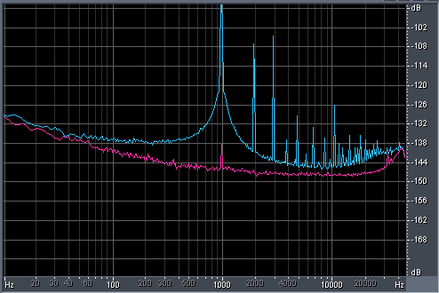

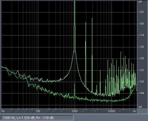

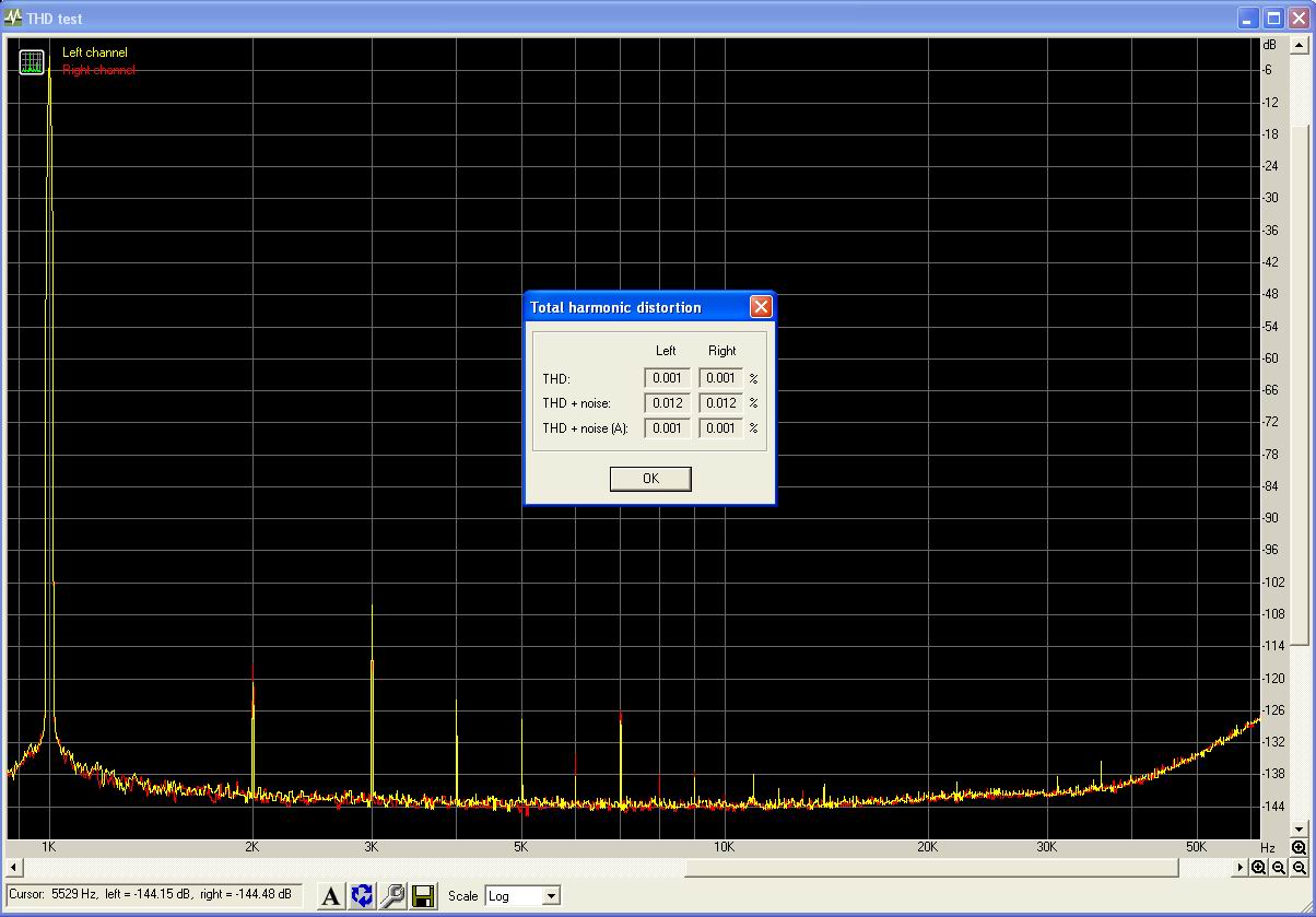

The THD plots...it goes to show where the next improvements should be concentrated, now that I learned my way inside
. More on this later.
Well, happy soldering for now! If someone manages to duplicate these results it will be reassuring. Just let us know!

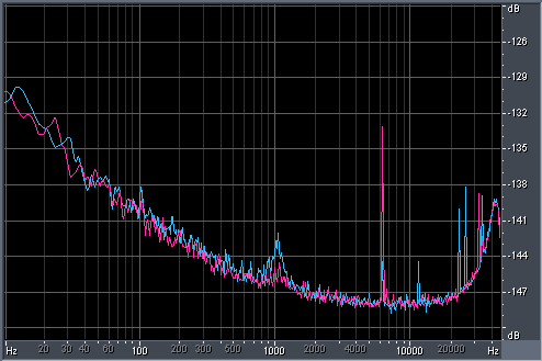

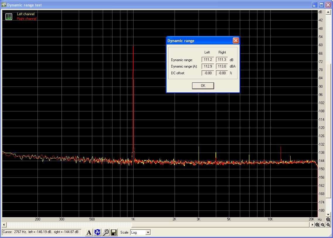

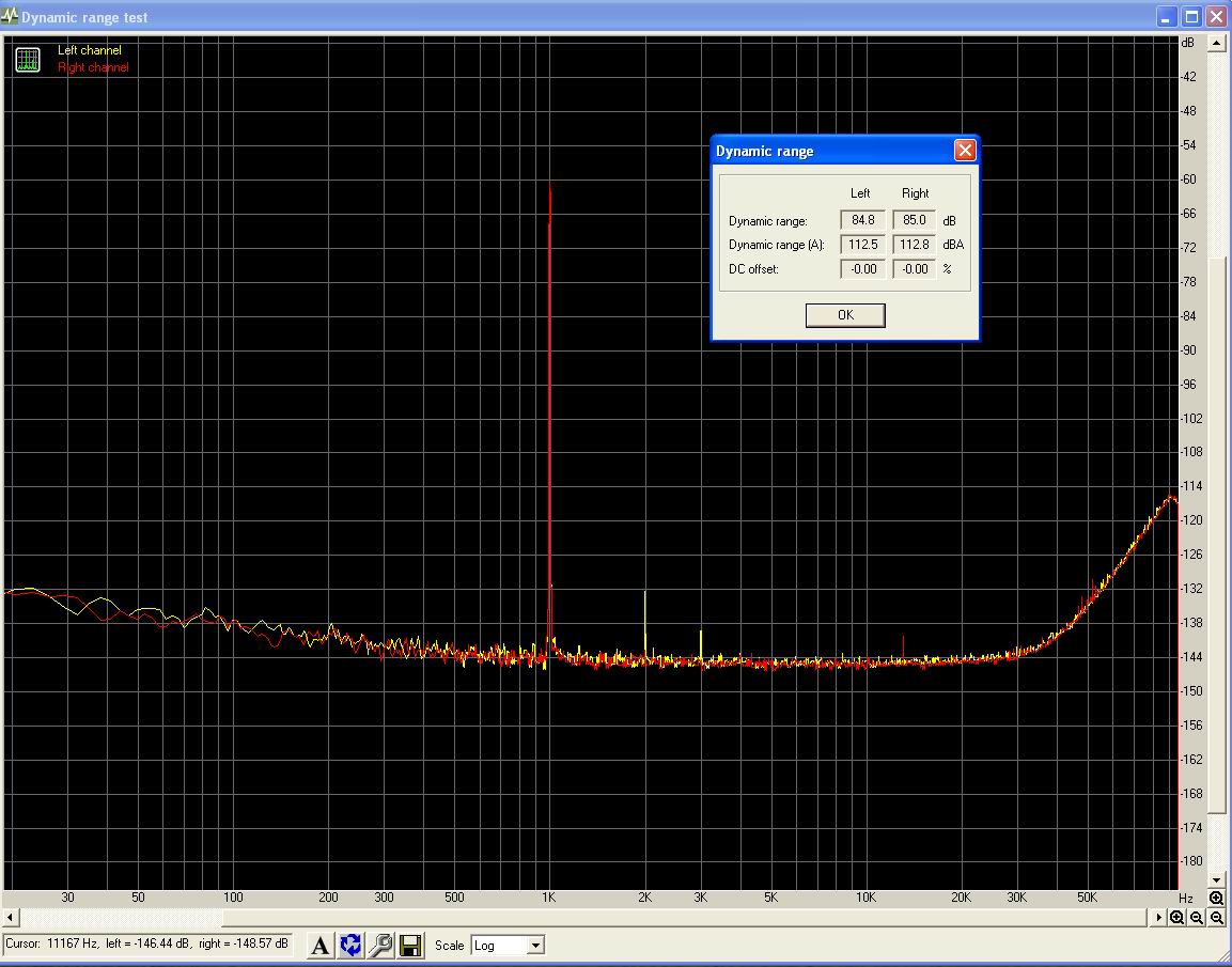

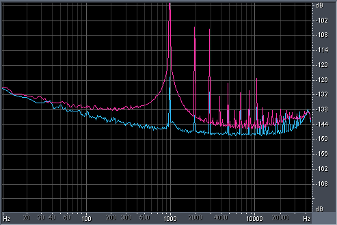

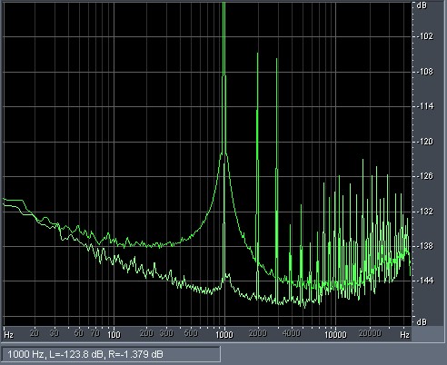

I forgot to post the results for dynamic range. Still some little gremlins bellow -132dB or so...at these levels it gets complicated, we need to consider shielding
, I think.
There is also a 12k component that appeared on the right channel, or I'm seeing it only now because everything is cleaned around. (see it in the previous posts with SNR and THD too).

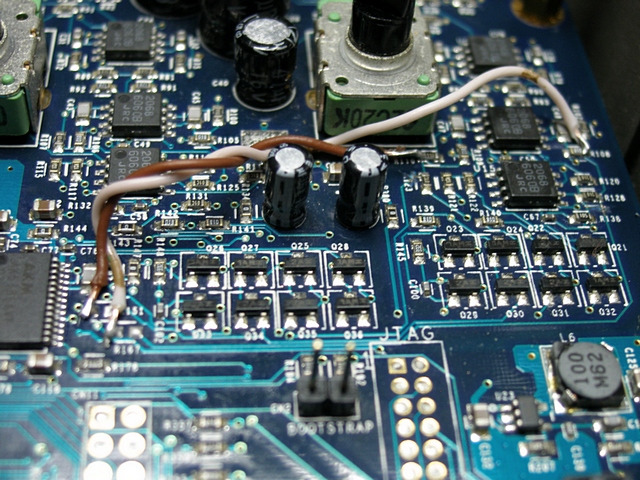

On the downside my mod degrades the crosstalk, it is now down 3-4dB at 20k (~ -84 dB absolute), because the new wiring hovers above the right channel over a length of 3/4 inch or so...I don't really mind.
But I had to inform you...

If in your mod, black wire additionally connected from R110 twisted onto wire up to R108, would this form shield/balance common mode signal for possible improvement?
R151, R167 are zero ohm jumpers. There are also two of these for the right channel (R143, R147). They include these locations as a precaution in case there was ringing on the anti-glitch capacitor or to make an attenuation pad + 1st order LPF (when combined together with the resistive part of the ADC's input impedance). Apparently they decided that there was no need for these which served my purpose well
It is also a hint that they did not spent too much time in development, making a second run of the layout after the prototyping phase.
About the wires: I twisted them to ensure mechanical stability and minimal loop area. It looks like the black wire is coiled around the yellow, that is because the yellow is stiffer. About the segment of yellow wire that runs alone...keep it short and running close to the board - there shouldn't be any problems there.

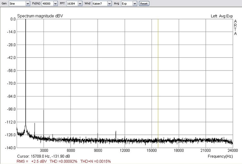

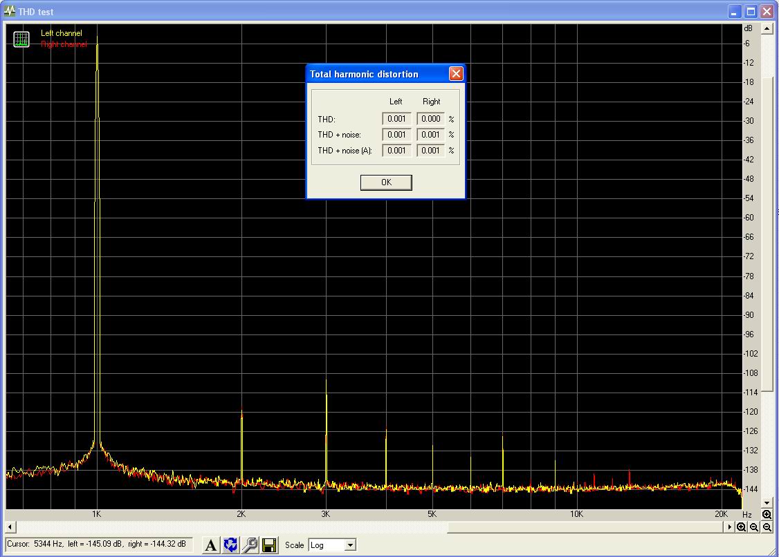

The left channel working very well. Many thanks to sidiy.
THD 0.00092%, THD+N ... 0.0015% (HeadPhone loopback, 24bit/48KHz sampling).

Good news all over, I'm glad it worked.
Earthquake? I hear all is well, our friends in BC may have some stories for us.
I'll try next some improvements on CMRR, decoupling and I may even change some of the op-amps and 'lytics. But I'll need to raise a schematic and order some parts...don't wait for me.

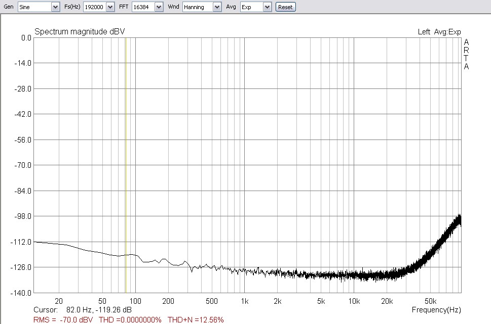

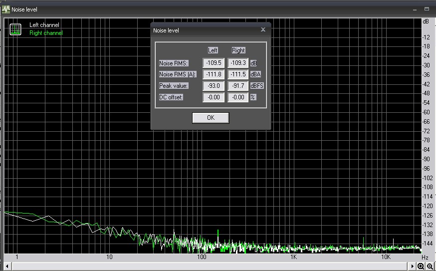

Mod results:
Open loop:
This is clear improvement over stock condition.
Left input referenced to -1dBFS with 1kHz sine by adjusting output, left output used:
Right input with cable moved from left input, same signal:
From above results, left channel remains susceptible to signal.

Open loop:
![left ch mod open loop.png left ch mod open loop.png](https://www.diyaudio.com/community/data/attachments/278/278691-15b2f1048908bf06b52e8c3675bfe098.jpg)
![1kHz left -1db0.png 1kHz left -1db0.png](https://www.diyaudio.com/community/data/attachments/278/278699-f14a6a97c7e278647a34dbe8cbe59433.jpg)
![1kHz right -0db8 with left ref.png 1kHz right -0db8 with left ref.png](https://www.diyaudio.com/community/data/attachments/278/278703-b22a73353574c19f1de2ff0bc4826c46.jpg)
