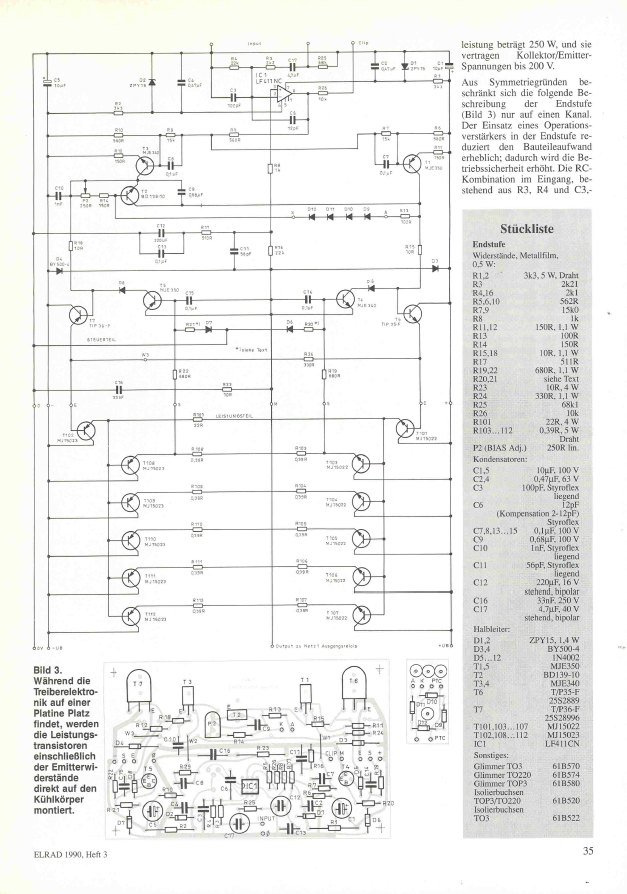

Hi all ,
I found in old german magazine - ELRAD - this ancient project , may be an semiclone of BGW1000 , it could be the project that was the basis of Elektor PA300 from the same author, Anton Riedl.
I hope not to infringe copyright, otherwise ask the moderator to censor my attachment.
Enjoy !

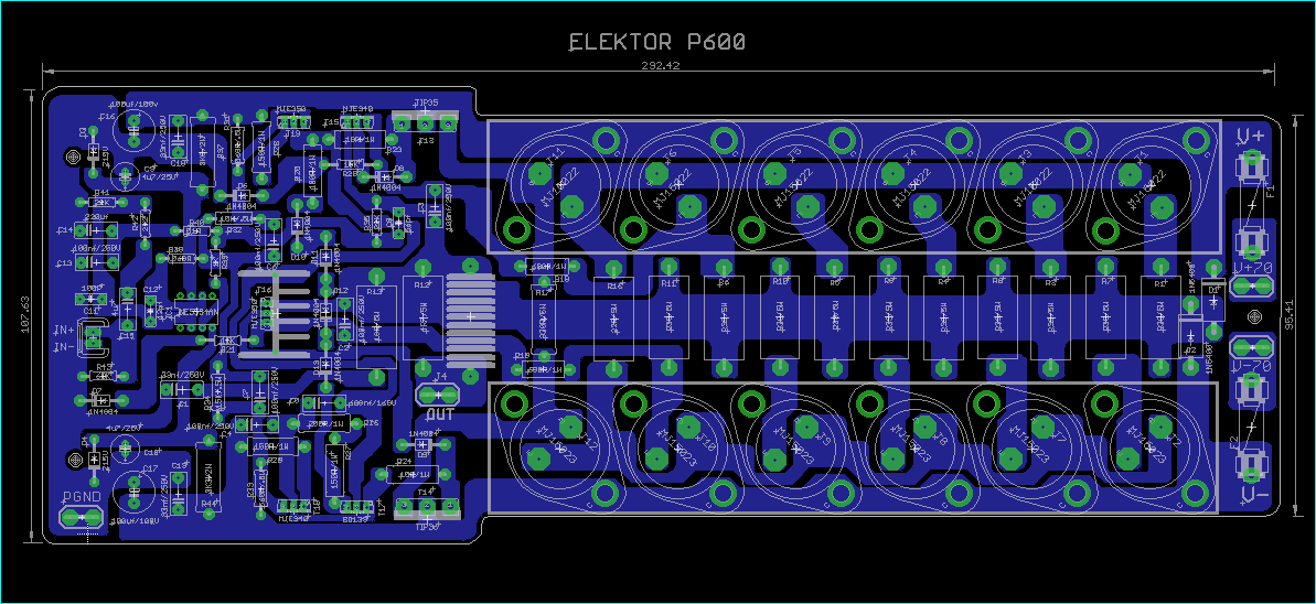

How much power can I get with +-60VDC and 2 pairs of output devices?
Can I go down to 2 ohms safely?
"How much power can I get with +-60VDC and 2 pairs of output devices?"
Maybe 150W/8Ω.
"Can I go down to 2 ohms safely? "
With four pair and good heatsinking you could.
With very good heatsinking and three pair you could drive 300W/4Ω.
Maybe 150W/8Ω.
