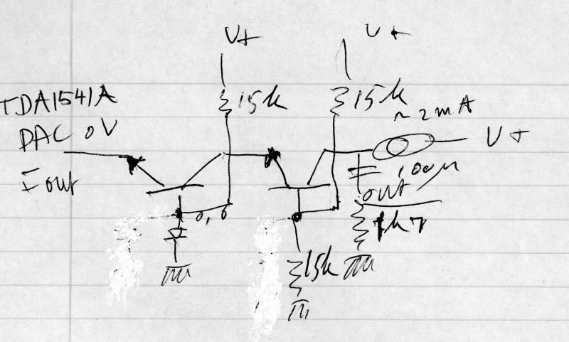

tschrama said:
I just got this idea. It is the I/V stage for my latest DAC project...(4th allready.. I'm going to be a real DIY pro one day)
I didn't measure it.. ain't got no distortion or spectrum analyser, but how do you guys feel about this one? I simulates great....
Very nice Current to Voltage amplifier, tschrama
Simple & good.
Schematic:

Anyway. I am very glad I finally tried the original circuit from this thread. The number one post from Jocko Homo.
It's very interresting because it seems every one in this thread are sitting in their armchairs and bring comments. Only very few have tried to build the original circuit? It really works great and the music dynamic is huge!
I use 270 ohm on R3 and R4. 10k pot on R4. R5 and R6 are 10k. R1 4.7k and C1 47uF. Green LED's. Transistors are BC546B and BC557B. It didn't work at all before I paralelled R3 with a pot on 1k ohm. I adjust it for least distortion (1khz test CD).The voltage on Q2 collector then settles on about 8.6 V.
It's sensitive in adjusting the CCS but after it's done I am really impressed. Less is not always better but in this case I can't find anything negative. In the pictures below you can see my handcrafted prototype beauties

BTW R1 should be to the left side of C1.
And if you use the TDA1541 you need to cancel the offset current from the DAC with a CCS like Pedja did. Just a BF245.

Wrong! Gives 20db higher distortion regarding Jockos comments. Read the thread. You mean he was wrong on that? then I'll take it back and will test it as you say.BTW R1 should be to the left side of C1.
I don't understand. You mean that this simple circuit actually is that heavily flawed?And if you use the TDA1541 you need to cancel the offset current from the DAC with a CCS like Pedja did. Just a BF245.
It seems to me that your statement indicates you havent built and/or understood the circuit. I'm very sorry, but for the moment I have a stable 0.3mV at the DAC's outputs.

1st it's is not Jocko's schematic, it's just a simplified idea he posted a while ago. Jocko's original circuit is way more complicated and I will not post it here or anywhere in respect of his IP.Hi aparatusonitus

I have built the simple circuit on a diyparadise board obtained from Yeo. Sometimes it did not work as the voltage left of cap C1 is not defined as remarked in post # 12 of this thread. It did work when I added 10k there....
The good point of these common base circuits is it does not give digital glare. The bad I already mentioned no bass slam.
Without compensating TDA1541 current you have extra current into the IV, you can compensate for that with a JFET constant current source, or make the whole thing even single ended as in my picture.

Did this ever work for ANYONE?!!!!
I tried to build this I/V over 10 years ago, and never got it to work, even after three build attempts.
There is a long discussion over on diyhifi.org detailing my various attempts. Seems other had issues, too.
I did get Rudolf B's similar (but simpler) I/V to work.
Anyone have success with Jocko's original ckt (per as per the OP schematic)?

You may need to tweak the current slightly of either CCS to get the collector of Q2 to a decent voltage. And also R4 to get the emitter of Q2 at exactly 0.0 V. (You guys need something left to try by yourselves.....I'm not going to do it all for you.) [joke]

QSerra gave a hint in #185 ..... saying that the common collectors of Q2and Q4 needed a dc path to a defined potential (a supply lin, gnd, etc).
As both collectors are high impedance it his highly improbable that a certain stable idle potential develops, but rather that the voltage is driven 'into' one of the collectors .... to a,most 0V or V+.
One could either omit with the current source Q4 and just use a load resistor connected from Q2s collector to V+, or use a current mirror mirrors into a gnd (or V-) referenced load resistor.
