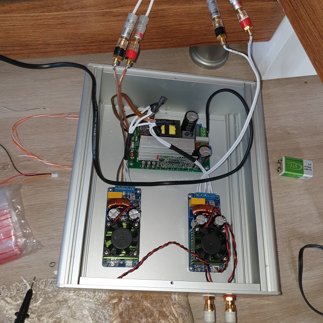

Hi.I connected and played them.They play very good when played seperately but when connected together in stereo there is too much fan motor sound and much noise from one channel.Could anyone tell reason?Thanks
I've been spending half a year struggling with getting rid of power supply ripple noise in my car. You have a couple of things to try. Do the easiest thing first: lift ground from the RCA inputs, i.e. disconnect the black. Try this at both ends of the line audio cable.
Others things to try is to isolate the power supply with a isolation transformer (expensive). Or put a ground loop isolator ($5 ea.) in each channel.
