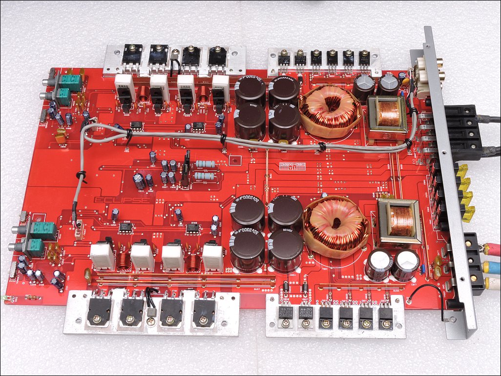

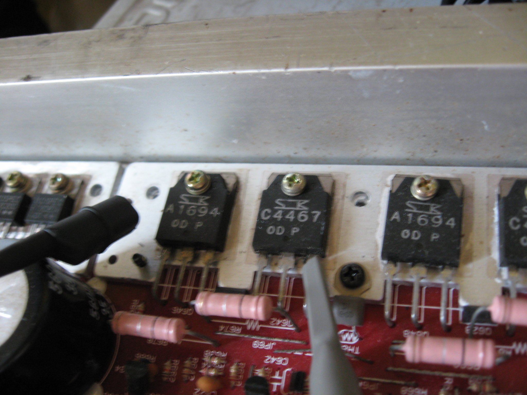

Hey all Im working on an eclipse amp and having trouble finding the problem. Powers on, no sound. Verified DC voltage on output @ 42v with variations in the wave form, not sure if thats normal as Im still learning and I know the O-scope is cheap garbage. I checked the NPN and PNP both are good but needed to be soldered back in the board for some reason they were both lose. I don't see anything visibly burned.

Yea this has me stumped. I can see signal on the outputs of all 4 speaker terminals while playing tones or music showing at 30v but when adding a speaker to it I get nothing. I checked the input signal its good and the speaker being used is good. The npn/pnp get warm nothing else does, fets are cold like everything else..

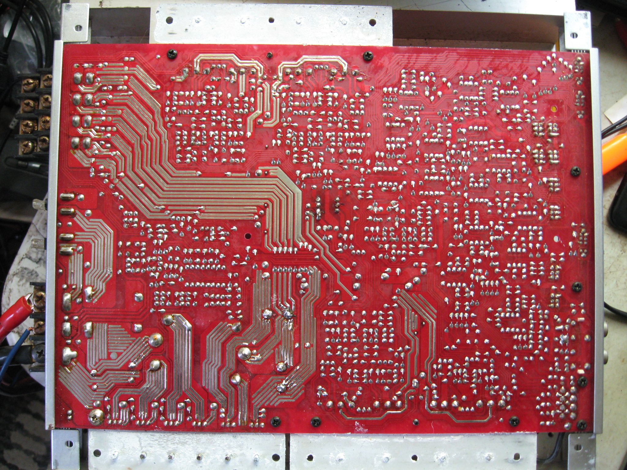

Yep, I did this and traced back to some NEC K3057 which appear to working with 80v on the left and middle legs and 68v on the 3rd leg. I didn 't see any melted traces.

The 2SK3057s are the PS FETs. You should't read 80v on any terminal. The expected readings are about 6v, 14v and 0v reading with a multimeter on DCV.
