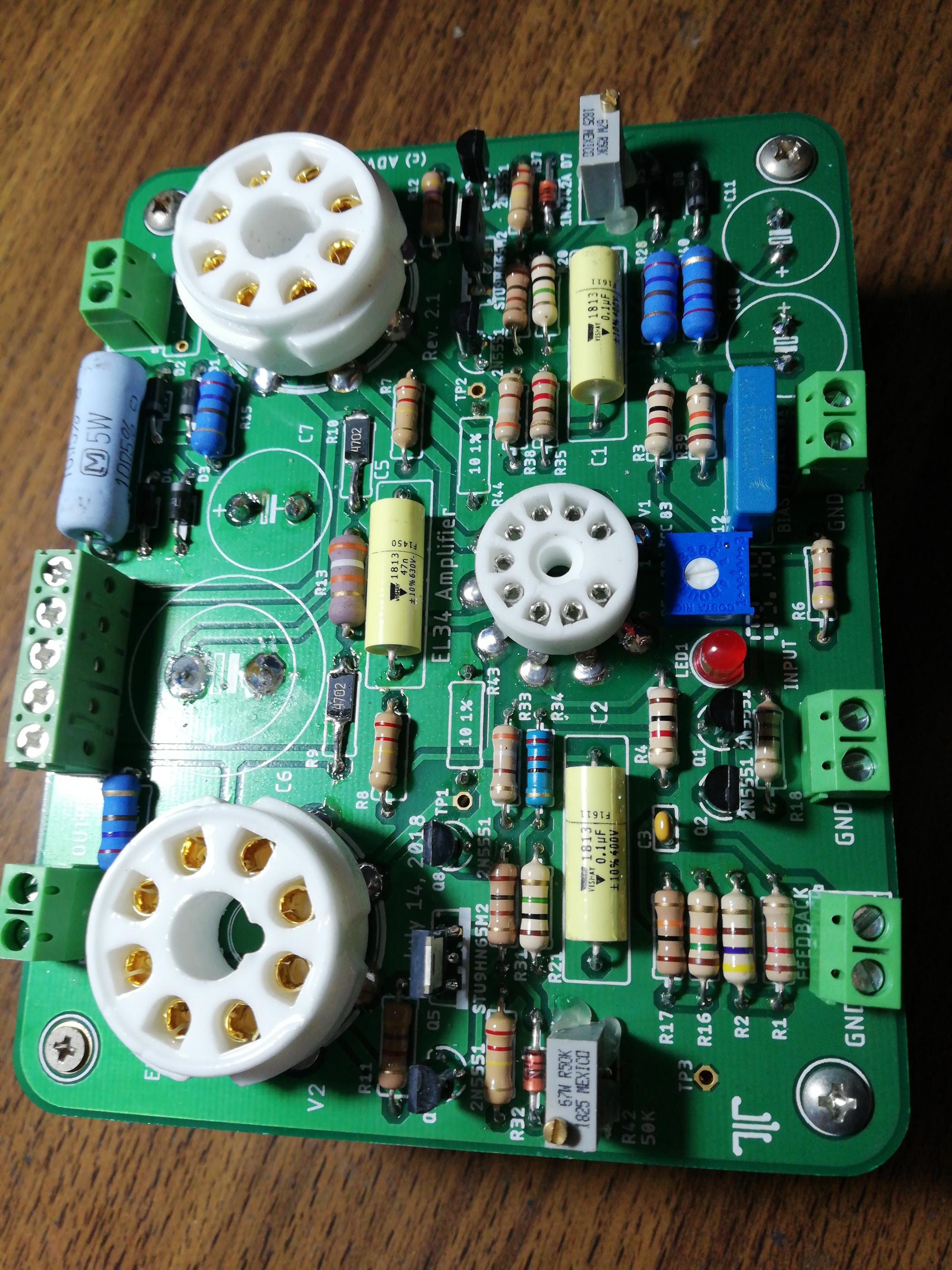

I am ready to power up. What is the function of feedback pins next to the input? What's connected there?

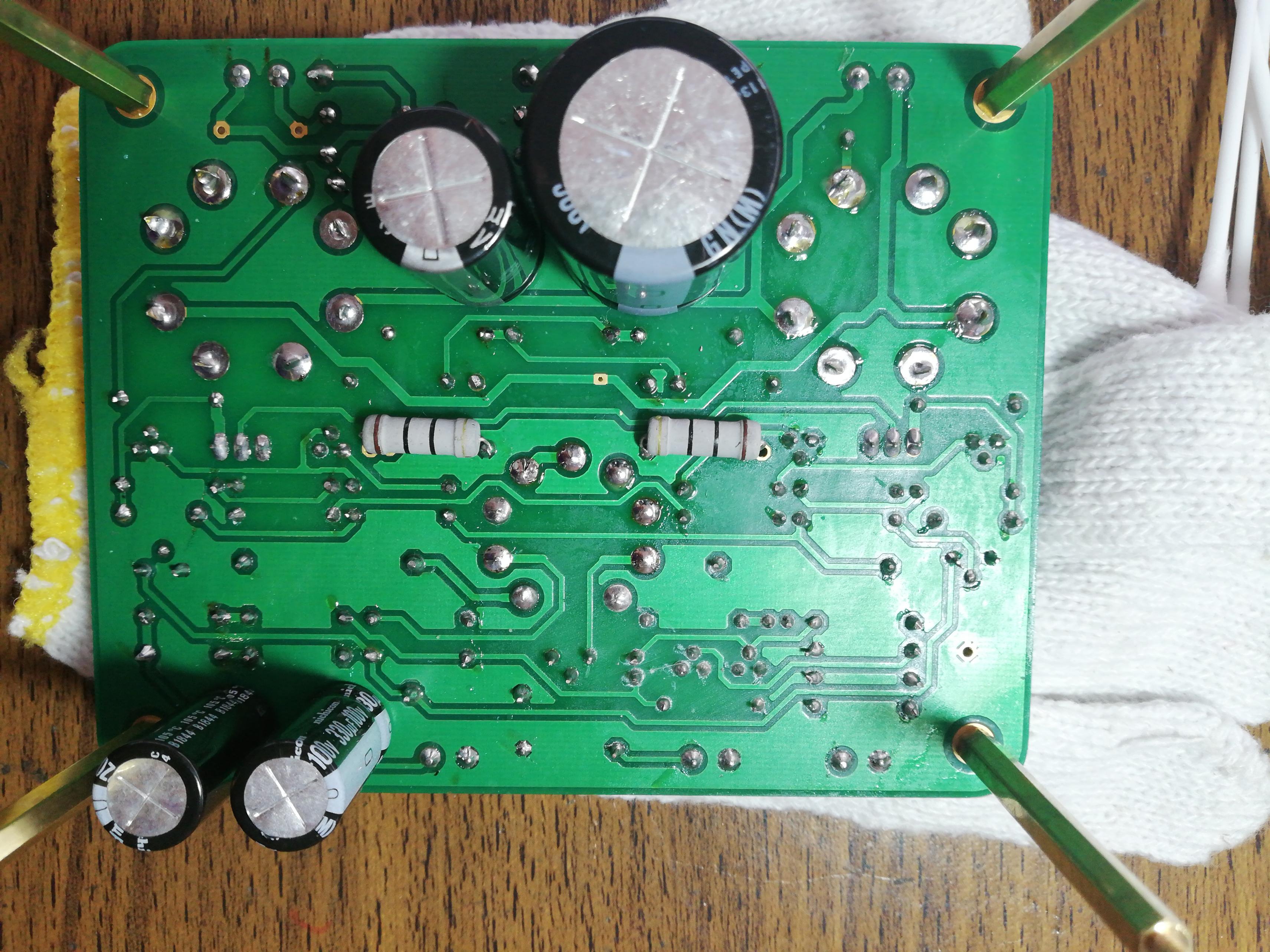

Your board looks nice. Can you post a pic of the other side?
Feedback connectors: See post 86.
You do some clean work. Thank you for posting your photos
Thank youCarl,
Post 342...
Marc

Hi kp93300,
Nice work. What is the purpose of having the 10 Ohm 1 w resistors under the board, rather than on top where the heat could escape better? I was thinking of putting all my resistors on top and the film and ‘lytic caps under.
